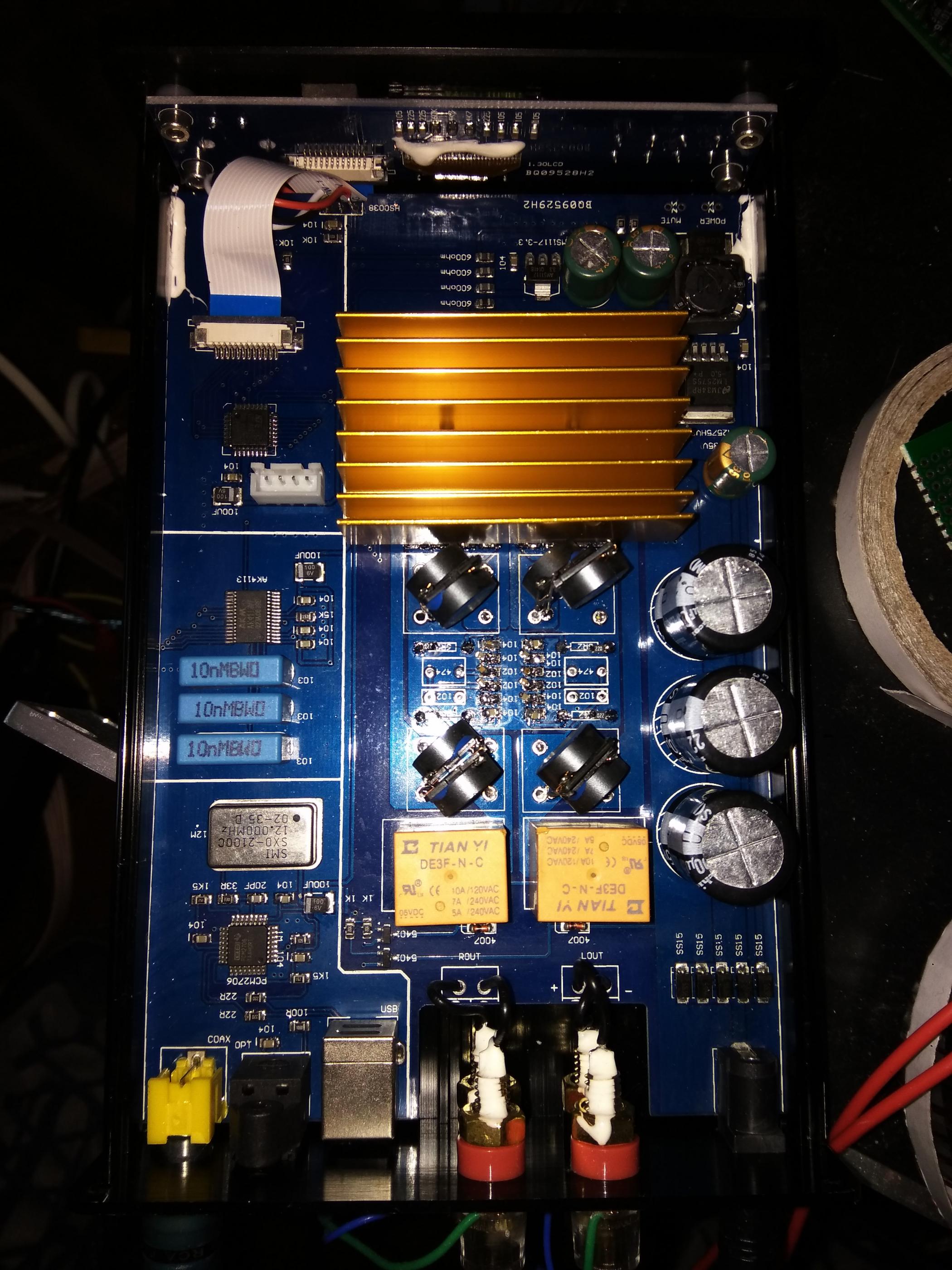

I've modded my first STA326 enough to listen to now - replaced the 22uH inductors with pairs of 150uH to increase the working impedance (and hence reduce the output current). 2:1 step down toroidal transformers on the outputs. Sounding very promising even before I do the next round of mods to install a local PSU regulator.

Been there - tried the STA333BW boards (which have less power due to their lower max voltage) and found they still needed an output transformer to deliver the sonic goods. Which reduced the output power too far. Hence why I'm now working with chips that go well above 20V operation.
<edit> Internal pic attached.

I don't get it. Why use a high efficient class d amplifier,and then reduce the output power. Does the STA326 so much better than a LM3886 or similar type of class AB chip?
If I was aiming for maximum efficiency then it would be silly, I agree. But I'm not, I'm aiming for maximum satisfaction in the sound.
Its not an apples-apples comparison. But assuming we took a fairly decent multibit DAC like an optimized TDA1387 design and fed that to an LM3886, yes the STA326 easily beats that. primarily in HF purity. Secondarily, in bass slam.
