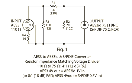

The amp has a coaxial (RCA) input...All my stuff is XLR. I have a USB interface (I think that is what you call it) that has XLR output. So I think this is called AES/EBU. So how would I connect my XLR to the RCA. Is there a converter I can put in the box and replace the RCA with an XLR. I want to re-box the amp as it does not fit with all my 19" rack stuff....
Please can someone help??
You're right that the XLR connector carries an AES/EBU signal. This is a balanced signal and normally higher amplitude than the S/PDIF. Its also at a higher impedance (110ohms versus 75ohm). You'll need a resistive attenuator network at the amp end, I'll look into the details and post up about it later. Do you know if your USB-XLR box has a transformer inside?

Scroll down to fig 1 for a circuit Interfacing AES3 and S/PDIF

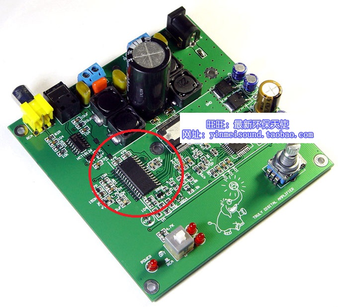

Have they set any tone controls in that amp? Without a screen or remote, I wonder how/if it's possible to change eq, bass, etc.
Also have you taken the heatsink off ever? I'm curious to know what receiver chip they used? I've circled it in the pic attached - thanks and no worries if you don't want to check. That size looks like a CS84xx which aren't good - 200ps of jitter.

Can I just replace the RCA with a XLR and hard wire it to where the RCA went?? Or is this too simple?

I have the JHiFi not as your picture. No I have not taken the heat sink off.
As the levels and impedances aren't a match, its a bit too simple. Here's the schematic I suggest you use from the Rane page nano linked to. Use the resistor values which aren't in brackets.
