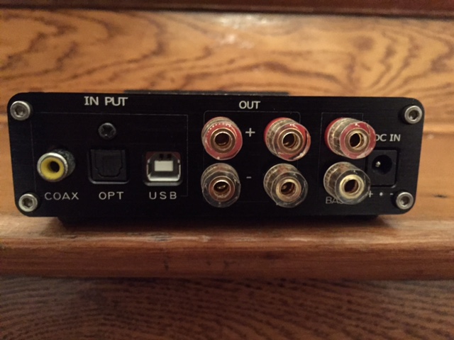

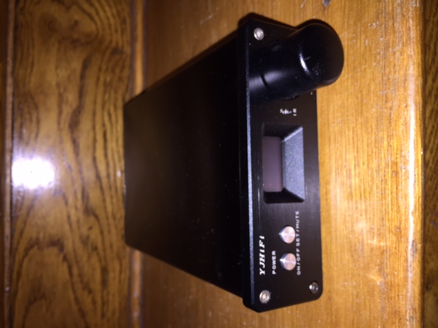

This one is very similar to mine (please see pictures) : the only difference is that I have a direct bass output with a variable frequency split.
Using my Magical Box and a modified balanced headphone, of course, it is very close to the FX-802, but the V200 sounds a bit better than both 326, of course IMHO, as reported in my post.
I have one of those too, haven't opened it up yet. From the internal pics of that on Taobao and Aliexpress, I couldn't see an additional pair of inductors for the bass output - this puzzles me.

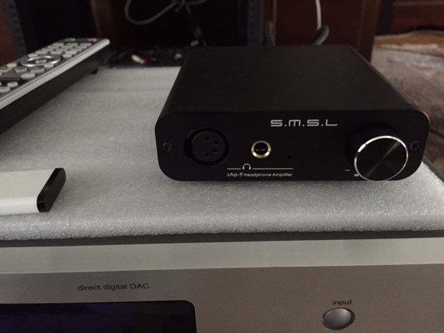

I bought recently the SMSL SAP-9 which allows balanced connections too and the comparison remains in the favour of the PowerDACs/FDAs connected directly through the pad.

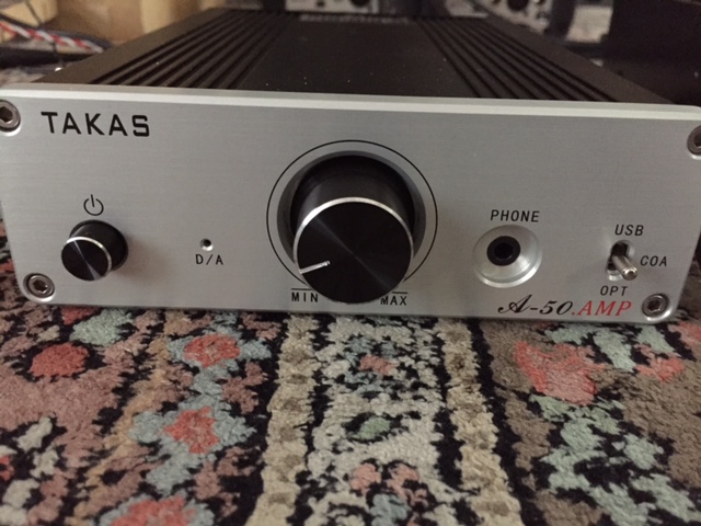

I received the TAKAS 50 (https://www.aliexpress.com/store/pr...-USB-Coaxial-Optical/1269413_32562907821.html)
This unit uses the TDA7498E (http://www.st.com/content/ccc/resou...df/jcr:content/translations/en.DM00044235.pdf)
It plays very loud and is in the same league as the V200 more or less. It becomes difficult to make a clear distinction, because these devices are very close from the audio quality point of view. This last unit will be a very good deal for people with low sensitivity loudspeakers, for sure !

The amplifiers you mention are not FDA. They have a DAC and analog volume control. Maybe it is better to focus on FDA with STA326 (or variants) in this thread as the thread title is "Full digital amplifier with chip STA326". Diyaudio.com wishes not to make a separate subforum for FDA and therefore it is classed in "Class D" which makes it hard enough to focus on FDA subjects. There are several threads on class D amps where those can be discussed. This to avoid mist/noise as in other threads.
Sorry Jean-Paul, but the FX-802C and the YJHiFi both use the STA326. I admit that the V200 and the Takas A50 are using different chips and, of course, I just mentioned them because I had them in test. Anyway, I'll no more make reference to them from now.
What crossover frequency available to choose from for subwoofer?
