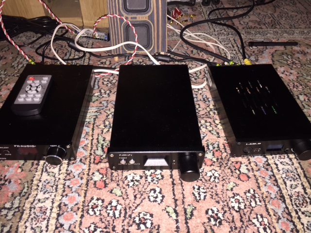

I tested 3 different units of DDX or DACAmps or whatever the name of these PCM to PWM converters through their coaxial input, the I.AM.D V200, the FX-D802 and the YJHiFi.
The FX-D802 and the YJHiFi use the same chip, the STA326, but the second has a separate sub output, with a free cut-off frequency. The sound is quite the same, but obviously you'll largely improve the audio result using an additional sub-woofer ! Since the YJH is sold without any PS, and is sold much cheaper han the FX, I used the PS of the FX without any issue.
The V200 is more powerful than the 2 others and uses a TI chip. I found the audio quality is somewhat improved with this device, despite some sibilances from time to time depending on the recordings !... The soundstage, the ambient of the recording place, the realism and some very fine details of the music and vocals are improved.
Anyway, both chips remain very good compared with several high-end "classical" DACs !

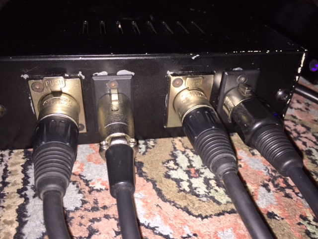

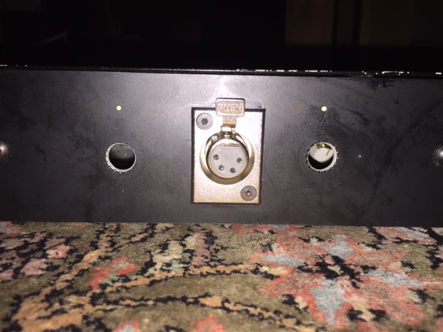

In order to compare the different FDAs-DACAmps or whatever their name, I built a "Magical Box" which is in fact a pad. The purpose was to listen to the outputs of these units directly through a pair of Headphones or IEMs.
A listening through a calibrated professional system with active monitors is paramount to make these comparisons, thus the use of a pad is also a good option.
I used several headphones and a Genelec system (with a pair of 1032A and 1094A subs) for these tests.
Most of the FDAs need an 8 ohm load : a 8.2 ohms and a 0.5 ohm on each channel are a good combination. Moreover, the use of any headphone even several in parallel is perfectly possible ! And the simultaneous usage of the active monitors system is also allowed...
After these tests, the first discover is the perfect silence when there isn't any modulation ! This is the case for all the tested units. The second observation is the very good conversion from digital world to analog, even when compared with very good DACs. Anyway, the V200 seems to be the best of my three units (the two others are the FX-802 and the YJHiFi).
I'll test other units as soon as I find a new one...
Stay tuned !
