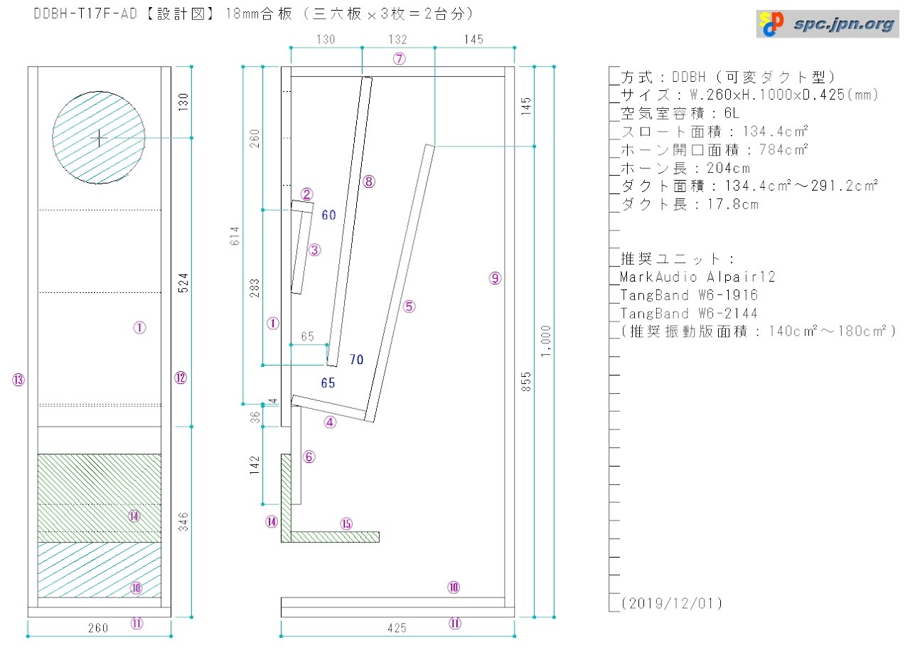

DDBH-T17F-AD
39.37in x 10.2in x 16.7in (1000x260x425mm) HxWxD

Victor is ~ 20" higher than DDBH-T17F-AD but if I'm not mistaken only issue could be that it should be ~ 10' from listening position for the double mouth back horn to come into focus therefore I would guess DDBH-T17-AD should work better in a smaller room
... can't help wonder how 166EsR would do in JOAN horn which I suspect is closer to the Austin A166 horn some have used with 166EsR

I’m new to this speakerdesign. But isn't this a transmissionline and not a horn?
Also . The curved sides. Are they purely for esthetic reasons or are they functional?

It's a horn. And curved sides are funcional, because form horn mouth. Very clever design.

It acts as a transmission line for the lowest frequency range. And as a horn a bit higher up.
A very clever design, and very well packaged

He developed the curved shape to virtually increase the size of the mouth.

In the broadest sense of the way TL is being used these days (as quarter-wave = TL) a horn is a TL, but The Frugel-Horn is a horn in the stricter sense, and uses a lot of the tricks of the Pioneers.
The case with all small horns. Scott (@Scottmoose) would have to step in to tell us how much.
The purpose of the curved shape is to make a high aspect ratio rectangular mouth look more like a circle.

good one.The purpose of the curved shape is to make a high aspect ratio rectangular mouth look more like a circle

Thanks Dave, just to understand better: the curved shape makes the mouth look like a cirche with the diameter equal to the height of the speaker?The purpose of the curved shape is to make a high aspect ratio rectangular mouth look more like a circle.
Or with a circumference equal to the circumference of the rectangulus (front/back view of the speaker)?
Has the procedure to obtain the radius of the curve ever explained?
Hello ,This box would be a good choice for 166ES-R.
Low frequency is adjusted by variable ducting.

Frugel-Horn XL or DDVP-15 or SDDBH-T13.5R-AD.
Frugel-Horn XL and DDVP-15 are about equal in low frequency.
SDDBH-T13.5R-AD extends to 30Hz, but is not as tight.
