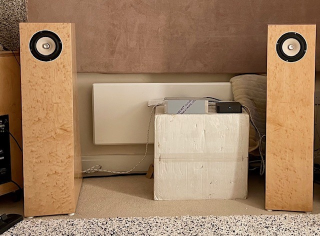

I'm running the TangBand W5-2143 driver in the FHXL. Had to 3d print a little adapter so it would fit into the cutouts for the MA Alpair 10.3.
The TB driver with its pole plug produces some surprising spatial effects at times and - as with the Alpair 10.3 - isn't good for all kinds of music. Bit more punch, but still within the limits of a small driver.
Currently prefer it to the MA 10.3, but that might change in the future.
Desperate to also try the Fostex FE168NS, but these drivers are quite expensive "just for trying".
Current amplifier in use: Hypex NC122MP module from aliexpress (under GBP 200 with cheap alu enclosure)

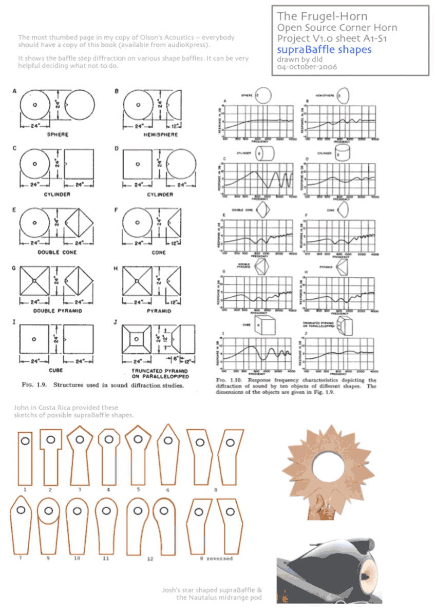

Wings i don’t know, that is ort of hat the wall or corner behind.
If you want to enhance a FH (on the outside), perhaps a supraBafflr to push the BS-3, and improve the smoothness of the 2∏ to 4∏ transition.
This is a page from the FH1 document, a bunch of potential shapes (most from the used base) but likely best would be omething that looks like the midPod in the B&W 801
