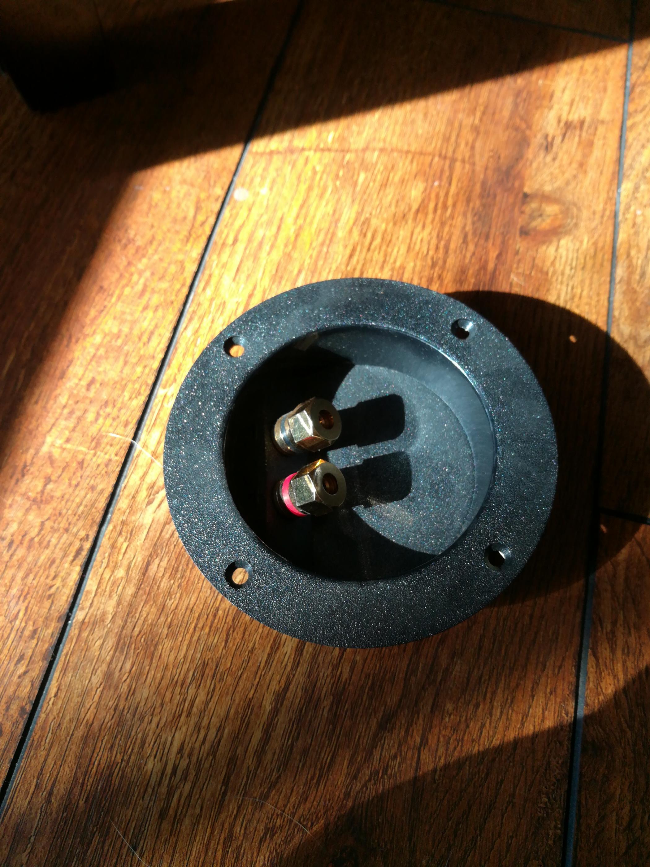

terminal cup
Got all the panels cut out of 3/4BB ply, now I'm cutting the opening for the driver. Was about to cut a hole in the back panel for a terminal cup, but looking at how thin the plastic is, I'm afraid this will affect the rear chamber area.
Any advice, or experiences with this?
Ted
I don’t think Dave meant that the enclosure needs to be a sealed type, just that the mounting of the terminal cup is air-tight. Most of them come with quite sufficient closed cell foam baskets for that purpose.
