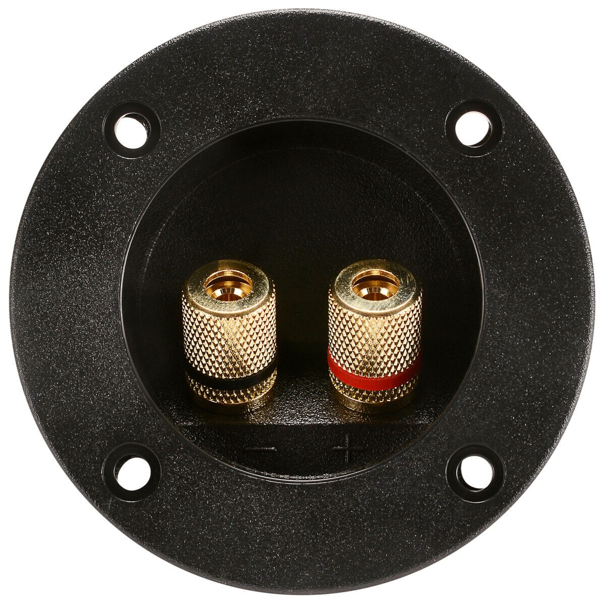

Why don't you like the metal posts? Just preference?
FWIW, I will actually be swapping amps/cable a lot, moving things around, so I do want something easy to live with, and if I break something, allow me to replace.
Honestly, if I am happy to just keep it basic with something like these, should I stop worrying and just got moving on the build 😉
Too much metal. The cheaper plastic ones sound better. Subtle but there.

Or maybe if I make it even more simple...is what's pictured here the default (if I order from Bob)...and should I just use those and not make a big deal out of it! I think that is your preferred style. Obviously I will verify with Bob as he is selling the kit.
Those look like the budget PE ones, yes, i would just stay there. Because they are removable, you can play later.

I unscrewed the metal outer part of one of the binding posts - it measured 4 gms on a precision weighing scale. The inner part looks slightly thinner vs the ones with the plastic red and black bits, but it might be an optical illusion. All in all, the amount of metal is very less in both binding posts / terminals.
It is fairly certain that there will be no audible difference unless there is a bad contact somewhere. Close to 10 years back, in one of my speakers I had a piece of internal hookup wire that did not have a really tight contact with the binding post, and that speaker sounded slightly less loud vs the other one. Once I had it tightened, no difference.
I understand that you prefer less metal in the path, but after a point we need to understand that there will not be any differences. The WBT posts you shared earlier - those look like they have much more metal in them.
canonken,
Don't sweat it - the ones I see in the pic of Bob's FH3 kit (rectangular terminal cup) work fine. I have used them in multiple projects. You can unscrew them and change the wires inside if you want to. Both these and the round terminals have similar tabs on which you can solder the wire on; you can use FASTON connectors too.

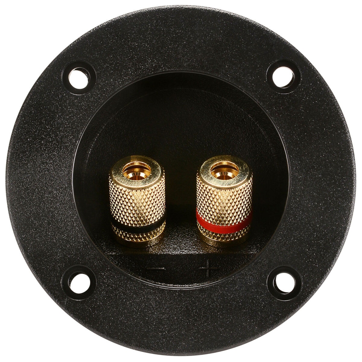

I can't comment on the magnetic side, but if you have steel in the signal path, you've got a significantly more resistive component than the majority of brass grades. A small amount given the quantities involved to be sure, but in HE systems, connection losses (most are rubbish -give me properly screwed down lug connection any day) can be an issue. No doubt that's why we've seen a proliferation of copper posts, although given how soft it is, it's probably not ideal if you're likely to be regularly moving components around.
