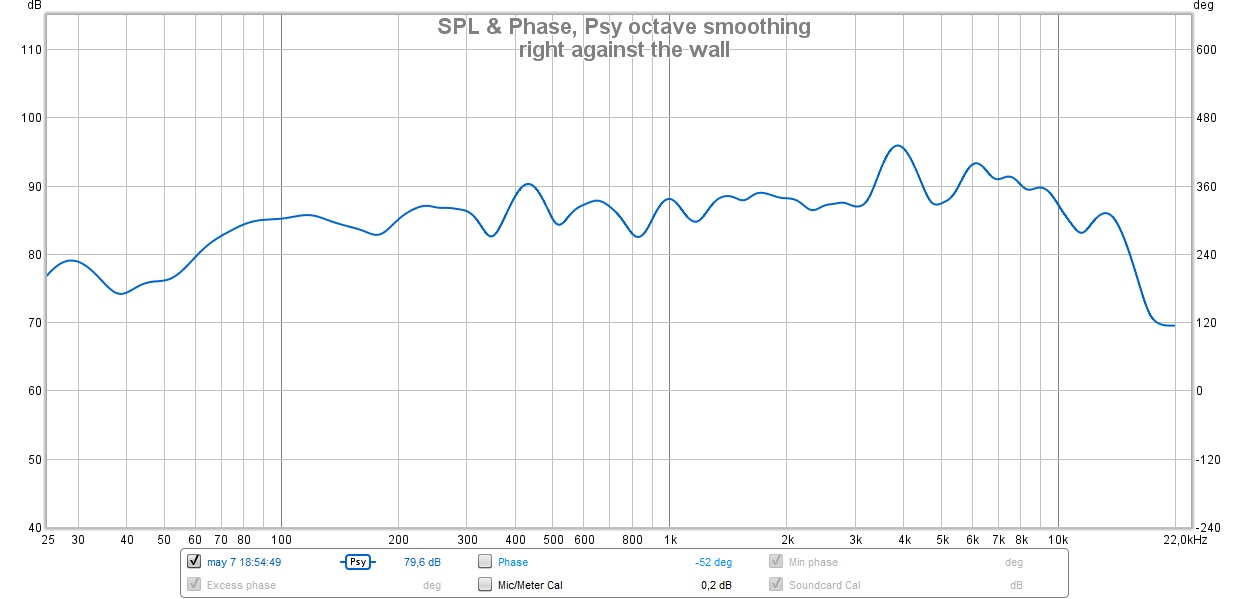

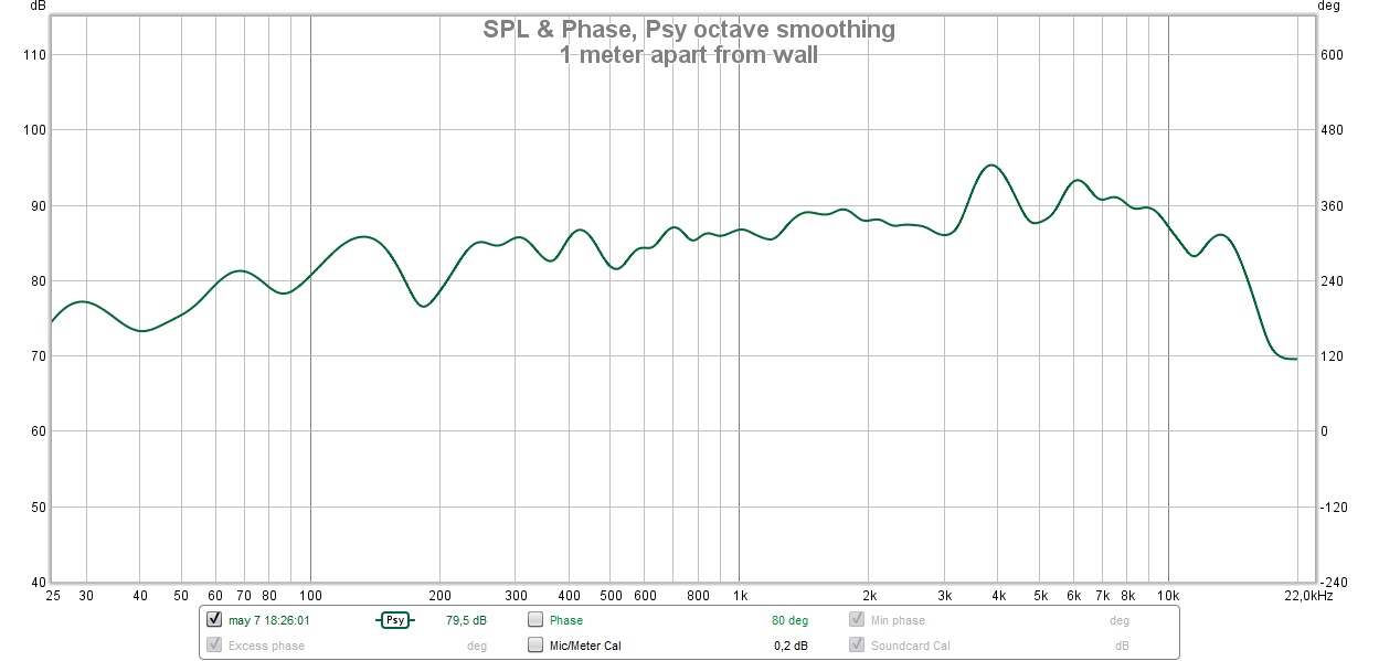

FH Lite are really amazing speakers, BIG sound from a diminutive box. Tomorrow I'll measure mine and post graphics (there was an old post but pictures has gone)

Pictures are always welcome! If you can attach them to the forum rather than link, they'll never go away.

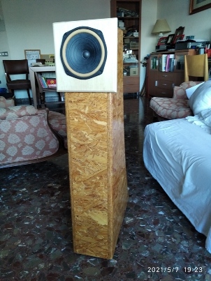

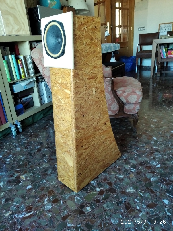

Diatone PM610 clone (Diaclone) in FH3
This Diaclone is a 6,5" speaker with steel basket, big ferrite magnet, whizzerless paper cone and good sensitivity. There are several types, I have the cheapest, the one which looks closest to original Diatone. Around 100€, post included. This:
2 unidad davidlouis Audio 6.5 pulgadas DIATONE P610MK3 version 2019 | eBay
I know this speaker is too big for FH3, but try it anyway because I have no room for a FHXL. I like the sound, good treble (not agressive) detailed and enough bass.
It's amazing that a loudspeaker so different from the original can sound reasonably good. FH3 is a great design.
I think it can be mounted without suprabaffle if 19mm board is used (not tested).
