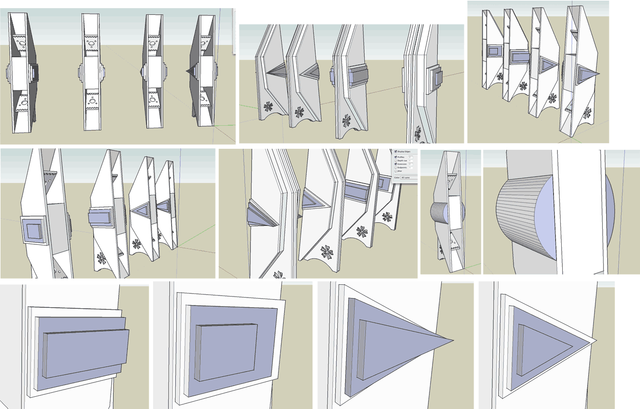

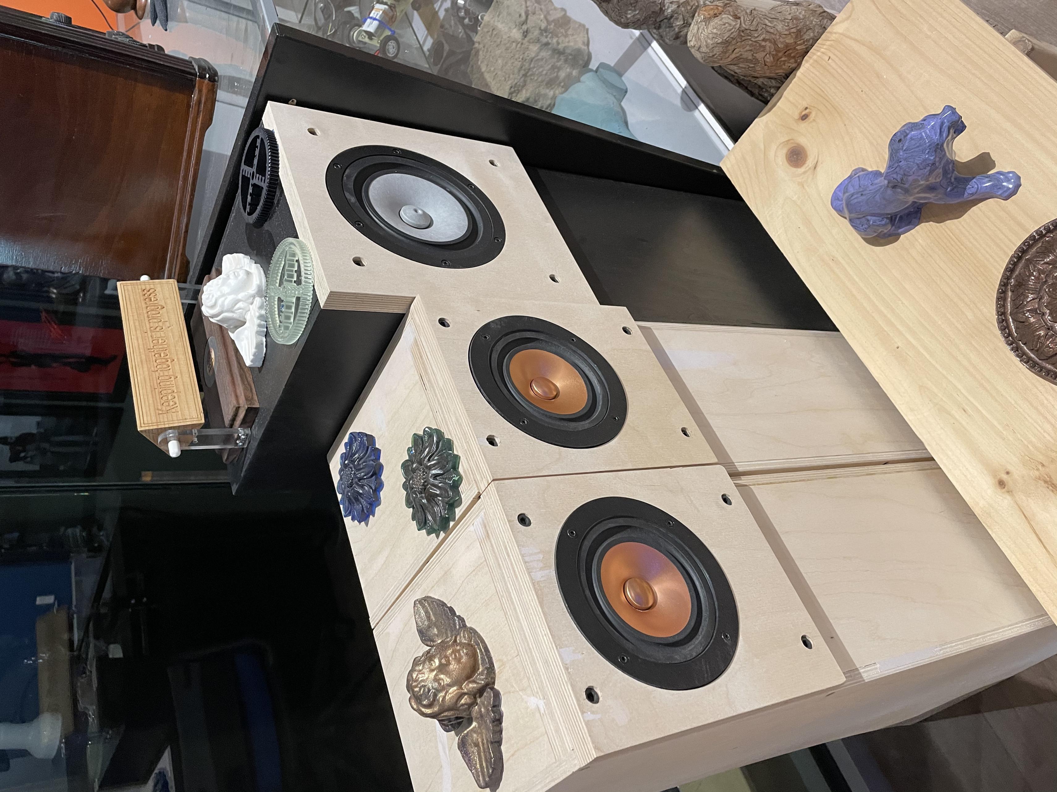

Hi Ken, I will not argue with the experts here. but I can provide photos of my prototypes with the supra baffle that I make. I believe the best reason to get the SB is to allow for swapping out drivers easily and quickly. And as a "custom or boutique" builder I can really make just about anything you want. Here are photos of my FH3 and FHXl with supra baffles.
The supraBaffle is an option to allow easy change of drivers.
Few have been implemented, and we in th eend settles in somethign simple a son these FH-Lite.
If you don’t like the stepped baffle you can make the supraBaffle cover the entire baffle.
The suraBaffle idea finds its populaization with the Cain & Cain horns and was to provide a more consistent wave launch. This idea evolved into shapes more minicing the B&W Nautalus midrange pods for minimum edge diffraction and at one point many shapes were tossed out.

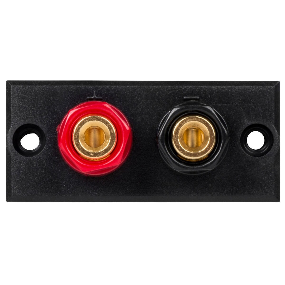

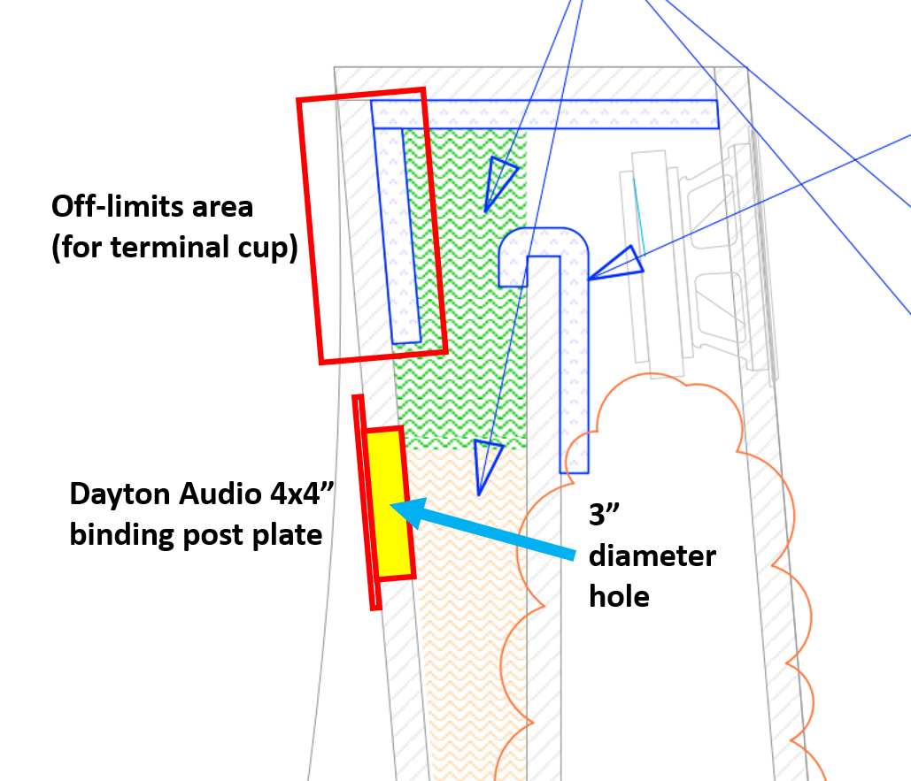

This would be the only 'custom' thing I would want to do vs. a standard plastic input terminal. Any concerns? 4x4" plate, 3" diameter hole. Foam gasket to seal it. I think the only wildcard is how low to mount it as not interfere with the internal dampening material.
Dayton Audio SBPP-BK Binding Post Plate Black Anodized
That works fine. I’d ask to make sure they are standard 3 / 4” spacing.
You want the hole to be as small as possible (we had to work really hard to find a small diameter cup we liked, 2” hole), which means they would have to be rear mounted which makes them practically not removable after assembly. Something i do not recommend. At some point you will want to play with or have to change the wiring.

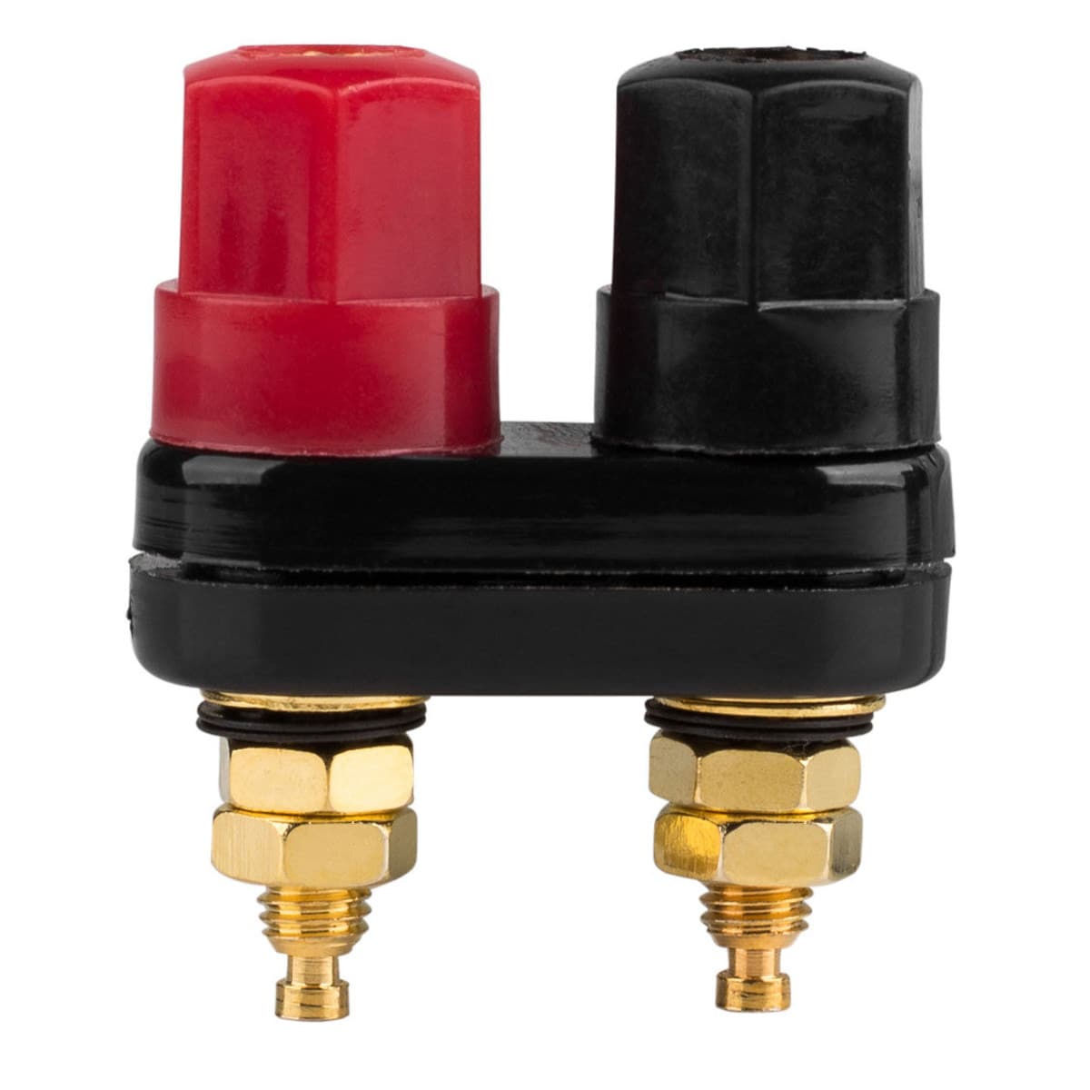

The posts that tuen up as suggested are not any i would use. Looking thru what they have:
Probably the best ones: https://www.parts-express.com/Gold-Dual-Binding-Post-091-335
These are good too. I know they look cheesy, but they sound good. The posts could be removed and put onto the bling plate, but given that placement on the FH3 is naturally protected (being inside the horn mouth), i’d just use them as is. If you want to get fancy you could do a rebate and flush mount the bezel. These only require 2 holes large enuff to accomodate the wire and terminal (since we use 24g the terminal dominates), and wit \h 2 screws into the supporting panels an be removed from outside when you need to rewire. Parts Express Gold Binding Post Banana Jack 5-Way Speaker Terminal

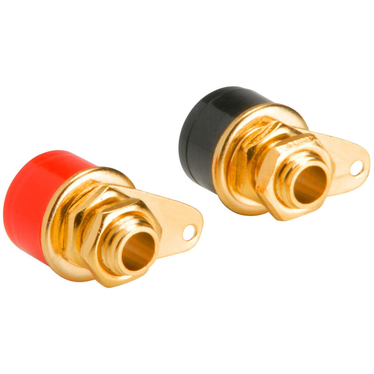

I've used the cheap red/black post many times. In my last FH3 I wanted to try something better (foolproof too) and used this Monacor:
Really good and easy to use, gold or nickel. Dayton has them too.
