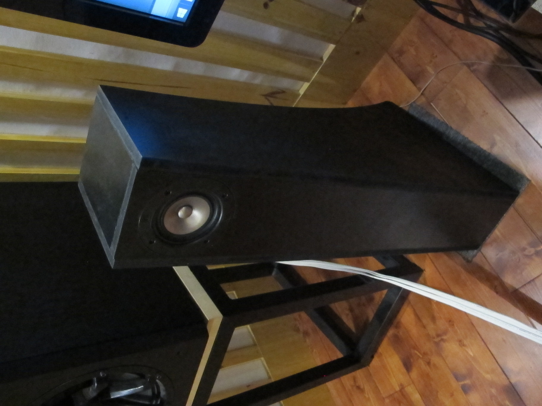

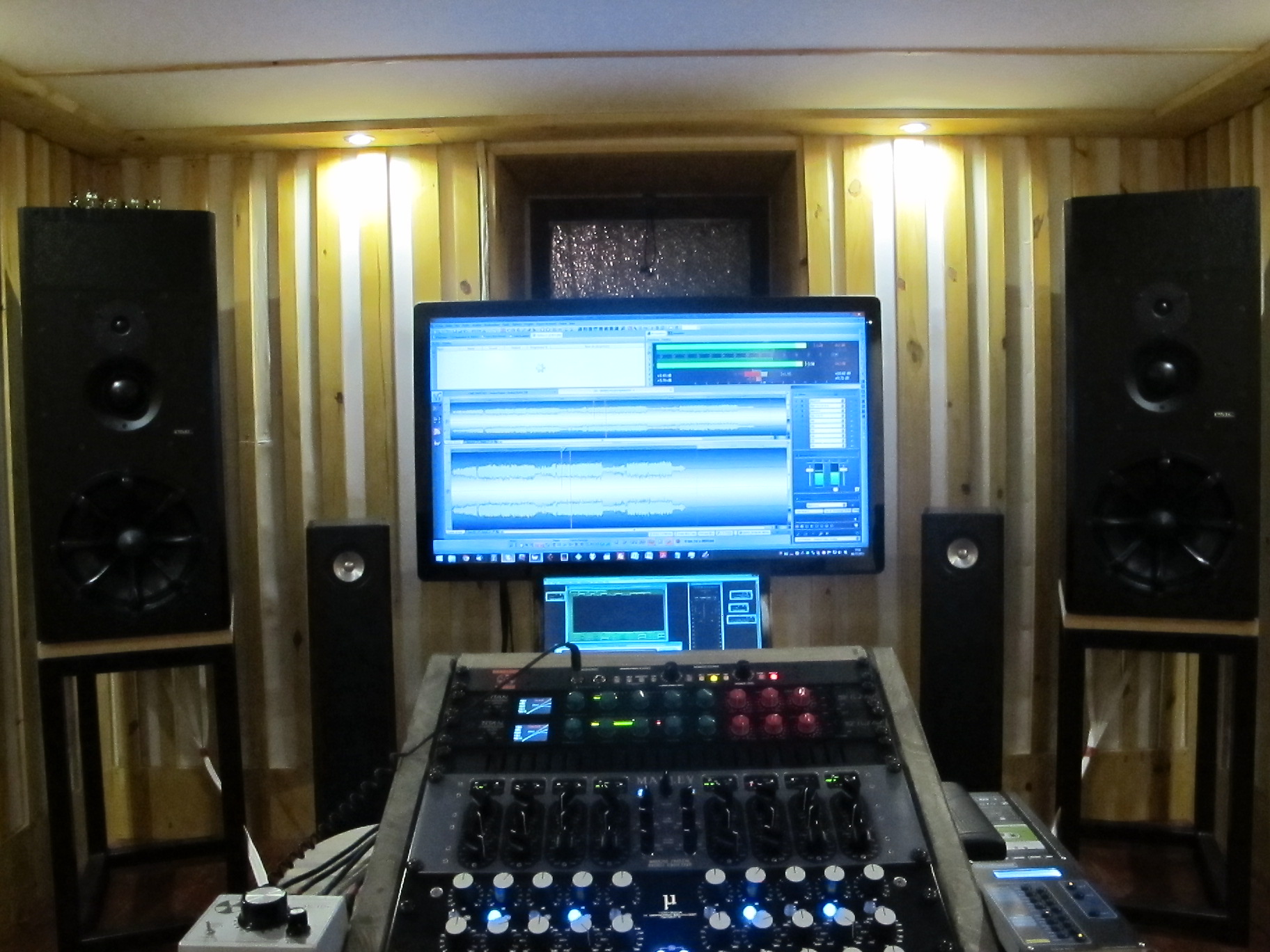

Hello guys,
At first I needed some auratone mixcubes like boxes, to have a small reference, mid oriented, for my mastering studio.
And searching with full rangers, I found the Frugel Horn mk3. I was seduced by the concept of more heavier lows with horn loading. So I bought my flatpack and a pair of alpairs 7.3 !
I did put for the moment only 20g below the driver, will see with break in finished.
For the moment, it's a little low mid/bass heavy, but i'm only at ~20 hours of not at all loud listening.

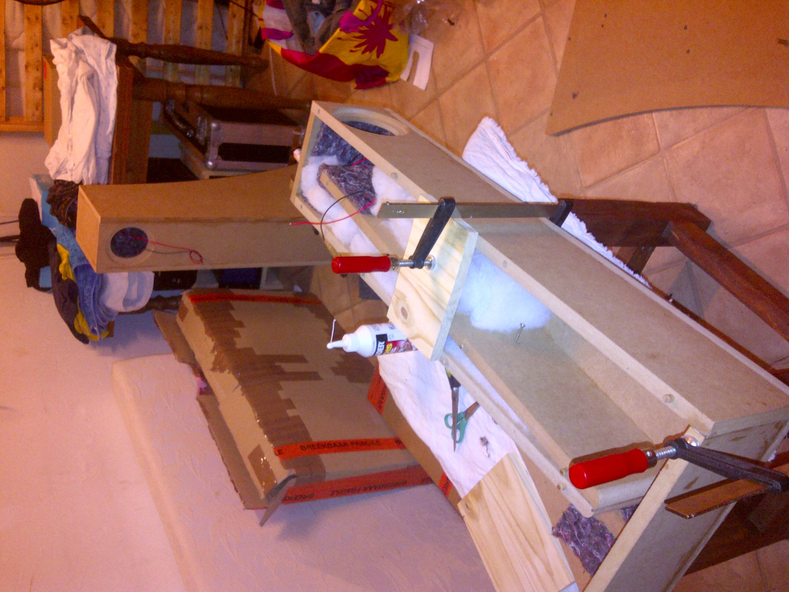

...we will proceed with a stacked FH, in this case specifically targeted at the VRW MTM kit
Breaking in... promising.
dave
Interesting. I tried this some time back with twin alpair 7s - result was a more "powerful" sound, but I'm not sure if it was that much of an improvement. Would certainly suit bigger rooms though.

well you know there's always someone who thinks they need more, so proof of concept and all that.
essentially a pair of stacked FH3s without the angle - each of the VWRs in separate horn, with a little extra blocking at the separating panel to isolate the LDX tweeter
