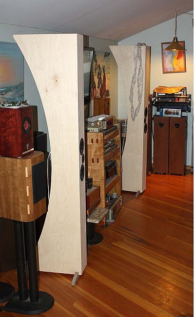

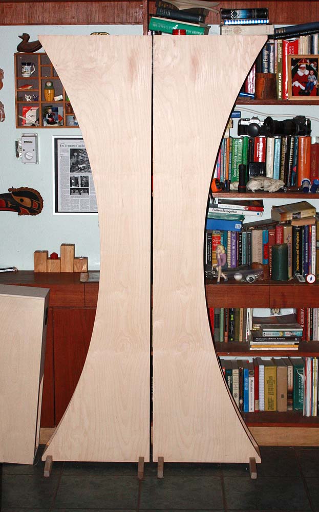

What became of this Twin FH3 project please?
They sat in my main system for a couple weeks and were deemed good. The 2-way did good image/soundstage (bit not up to the best FRs), excellent, tight, tunefull bass.
Should make some really good 1.5 ways.
I was able to get them backclose enuff to the wall, so that my wife did not object (Mashowe & Victor blocked the TV from the dininf eoom rable)
They are now set aside form the next audutuiner.
Guess i should clean-up andpost the plans.
For valentine's here is a pic of them kissing...

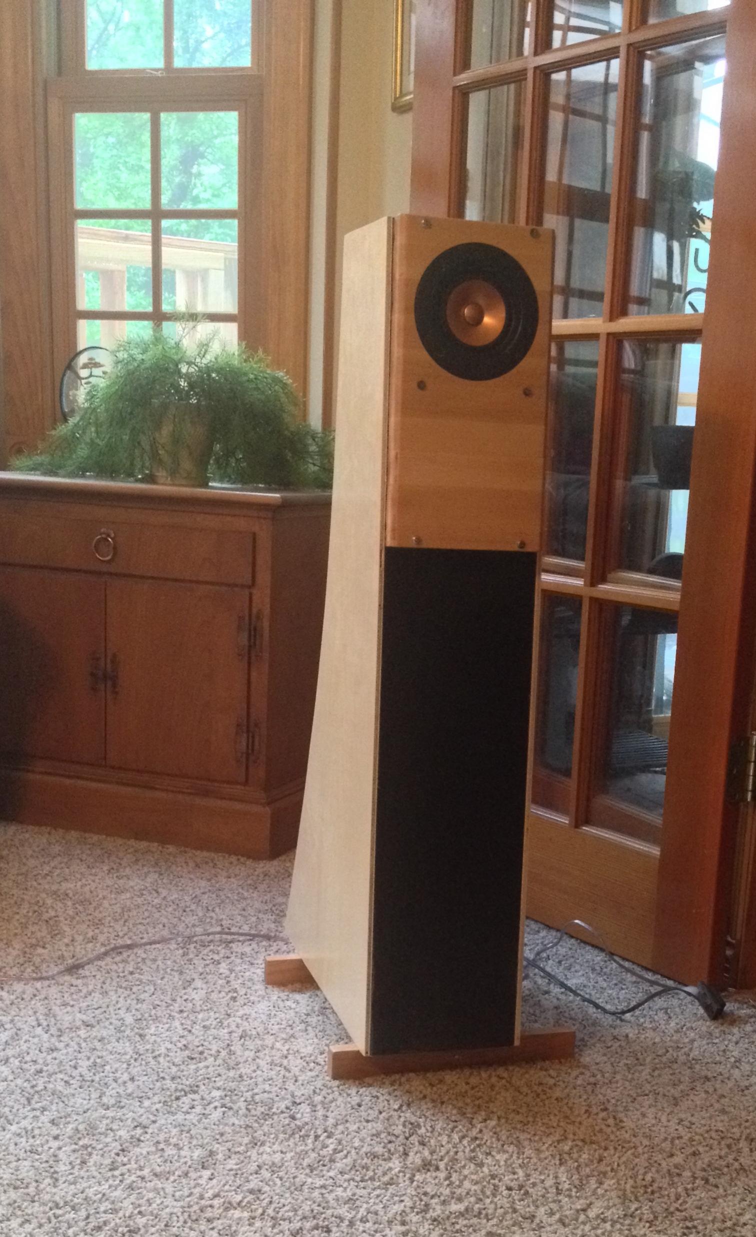

Almost finished with my latest build- FH3 with A7.3. I ordered some black laminate for the top and front that should be here Friday. I might add a small filter to smooth out the mid/upper range of sound. There's a tad bit of harshness to these. Kind of surprised by that. I didn't notice it when I played them in the rough unfinished cabinets. However, since there was nothing else I could do with these, I had to give them a listen. Other than the issue with a filter, they sound fantastic. If I close my eyes and listen, I can almost see the different instruments playing in different parts of the room. Imaging/soundstage is phenomenal!
