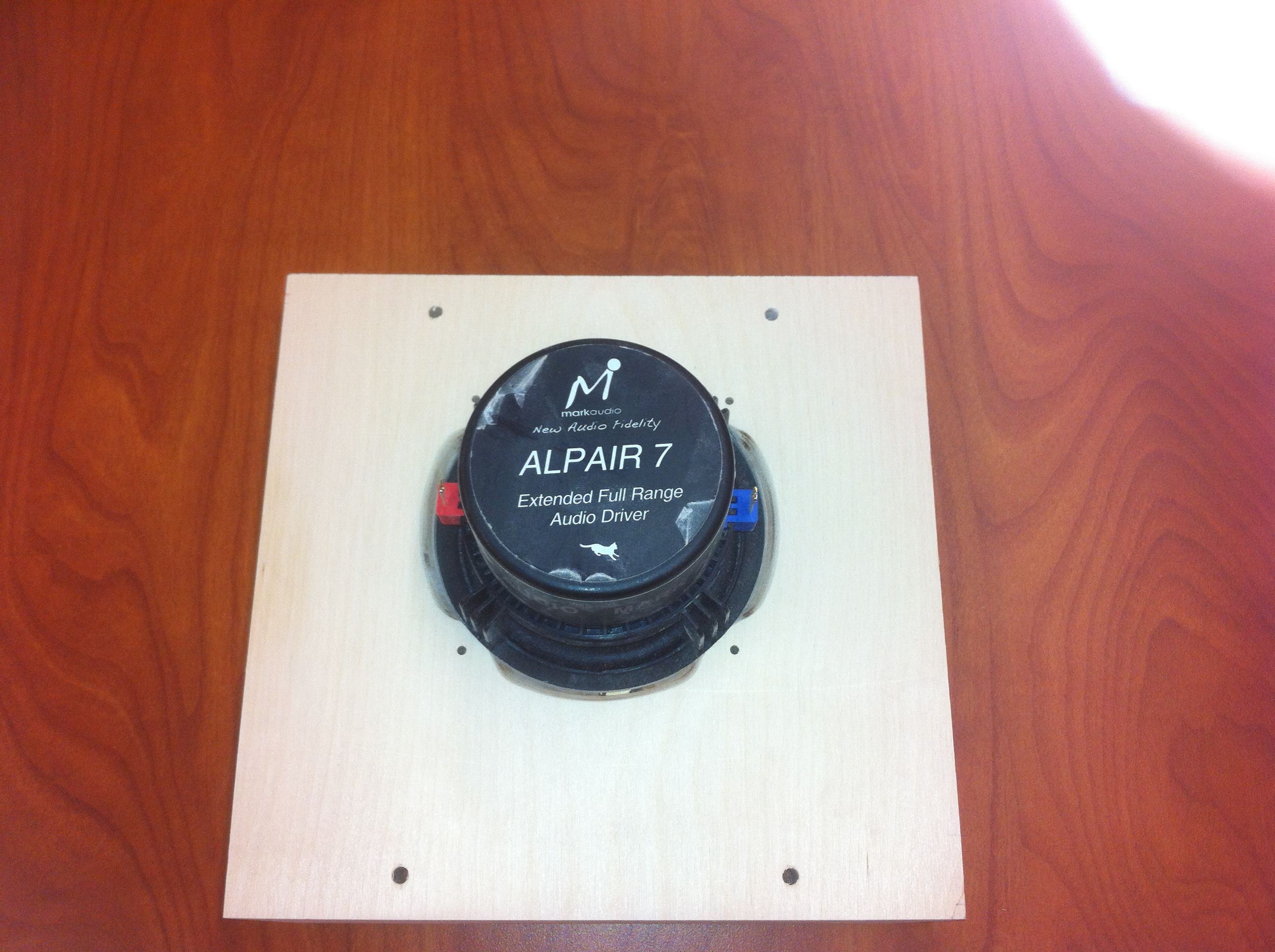

What is the point of the 45ºchamfer for an A7. How deep should it be in 18mm BB ? Am I just breaking the edge? How about a 1/8" roundover?

Given the 10mm rebate depth, you want the bevel to be 8mm. A roundover is not as effective, it would need to have an 8mm radius for maximum performance.

I'd suggest scalloping the chamfer to leave full thickness "pads" that shadow the basket's mounting frames (see photo - this happens to be one of the removable SB plates for FH3)
When not using the extra bezel ring, and allowing for minor compression of molded gasket and post veneering, a rebate depth of 8mm will still leave a good 10mm of core material on 18mm ply.
The scollops being about 5/16" ?
I was planning to use the extra bezel ring but the prevailing opinion seems to be "why bother?" I just wonder why not?
The scallops being about 5/16" ?
As hard as it may be to believe, some details like this don't actually get measured, and I'd have to put a tape on them to be sure - I just set the router so that with the baffle face down, the center of the bearing on the 45dg bit rides on the "bottom" edge of the through hole.
You might not get as heated a debate on that question as with MDF/Plywood 😀, but let's just say opinions vary.I was planning to use the extra bezel ring but the prevailing opinion seems to be "why bother?" I just wonder why not?
I've built a fair number of enclosures for 7.3s both with and without the extra rings, and it just so happens that my Pensils and center have them, and FH3 and two other enclosures currently in house ( Decware DNA horn, and P10 mFonken) don't. While Mark would probably be happy to explain (again) their purpose, and someone with the right gear and interest could probably measure the difference, I'll be damned if I can hear any - but then my hearing's never been as good as I thought it once was, and certainly isn't so now. That certainly doesn't constitute a prevailing opinion, just mine and perhaps a few others - to be fair, it does constitute second guessing the designer of an excellent series of drivers.
