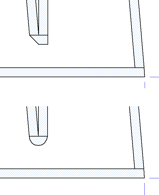

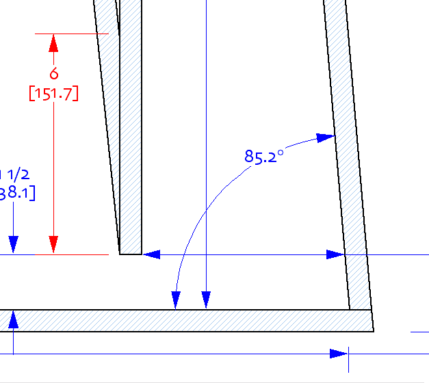

I had the question asked today about 3/4" material. Without resorting to a Tenon jig, that further compromises the maximum "1 material width" length of the choke point.
Do you think something like the attached use of half-round would work,
dave
dave

There are a number of ways that could be cut. What is required is a Scarphing/scarfing jig.
I'm going to use some ~1" ply that I have access to in offcuts. That is how I planned to make the join...except I was going to scarf the ( in my case thinner ) inner divider, and 1/4 round the back part per the plan. I have to make a full size drawing to work from when I do these things anyway. That will allow me to maintain the inner dimensions per plan.
The scarf cut can be made with a variety of tools, from a simple block plane, to a belt sander, or a router ( manual or CNC ). That join is used in wooden boat construction to end join 2 pieces of wood where strength needs to be maintained, Eg: a birds mouth mast layup, or end joining ply for skinning a bottom. It's approximately a 10:1 scarf cut.
Should do fine.
