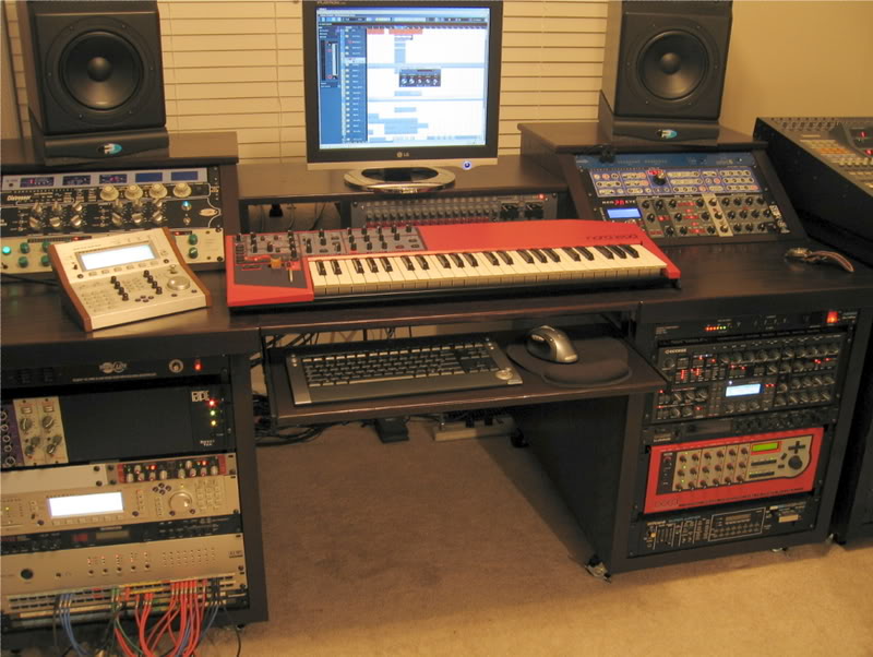

This is more of a serious build for a desk top dont you think
Not at all. I've seen OB on desks, I've seen some neat TLs (Alpair driver) on some desks, we've got Fonkens, 2-ways, Sprial Horns...we've got 'em all. So how about a mini-FH ?
Anyhow, a busy desk ain't so bad ;)
Yeah, this would keep me busy for months if I had one like that.
So back to understanding the new FH3 and horns in general. If I use a small driver and don't ask it to go down as low as the larger driver then I should be able to use a shorter horn with a smaller mouth. Something around 500mm high would be ideal for desktop use as it is close to the top of most monitors/ears.
