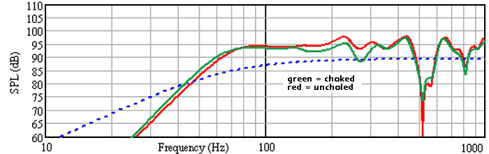

Just to expand on this a little, as you can see from the 1/2 space plots Dave posted above, in fact the choke / axial baffle in the horn expansion has very little effect on the bottom end. What it's there for as Dave notes is to attenuate unwanted shorter wavelengths / higher frequencies from passing through to the terminus. The effect on the horn's upper corner-frequency is actually rather more apparant when the cabinet is corner-loaded or used near a rear boundary as intended, and the respective termini outputs are compared when so positioned.
I was curious as to whether the 'choke' in the hypex horn could be raised to the point that it would be removed. I understand the choke acts essentially as a low pass filter but would increasing the line length (thus the height of the cabinet) do the same thing?
If I'm understanding your question correctly, not really, no. All other things being equal, by lengthening the horn, you'd simply by tuning it to a lower frequency.
