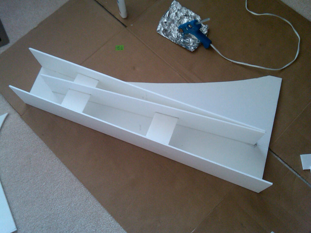

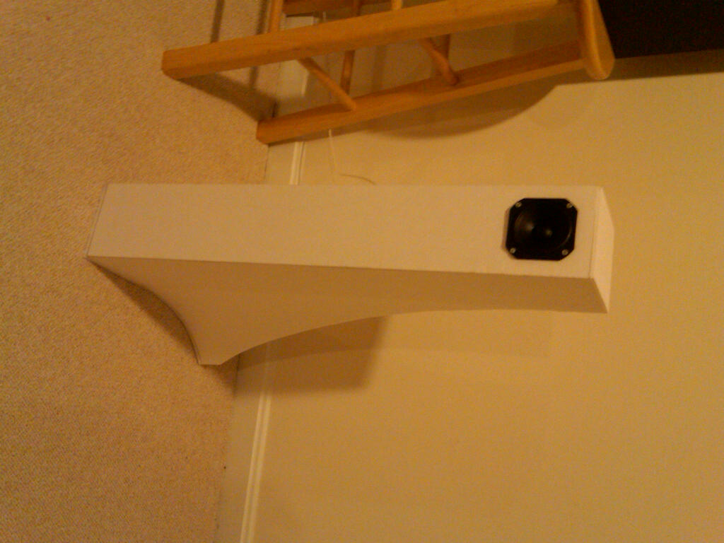

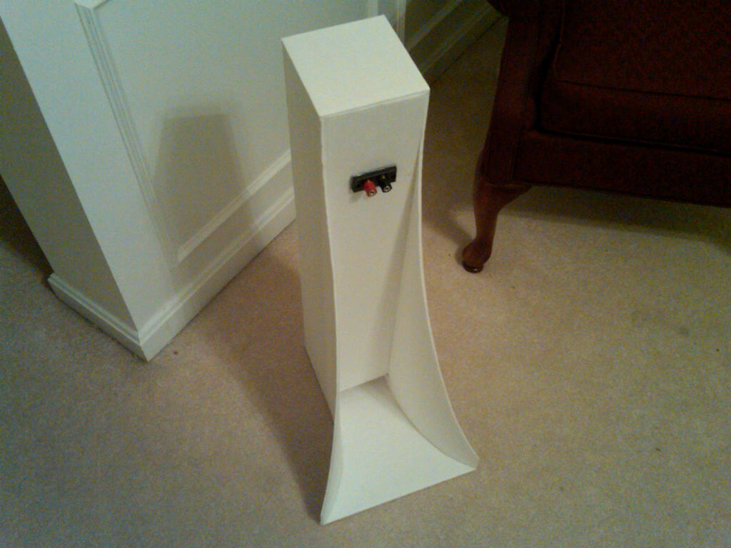

For anyone wishing to try the FH3 quickly and cheap in a slightly smaller format, I just built a 30 in tall one in an evening and morning using paper faced foam core boards from the dollar store and the Vifa TC9FD 3.5 inch driver with pretty good results. More info in this thread:
http://www.diyaudio.com/forums/full-range/223313-foam-core-board-speaker-enclosures-102.html
It is not an FH3. As soon as you changed the dimensions it ceased being an FH3. Nice to see the FH3 insporation for sure.

Thanks for the support Mr. Secretary 😉 To me, it sounds really good, so much so that I promptly ordered more drivers to build the other channel. I am playing with varying the stuffing and type of stuffing. The neatest thing is how light weight they are yet still manage to make such a lovely full rich sound with nice bass. The lightness makes me wonder if many speaker designs can be made with 1/4 in or even 3/16 thick plywood and work just fine. As much as this foam core design ceases to be an FH3 the moment dimensions are changed, it owes it's great sound to the design that inspired it. One other thing, if you are not sure if you will like it, the cost and effort to build isn't a big deal. And if you find that you like it in foam, you can go forward with a real wood and pricey driver build with confidence.
