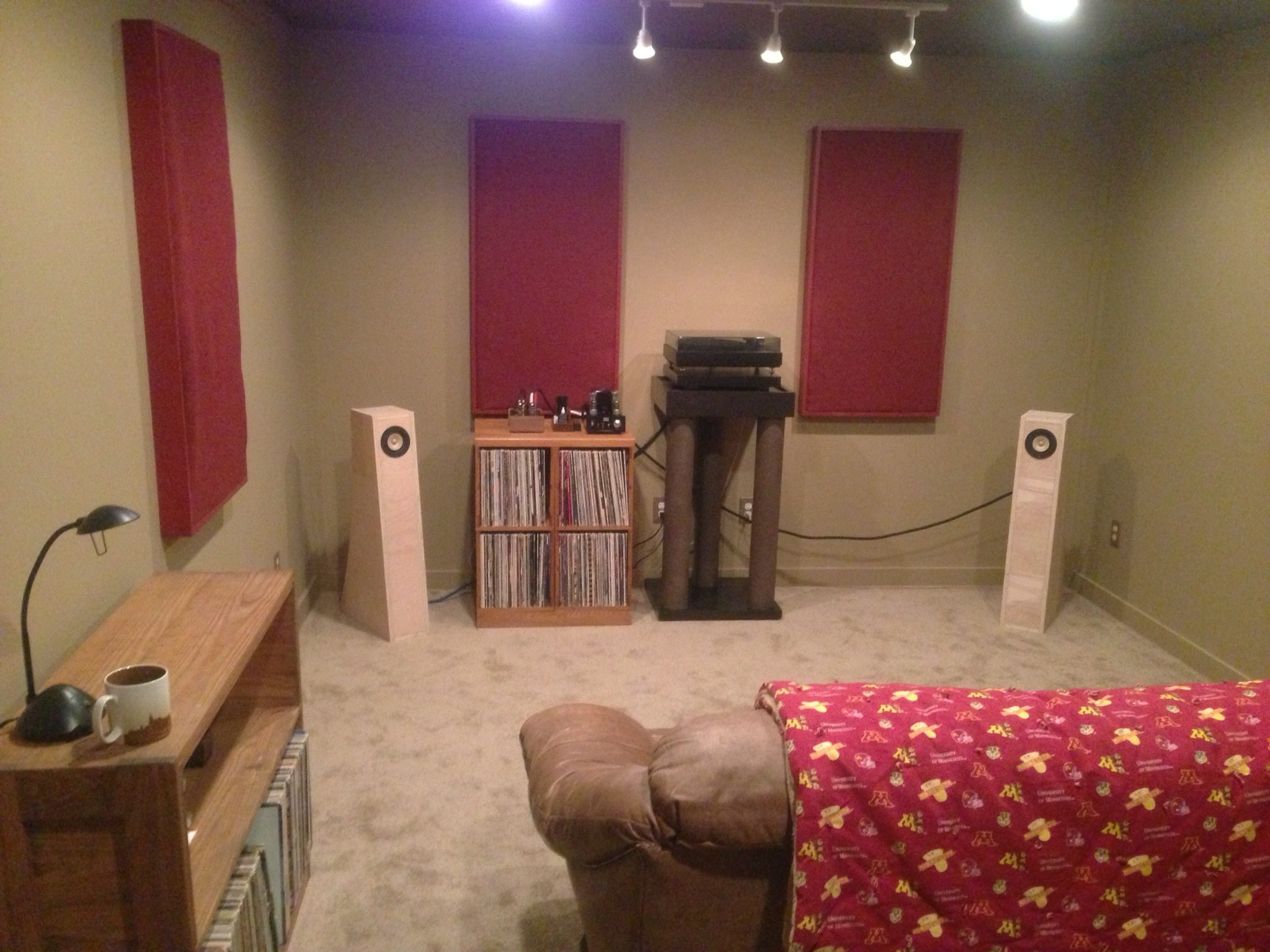

Well, the listening room is complete! I have the system in place and the FH3's positioned. They are currently placed about 18" from the corner, and toed in at a 45 degree angle. The speakers are ~8' apart and about 8' from the listening position. The room is 11'6 x 16, with a 7'6 ceiling. I have the acoustical fill in the front chambers (lightly), below the drivers, as well as having the V dampened as suggested. I'm getting plenty of bass, but it's a bit boomy. I'd like to tighten it up. I can remove the tops to adjust the fill if necessary. Any suggestions on room placement and/or fill to help? BTW, they're being driven by a 6W MP-301 Mk2 integrated amp and get plenty loud. Pics of the room to show placement are attached.
Tom
Tom
Tom
try pulling them out from the corners even further - progressively, 1 couple of inches at a time?
