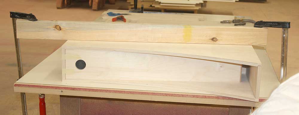

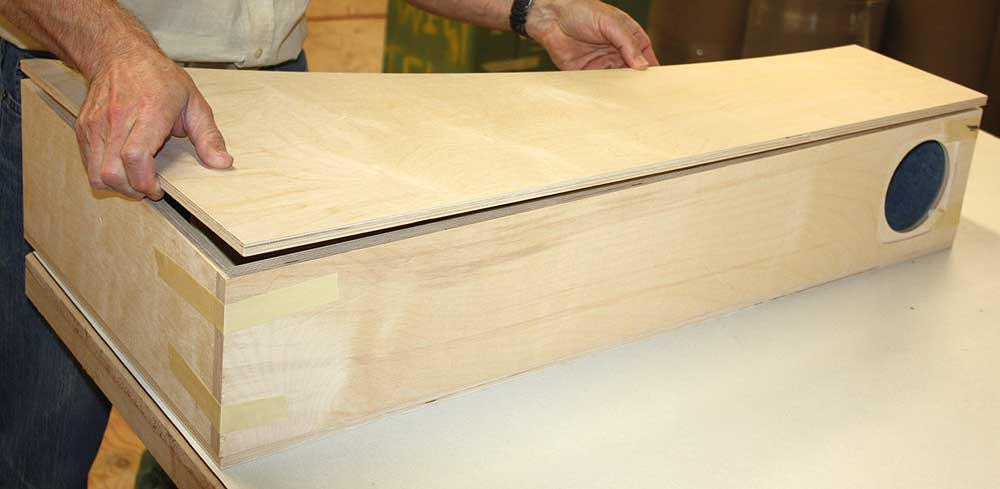

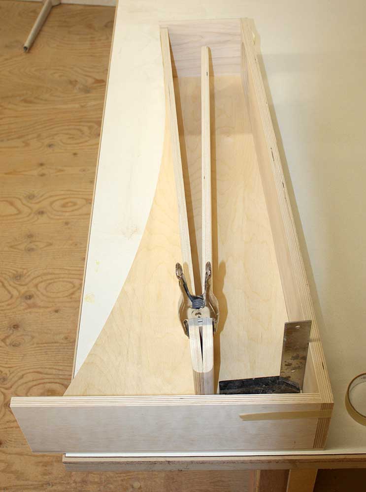

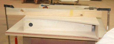

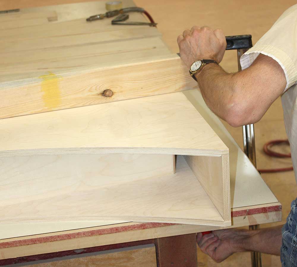

Top, baffle & bottom put into place (in that order). The baffle is the longest piece in the kit, and some of them may have a bit of a bow. Masking tape should be sufficient to pull everything into place and hold it till the glue drys. You don't need much pressure. (do not use packing tape, the glue on it sticks to the ply after the tape is removed, and is a bitch to get off)
If the baffle bows out at the middle a clamp may be helpful.

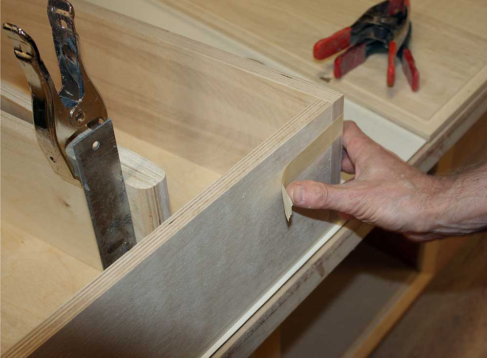

Don't forget to check with the square. Leave to dry.

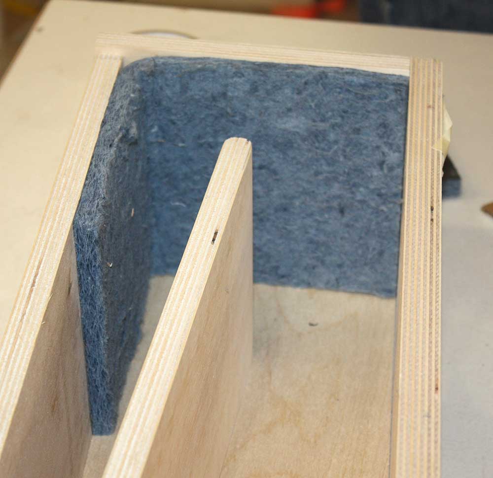

All the panels now in place, time for the damping.
All the felt pieces have been rough cut. Width will need checking, and you'll need to cut out the sides. I posted a full size template earlier in this thread, but you probably want to double chack against your install. Make sure that the sides are mirror images (if you forget it is easy enuff to peel off the black backing) The felt can be fixed in place with glue or hot melt. The black backing on the cotton felt makes this a cinch.

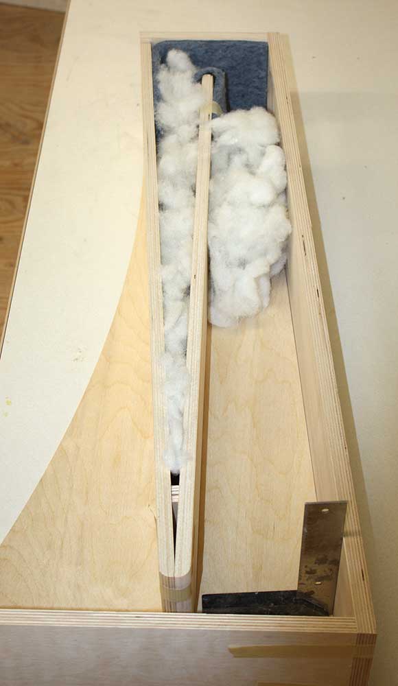

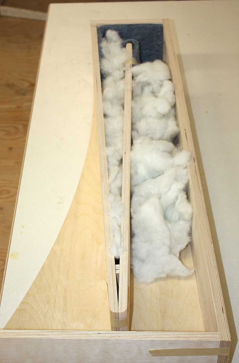

Back 1st, then the divider panel (if you haven't done it earlier). then one side. Now the fluff -- tease it very well. The sandwich bag of fluff should get to be a BIG pile once teased. Consult the damping plan.
(Note: the fluff we used to illustrate placement is not well teased and ot of a quality that makes it actually useable)
The pointy part of the line gets one of the 30g packages. You are trying to distribute equal amounts along the length. Since it is pointy at the bottom this means a decreasing density as you approach the fold.
For FE126 you should be good (there is an extra 40g of fluff if you need to fine tune)
For the Mark Audio drivers there is a 40g bag of fluff for the wider part of the line below the driver. This part tunes the amount of bass. If you want big fat rounded bass you can start with none. Using all of it will give a full halfd-pound per cubic foot. You may want to do something to keep the fluff here from drifting to the bottom of the cab. Door screen mesh, a couple long screws sticking out, a piece of low thread count cotton or other acoustically transparent material like double knit.
It is easier to start light and insert more thru the driver cutout than reach in and pull it out.

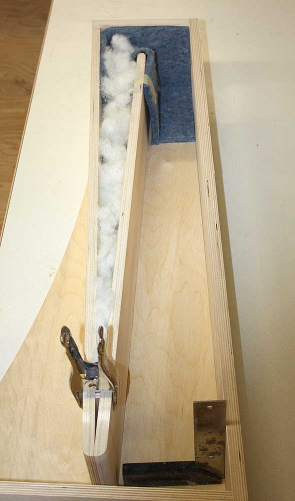

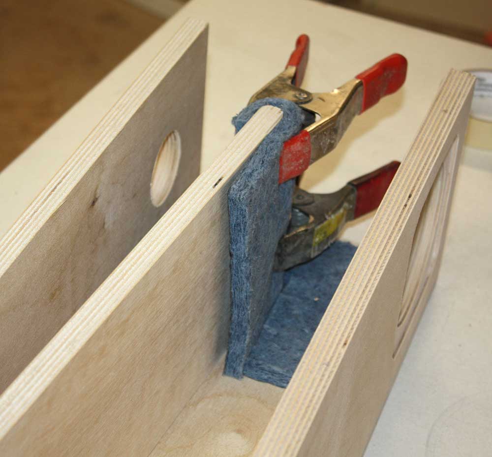

Now it is time to nstall the other felt side. Just float it ontop of the fluff, making sure it is clear of any of the gluing surfaces. After the other side is solid you can reach in and mke sure it is solid against the side. A couple spots of glue should do to hold it in place.
Tweaking of damping fluff can be done thru the driver hole, add or subtract from the back top or under the driver. Low density amounts can be placed right behind the driver.

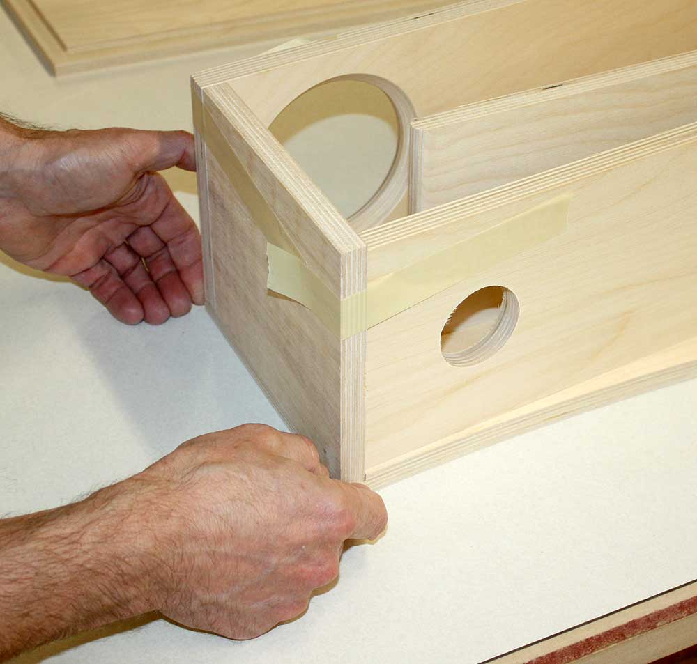

The other side.
It should drop right into place with the internal bits tight up against the dadoes on the side.

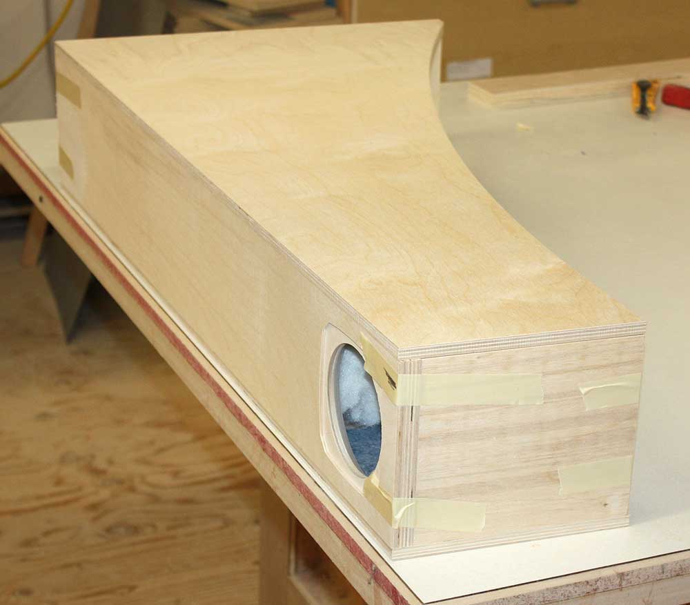

Some clams are useful here (use some sort of clamping aid to distribute the force and protect the sides -- we used 2x4s in the picture) Alternately, masking tape and the big pile of weights, books, 4 litre plastic milk bottles full of water.

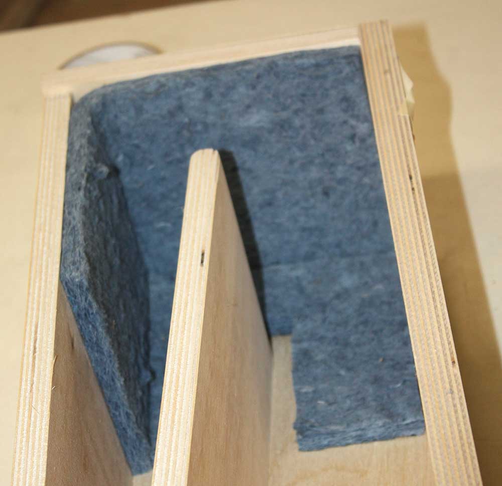

I think you're missing one pic of the dampening material put on the last side panel up near the driver before gluing it up. It looks like it's L or U shaped on the side facing up?
Yes, there is no picture of that, it is just in the text. I could probably photoshop it in 🙂

Some clamps or weights during the first assembly stage - i.e. before damping padding - ( or even braid nails), wouldn't hurt
White glue ( Weldbond, etc) is great for attaching the Ultra touch insulation, but I'd recommend yellow carpenter's or polyurethane (Gorilla, etc) for the panels
Note that moisture cured polyurethane glues requires substantially longer curing time, and can definitely swell exterior panels out of alignment- so clamping is required - and it will stain, so if your finishing plans are for clear coat, I'd suggest yellow glue and masking/pre-finishing of interior faces of side panels before glue up

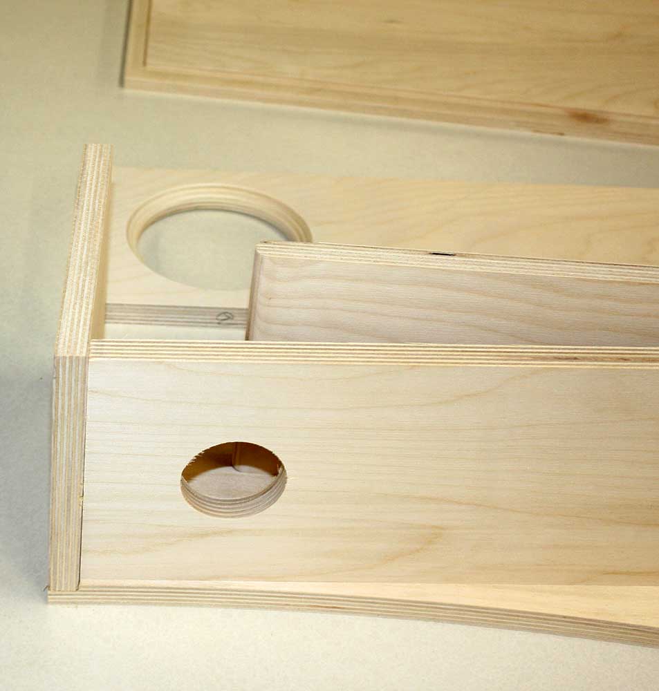

2 pieces of wood inside the cabinet to fit VERY tight in routed out grooves. I had to use sandpaper to get them to fit. The ends fitted very well but the centre required a bit of sanding on the edges of the grooves.
Another question:what is the small block of wood used for the one that is about 3" x 3"?

Go ahead and build without one of the side damping pieces, and you can fit the additional piece thru the driver opening.
The 3x3" piece is a packing spacer that makes room in the stack to tuck the drivers into the stack.
