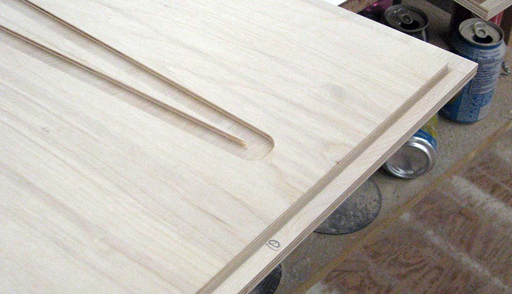

Flat pak material is shop grade Baltic Birch plywood - 15mm for cases and 18mm for front baffle. Best efforts were made to select cleanest face for exterior surfaces, but there may still be minor pin-knots or foot-ball patches, and a thorough scraping to remove glue squeeze out and sanding after assembly down to at least 220G would be recommended for direct finish.
BB takes a clear top coat ( lacquer / polyurethane / shellac / natural oil ) quite nicely, but if planning on staining, a pre conditioning sealer would be recommended to avoid blotchiness.
They are machined with dadoes to position internal panels in one side, and all 3 external panels (top/front/bottom) on both. The internal faces could be masked off and prefinished before or during assembly (as I did with current pair)

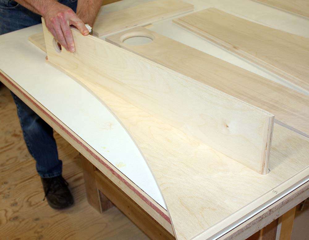

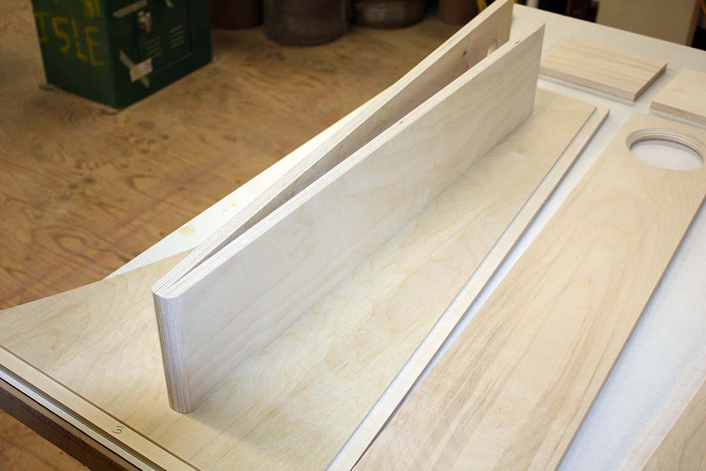

Chris came up with a clever way to deal with the choke point.
1/ the rebated side with the choke point
2/ fitting the back
3/ back & internal divider in place
Note: the fitment here ranges from tight to really tight depending on actual panel material thickness, If real tight just take it slow & steady

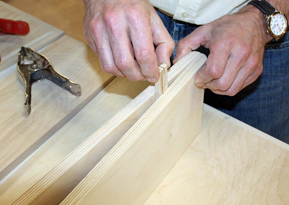

4/ the extra little bit to provide more glue surface and proper spacing

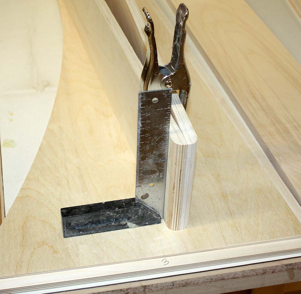

5/ clamped up for the 1st "wait for the glue to dry".
Note: it is very hard to install these and not have them perpendicular, but you should check anyway.

Addendum: despite somewhere, somewhen recently posting that it was hard to precision CNC BB, be very careful handling the pieces. Corners are sharp enuff to cut (i had all sorts of nicks after we did pre-pack bundling on the kits... and if you get a sliver, you will be screaming.
Addendum 2: in the pictures in the previous post, you;ll see numbers on the pieces in some of the pictures. These were to keep track of pieces to try to get the best matches for surface character

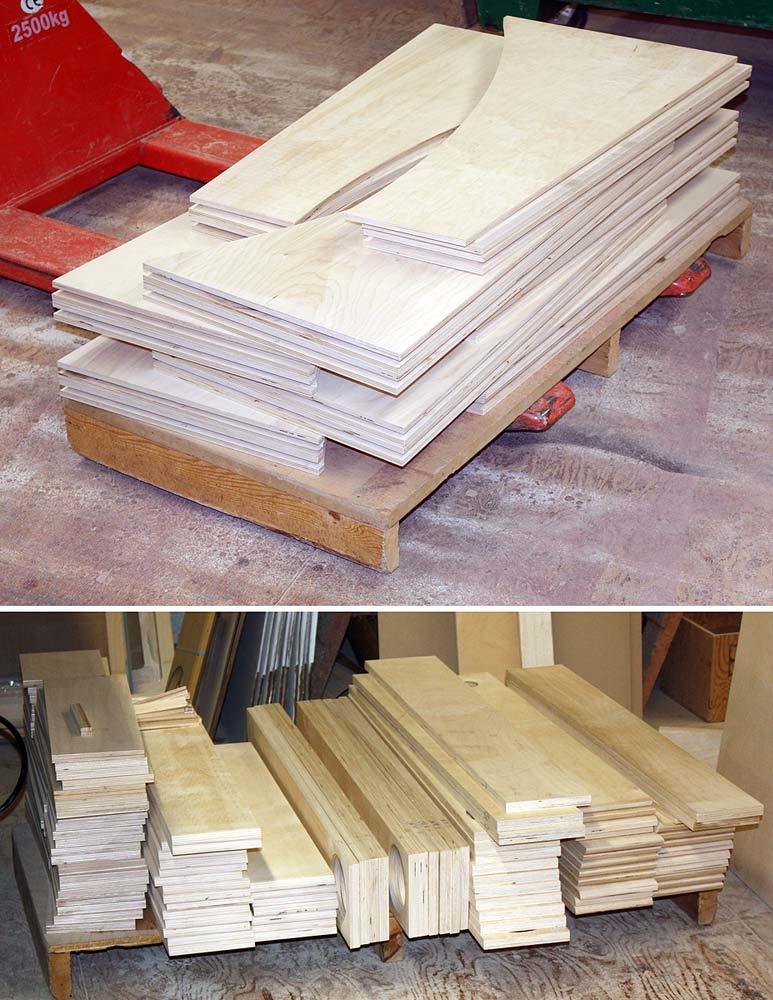

Attached is a stack of paks (3 had already been taken away, and 2 sets of sides are still embedded in the sheets of plywood -- haven't been CNCed yet)

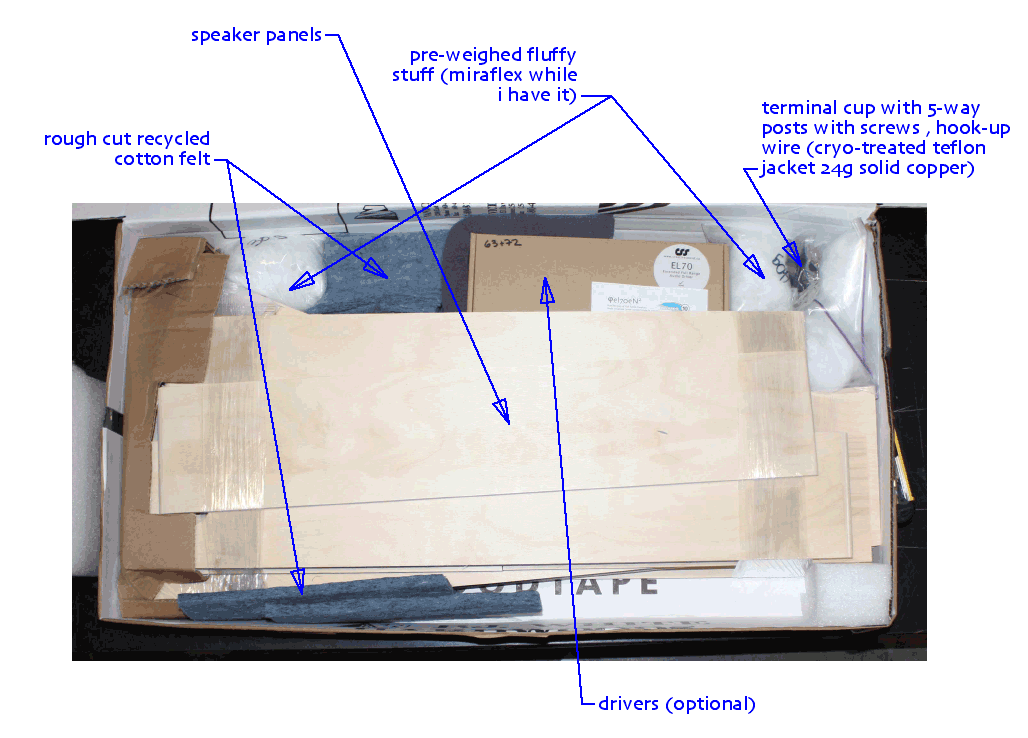

Here is a photo of the contents of one of the packs done last night with captioning.

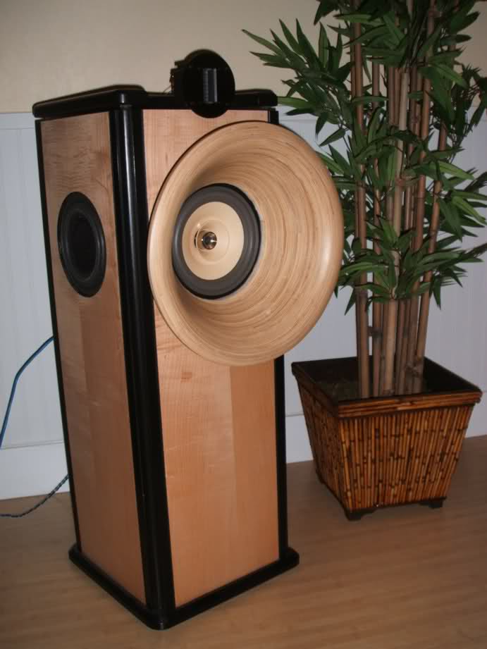

FH3 supra baffle
Question about a pseudo front-horn....
Once many moons ago just out of curiosity I bought a a pair of bamboo salad bowls from Target that had a contour that looked suspiciously like a horn profile (hey they were only 20 bucks). The base of which was almost exactly the same size as the cone diameter of the FE206. So I cut it out and blue-tacked it to the front of the driver in a Decware HDT cabinet. I don't think it was much of a horn effect because the bowls were only about 10" deep and maybe 15" in diameter if I remember. Not that it's important but I think the HDT is a transmission line. What I noticed was a slight raising of efficiency (a little louder) and a touch more lushness or presence (not sure how to describe it) in the midrange and without any detectable negative effects that I could hear. I liked it and thought it was an improvement.
What do you guys make of this? It must have something to do with a combination of pseudo-horn loading and baffle effect, no?
Could this type of thing be added to the FH3 to good effect?... assuming the proper size and contour "bowl" could be found, or made.

It sounds great! A little more efficient, more midrange detail (as if there wasn't enough already!) while still sounding smooth and not bright, midrange is more "juicy" for lack of a better word, and a hair better bass. Only downside I can see so far is you lose allot when not seated unless you're clear accross the room. Putting something under the fronts to tilt them back could help that.
While these are not large enough for a "true front bass horn" I think they are helping the mids by compensating for some baffle step loss.
