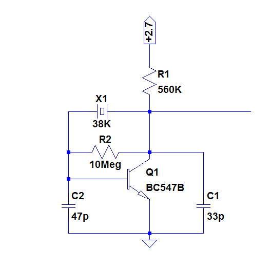

Looking at your table, I had a kind of epiphany: a symetrical, complementary design was bound to have a hefty, difficult to reduce current consumption, meaning single-ended was the logical way to go, and I came up with this practical, tested design.
>I'm surprized you have a 38 kHz quartz ...
As I am a hoarder, I have a large stock of everything, some were even bought when I was a teenager.
I have crystals of all common frequencies, plus many other, but I could have made the test with a 32.7K one.
> Looking at your design : R2 130Mohm ? Transistor can be a BC84x one ?
Oscilloscope pic is with a 1:10 probe , I hope ? A ST gate will clean that up , not that I expect much better from a 4069UB output.
The initial values, including the ~130 Meg resistor were the raw results from "back of an envelope calculations".
Although they worked, they aren't optimal: the resistor can be much smaller, in fact 2.2 Meg still works.
10Meg is probably reasonable.
The probe is indeed a 1/10, and has 12pF capacitance. In fact, without the probe the oscillator stops.
C1 should thus be increased to ~33pF (although the subsequent gate will also have some capacitance).
The waveform is typical of a linear oscillator, but it is somewhat improved with a lower bias resistor (better duty-cycle).
I opted for a 2N3904, because I feared the higher feedback capacitance of a BCxyz would make the oscillation more difficult, but this fear is probably unfounded.
I'll test other types tomorrow.
A ST-input gate will be necessary at the output, otherwise you will be confronted with the same cross-conduction issues that plagued your previous attempts and made the current consumption unbearable.

I hadn't ignored Mark's idea , but discrete was not something I could do.
I was thinking more like 4007 kind of discrete , but like the Elektor pic shows , it is not that good , and I don't have an 4007 .
You build it with an 130M R ? I didn't even know they exist , but then I see at Mouser up to 10Tohms , uhm what ?? Yes Terra ! That is insane . A PCB is never going to be that clean .

As shown, the 4007 is used just like a 4069, and will suffer the same ills.
It would be necessary to use the individual transistors in a non-complementary configuration, but I don't think it is worth the trouble.

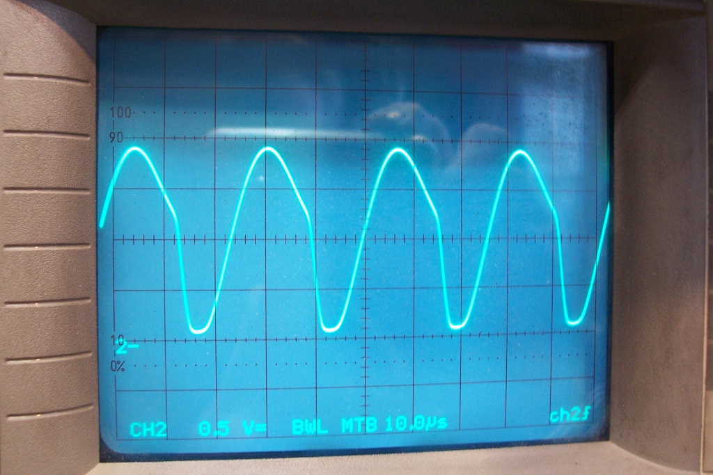

I have tested an updated version of the BJT oscillator:
This is the waveform, measured with an active probe having a capacitance <1pF:
The amplitude is a bit smaller than with the 2N3904, but it remains acceptable.
A thorny problem now remains: the output wave-shaping.
That has to be done with a schmitt trigger, but with the input spending a lot of time in the mid-supply region, I feared that the consumption would go up, and I was right unfortunately.
I tested a single operator of a 74HC14 at 3V Vdd: the consumption was 80µA.
With a 74HC132, it was also 80µA, but I hoped that disabling it using the other input would halt the consumption, but nope: it was reduced to 75µA.
A 74AC14 required 720µA, but a 74HCT14 only needed 26µA.
To benefit from the micropower properties of the oscillator, you would need a matching shaper, which is certainly not impossible but would be relatively complicated.
Therefore, your best option remains the LC oscillator

If the second line from below is the 0V , then yes it spends most of the time in the higher current zone and looking at the 2 ST thresholds of AUP and AHC, the duty cycle will be very asymetric.
I may try it though . I have BC846B and BC849C and even a 15 Mohm 0805.
Thanks Elvee !
Thanks Elvee !

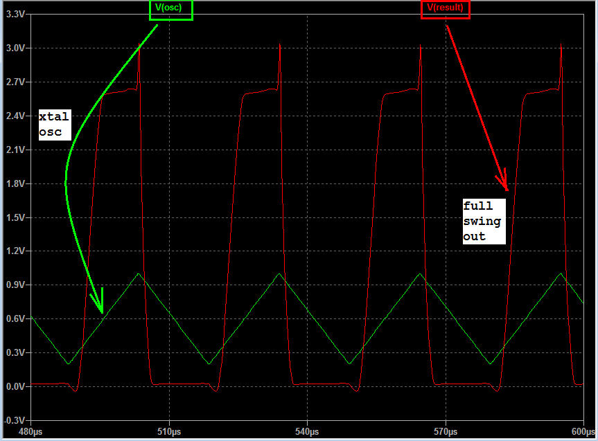

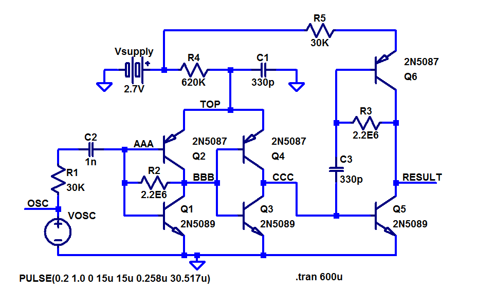

Here is a quick-and-dirty attempt to "build a CD4069UB out of BJTs instead of MOSFETs".
Works pretty well, draws ~ 4.8uA in steady state, might be a useful starting point for a more serious effort (?)

With the ICs I tested, the final duty-cycle was mildly asymetrical.If the second line from below is the 0V , then yes it spends most of the time in the higher current zone and looking at the 2 ST thresholds of AUP and AHC, the duty cycle will be very asymetric.

15Meg is perfectly OK: the oscillator is extremely tolerant regarding that resistor
It looks fine, but as I remarked earlier, a µ-power shaper would be relatively complicated: 6 transistors to shape the waveform of an ultra-basic 1-transistor oscillator is acceptable if you really need it and have no other viable solution, but otherwise it isn't the most attractive option.Here is a quick-and-dirty attempt to "build a CD4069UB out of BJTs instead of MOSFETs".

Yes 6 transistors is a bit much for my project here , but it can be useful for others.
A micro power opamp with ST could do the same.
