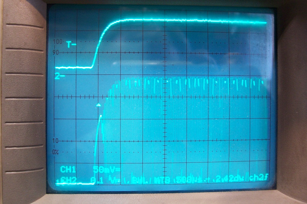

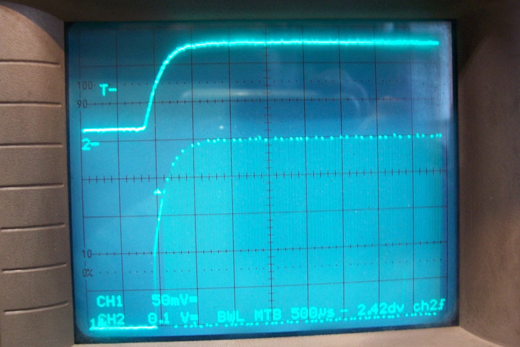

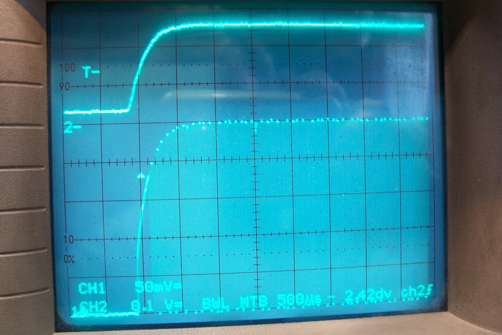

I have measured the startup time for the three 74xxx at 2.5V Vdd (worst case).
Top trace is the supply voltage, bottom is the unbuffered output.
First, the HC04:
Next, the HCU04:
Then the AC04:
Thus, around 250µs for all three

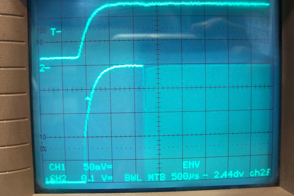

The AC04 with the 2x33nF + 1mH inductor:
This time, it is increased to ~1.5ms.
Note that the small oddities on the signal are the result of artifacts generated by the scope being in digital mode. On the last pic, I activated the envelope mode to clean up the waveform.
I also tested the idea of heavily asymetrical capacitors (for the AC04, but it would work for the others too): 1.8nF (input side) and 20nF (output side).
Nothing changed, except the stability between 2.5V and 3V became better than 1Hz. Probably on a par with a ceramic resonator, if not better.
I also tested a 74HC00, and it worked exactly like a 74HC04.
Consumption at 2.5V is 50µA and 104µA at 3V.

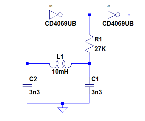

Hey Elvee , the R1 of 27k you mentioned in post 23 , does it have the same function as an R in that spot for quartz oscillators ? Is it there to limit the current through the 10 mH ? How to optimize the value.
You also tested heavily asymetrical capacitors . Did that change the duty cycle ?
Yes, it limits the coupling between the output and the tank circuit, allowing it to oscillate more freely.Hey Elvee , the R1 of 27k you mentioned in post 23 , does it have the same function as an R in that spot for quartz oscillators ? Is it there to limit the current through the 10 mH ? How to optimize the value.
Too low, and the IC will influence the frequency, too large and oscillations will become weaker and eventually die out completely.
Use the procedure to determine the value, but I expect it to end between 10K and 40K:
The resistor can be zero to start with (or a low value like 470 ohm).
You can then increase it until the oscillations become too weak for a reliable operation.
Opt for a value 30% smaller, to ensure a good stability and reliabilty.

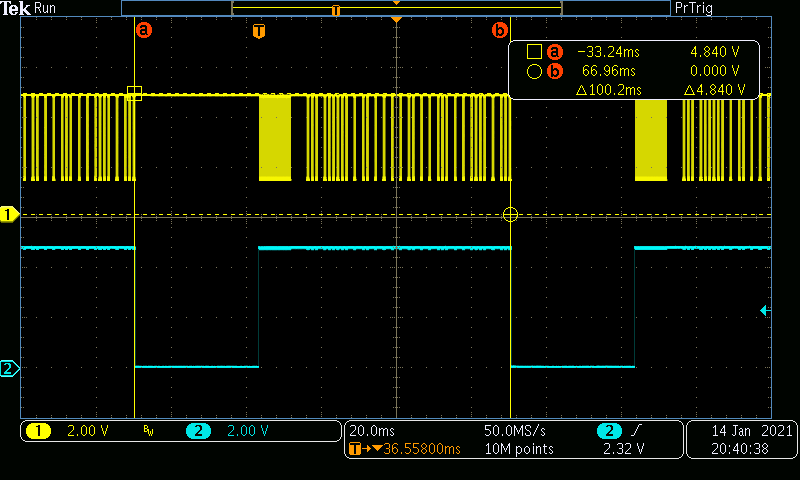

A completely different approach could use an Arduino nano. This lends itself best to a small number of switches.

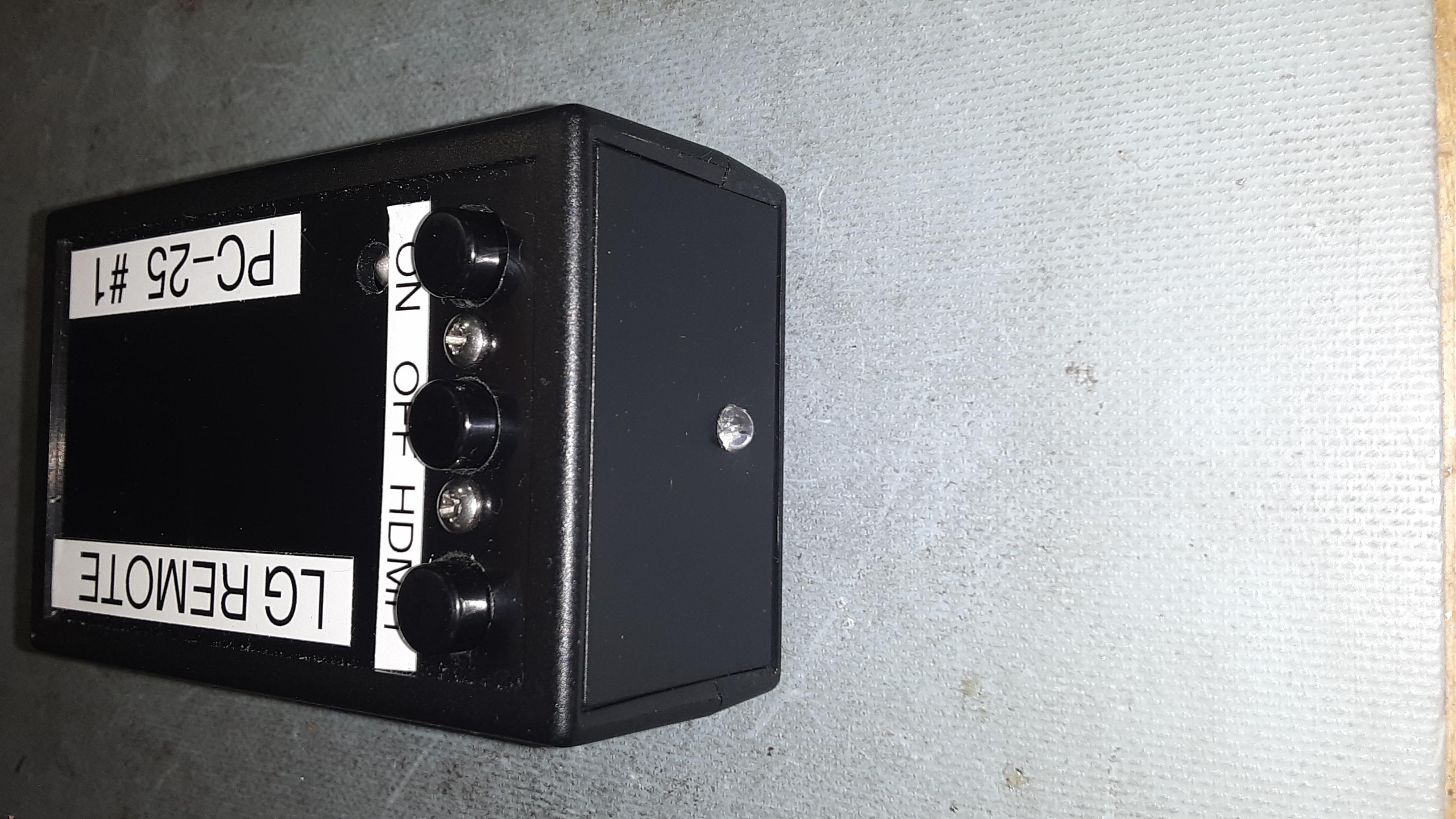

I built a special remote for LG TVs that transmits the 'power on', 'power off' or HDMI 1 codes. There are 4 TVs
side by side and the normal power toggle function doesn't work reliably. This remote continuously transmits a
code with no "repeat" codes. Repeat codes are only useful if the unit received the first code. Press and hold the
power on and just sweep it around the room until all 4 TVs are on. The .TXT file is the Arduino sketch (simply
renamed to .TXT) which could not be much simpler. Same for the hardware simplicity.
The power to the Arduino is the 'OR' of the 3 switches, any of which powers up the Arduino. The other pole of
the switch selects function. The 'activity' light is software driven and can only light if the program is running.

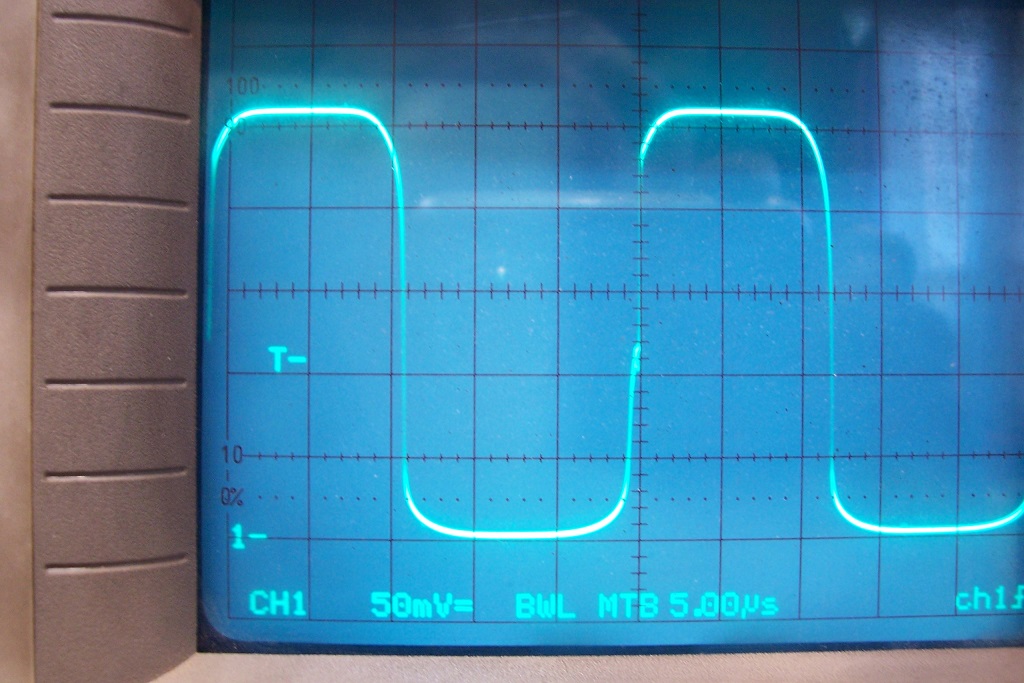

The scope photo is the modulated 38 KHz carrier in yellow and the scope trigger in blue. It transmits 10
messages per second.

No, the duty cycle is determined by the thresholds of the MOS transistors of the logic operator, and will always remain close to 50%
You'd think that the smaller cap is filled quicker and influence the duty cycle.
So to choose R1 , I need an oscilloscope . I'll try the recommended 27 k first.

Not necessarily: you can use a detector probe:So to choose R1 , I need an oscilloscope . I'll try the recommended 27 k first.
Thanks Elvee.
Oscillation Sniffer
It is less convenient than an oscilloscope and will only tell you the amplitude, but nothing about the frequency or shape, but in your case, it should do the job
