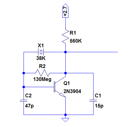

Yes I already made that oscillation sniffer .

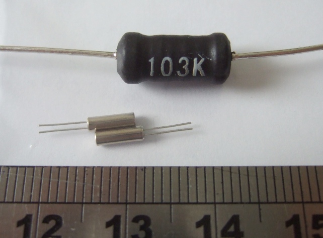

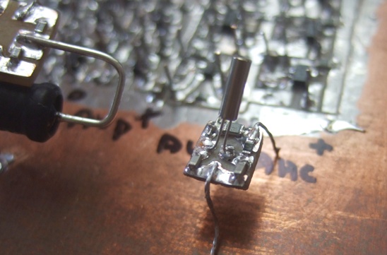

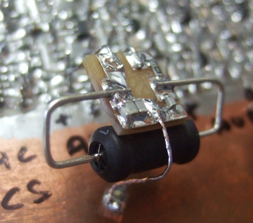

The 10mH came ... that is a big motherf : I didn't notice while ordering , I was looking at the little pic : https://www.mouser.com/ProductDetai...=sGAEpiMZZMv126LJFLh8yyVlOY2UZQmb8R6s3vr5vdo=
Here is the actual one ( yes like on the datasheet) , compared to the 38,4 kHz Xtals .

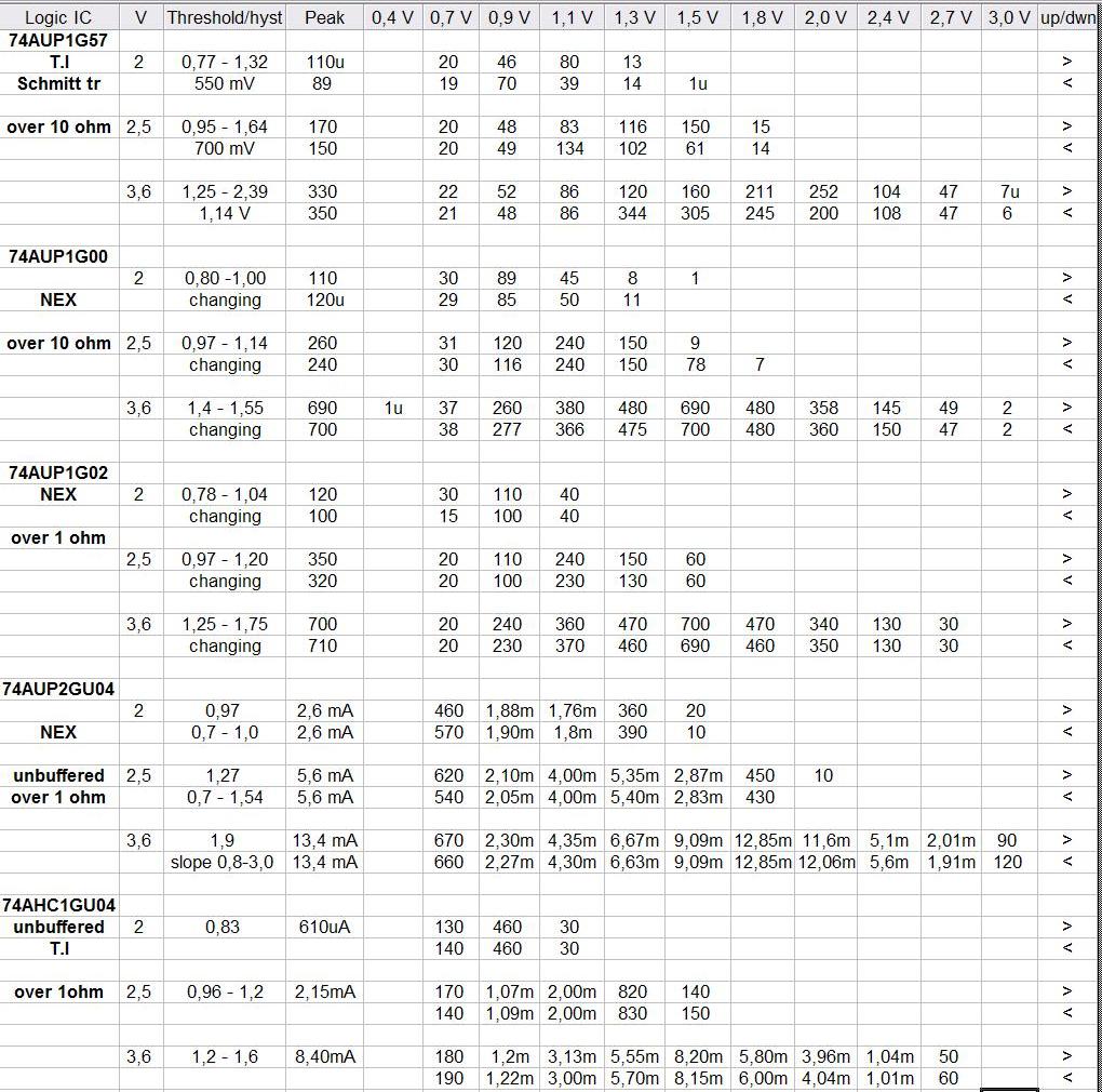

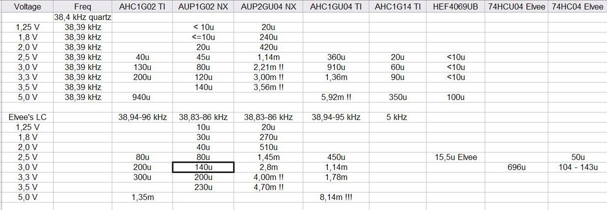

Well I've finally received all my AHC/AUP 1 gate logic to make a 38 kHz oscillator
for the IR remote . High hopes for low power AUP , for constant running quartz or
fast on/off with Elvee's LC oscillator.
The quartz osc was disappointing . I expected better , especially after good results
with frequency tests on gates and FF's in AUP , AHC (and HCS).
The AHC and AUP are on different regulators : 1,25 to 3,5 V (for AUP) and 2,5 to5,5 V (for AHC).
1,25 to 2,0 V and 3,5 to 5 V are just for information . Important is 2 x AAA range
of 3,3 to 2 V.
None get near the HEF4069UB , I rechecked them again to be ultra sure (but with
32,768 kHz Xtal).
By far the biggest disappoitments are the GU = unbuffered ! Just like Elvee's HCU
test , but these are worse ! I don't get it.
The quartz freq is the same for all devices and supply voltages .
The LC differs a little between the devices , but not more than 20 Hz from high to
low voltage. I used 1nF + 1nF + 150pF on input and 10 nF on output , 38,8 kHz
was close enough for testing. Stuck with the 10mH and 28k resistor.
While I read that Schmitt trigger inputs are not posible with quartz , I tried it
anyway with AHC1G14 , and it works for 38 kHz with the "cleanest" 50,2 % DC.
The LC and a 20 MHz Xtal did not work , but that could be the RC's around it , I
used ?
Although I'm going to try ST AUP's like 57 or 58 , maybe even a HCS04, which
may be a little better than the best so far : AHC14 , with quartz , I'm think I'm not
going to get better than the 4069UB and 60u at 3 V is not acceptable with AAA
bat's.
Elvee's LC is looking better and better despite the big 10mH . With an on/off delay
of 250us , and consumption not that important , this could be the one.
Like I said : Unbuffered are a big disappointment , even with a 20MHz xtal the numbers are awful. Luckily I didn't buy much of them.

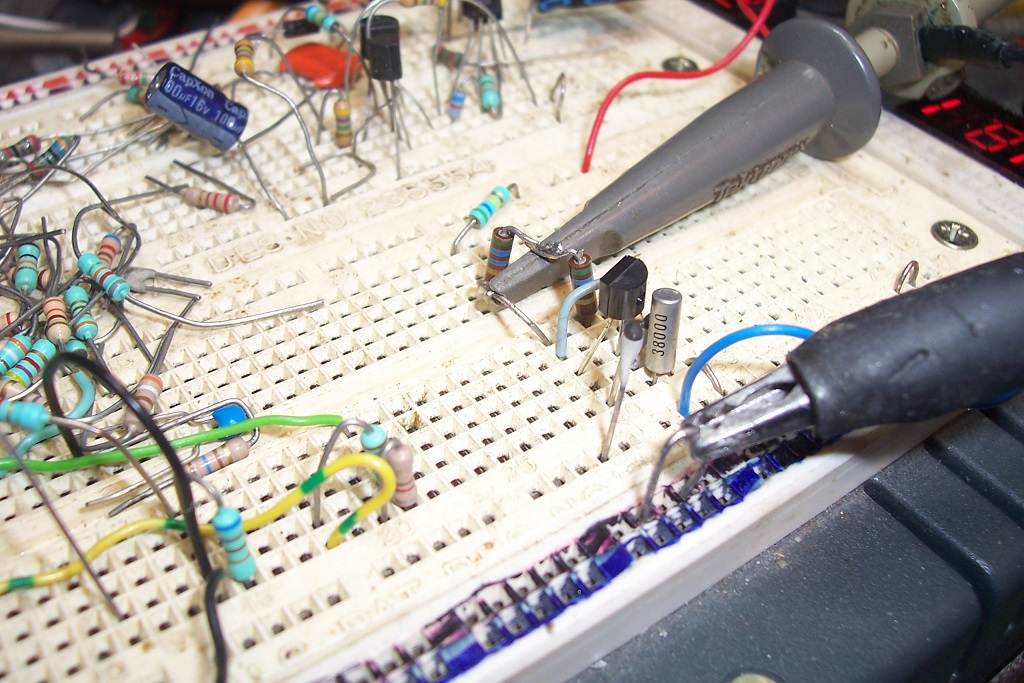

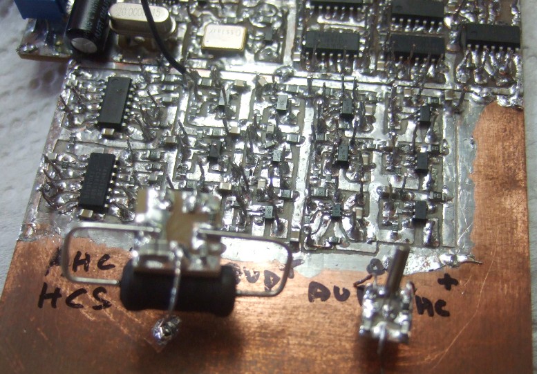

The pics are of the test PCB , with the 2 little mobile boards so that they all had the
same components , and I only had to make 2 , to test them all. (3 with the 20MHz)

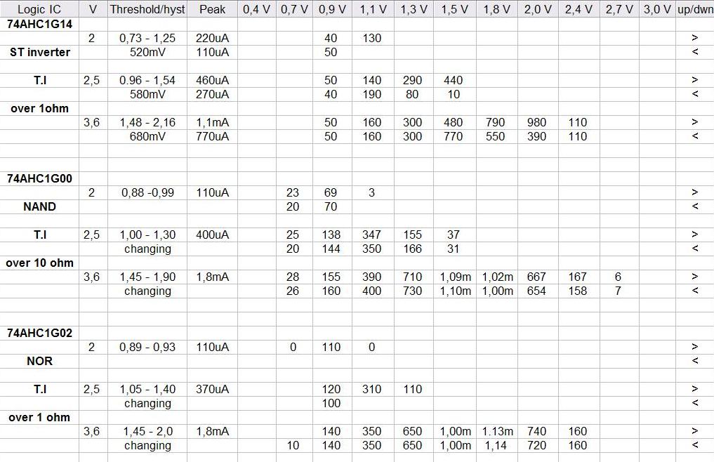

All measured over 1 ohm R , so rounded numbers below 10 uA.
Results look disappointing, but from your POV: these gates are logic gates, designed primarily to deal with logic signals. They also work as oscillators, but are not optimized for the task.
In fact, even the 4069 is not really optimal as an oscillator: the oscillator gates of the 4060 do much better, in terms of current consumption and difficult crystals.
Gates with hysteresis are normally not suitable for linear oscillator, at least in the regular, Colpitts configuration. You had some luck, but don't count too much on it.
I remember that Elektor had published a 32.7K oscillator circuit based on a schmitt trigger gate, but it had serious adaptations to deal with the hysteresis. It was in the late seventies/early eighties. It should be possible to dig it out.
It don't think the principle would easily be applicable to the LC version though.
The 74HC04 would have been ideal for you, as it is specified down to 2V, but you have 5 useless operators as an unwanted present....

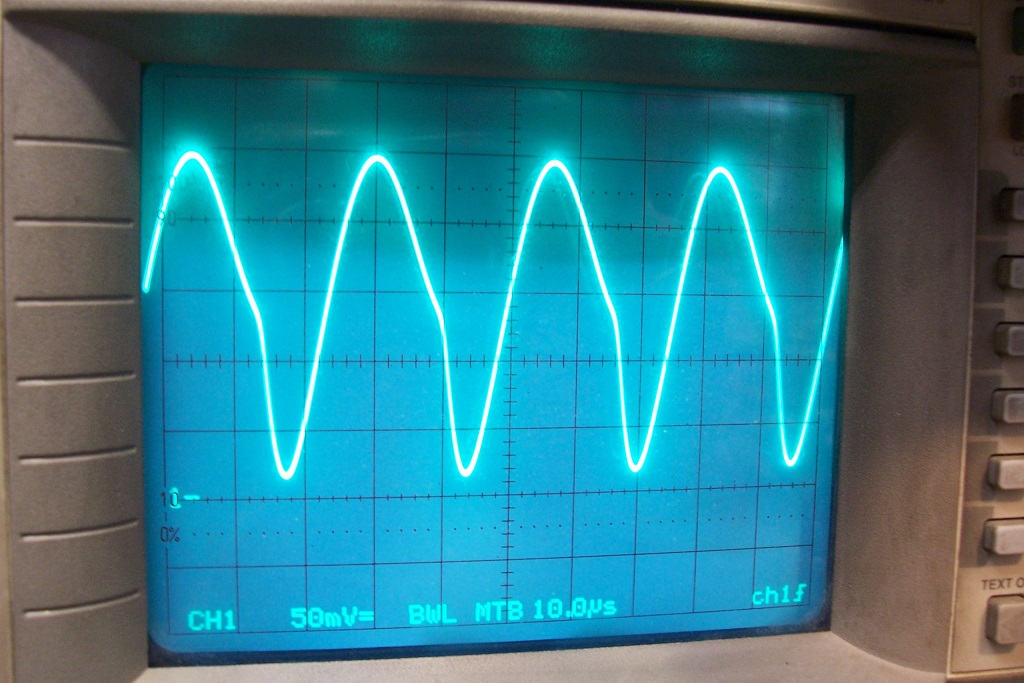

The problem with a Schmitt-trigger crystal oscillator would be start up.
Crystal oscillators usually start with noise or with some small ringing caused by the power-up transient. The oscillation gets undamped by the amplifying part and keeps growing and growing until some non-linear effect, such as amplifier clipping, stabilizes the amplitude.
With a Schmitt trigger, when the signals are smaller than the hysteresis, it doesn't provide any gain. It therefore can't start from noise. You would need to get the crystal to oscillate at a high enough level to overcome the hysteresis before the Schmitt trigger can take over. It's the electronic equivalent of a pendulum clock that needs a push to start swinging.

There are much smaller 10mH inductors, but they would probably result in a less stable oscillator: the open, resistor-like ones would have a higher series resistance, meaning a lower Q, and those covered with a ferrite sleeve would be more dependent on the ferrite properties.
If you find one, you can test it anyway, and it doesn't need to be 10mH: you can scale the capacitors value to arrive at the correct frequency

That is right on the money Marcel .
I just tested AUP1G57 with ST inputs and I had to vary the supply voltage to make it (the quartz) start. Sad because it draws little current.
With one of the inverters of HCS14 it started but at 3,3 V it stalled .
The 20 MHz oscillator and Elvee's LC won't go with either and AHC1G14 although the LC worked on the HCS14 above 3,3 V.
Well I can't order again from abroad , just received the mouser and TI goodies which should last me a year or so.
My local webshop has limited offerings in that range and in small size.
And with all the 'goodies' , I'm overwhelmed in work , to go find something in the boring Elektors that probably won't help me much.

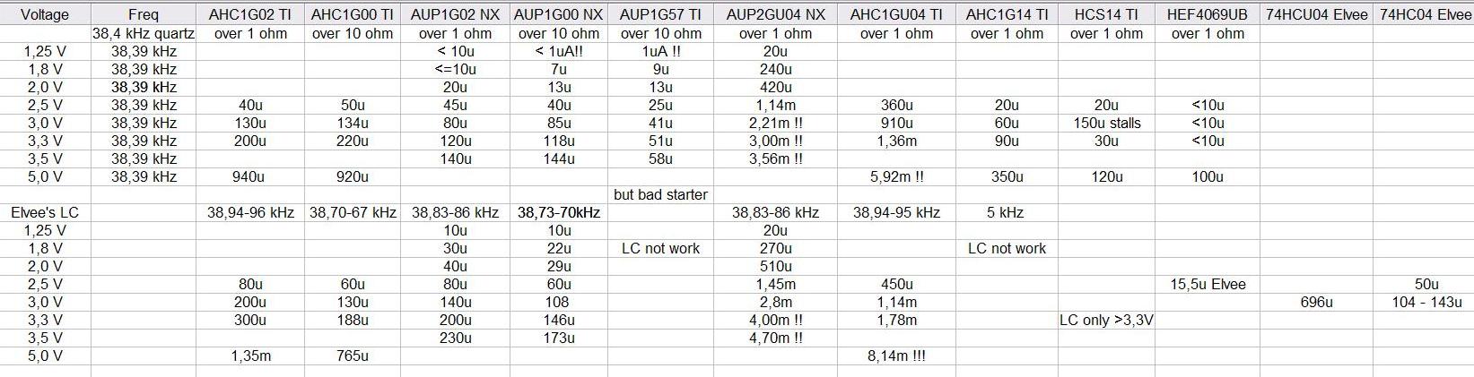

Some more of today. I should have done them all over 10 ohm , or at least the ones for the 38kHz oscillator , but measuring current and levels at the thresholds , I wanted only a small drop in supply voltage and for the higher current draw at high frequencies.
AHC1G00 and 02 and AUP1G00 and 02 are not copy and past , these are very close , rounding errors 1 or 10 ohm and slightly different supply voltage variantions.
AUP's at 1,25 V , yes =<1uA , verified with a AUP1G80 D-FF to be sure it was still oscillating. 13 uA at 2V ( 3V - 2 diodes , for the turbo ) is doable BUT if its output goes to a gate on the full voltage , this one will draw some current too because its input will be nearer to the switching point.

Today I tested the limits of the good old 4069UB . I made some changes like better
measuring over a 10 ohm R and a lower supply voltage for a better re-test.
The HEF4069UB starts with 32,768 kHz Qxtal at 2,5 V and stops al the way down
to 1,6 V ! At 2,5 V it draws 1uA ! at 2 V below 1 uA , the DMM display stays at 0.
This is with 2 of its buddies as buffer and connected to the input of an LVC1G17. Amazing !

If you wanted to confirm why the unbuffered consume so much more current , just compare the current draw with rising of falling voltages on their input.
While the 'normal' ones top out at around 700 uA (AUP at 3,6 V) , or 1,8mA ( AHC at 3,6 V) , the 2 unbuffered go to around 8 or even 12 mA . They do have nice slopes, not like the regular that have a weird changing ( or oscillating ) part near their switching point or rather switching area. (Added the 2 Schmitt triggers to compare , clean switching at an even lower current draw)
This makes me think: why are we sweating with logic gates when there are other options?
One that was hiding in plain sight, is perfectly obvious yet escaped us both, is the good'ol discrete oscillator:
It took a minute or two to test it:
And here is the result:
Current consumption: <3µA!
You can leave it on permanently without any problem

Sure discrete could be an option . I was never into those because I don't understand how they work. While going over the Elektors , I ve seen a few discrete ones , but didn't copy them .
I'm surprized you have a 38 kHz quartz ...
Not an everyday item. I was (am ?) 90 % sure I would use your LC oscillator.
Looking at your design : R2 130Mohm ? Transistor can be a BC84x one ?
Oscilloscope pic is with a 1:10 probe , I hope ? A ST gate will clean that up , not that I expect much better from a 4069UB output.
Worth a try ! Thanks .
