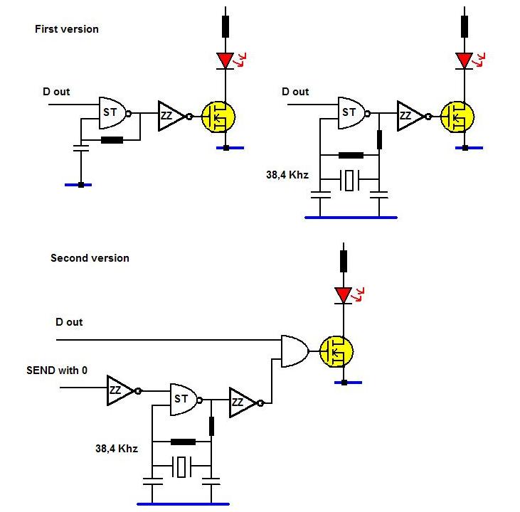

I hadn't ignored Mark's idea , but discrete was not something I could do.
I was thinking more like 4007 kind of discrete , but like the Elektor pic shows , it is not that good , and I don't have an 4007 .

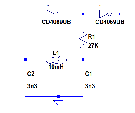

Now don't go putting too much time in this Elvee. I'm pretty sure your LC oscillator as an on/off one will win.

As shown, the 4007 is used just like a 4069, and will suffer the same ills.
It would be necessary to use the individual transistors in a non-complementary configuration, but I don't think it is worth the trouble.

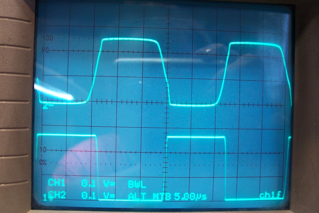

This is the waveform, measured with an active probe having a capacitance <1pF:
attachment.php
The amplitude is a bit smaller than with the 2N3904, but it remains acceptable.

Therefore, your best option remains the LC oscillator

With Elvee's LC on/off one , I can get the whole job done with 2 little logic gates , and a third for the ~ 250usec start delay. 99.99% of the time it will consume 1uA or so , as remotes are dormant most of the time.
