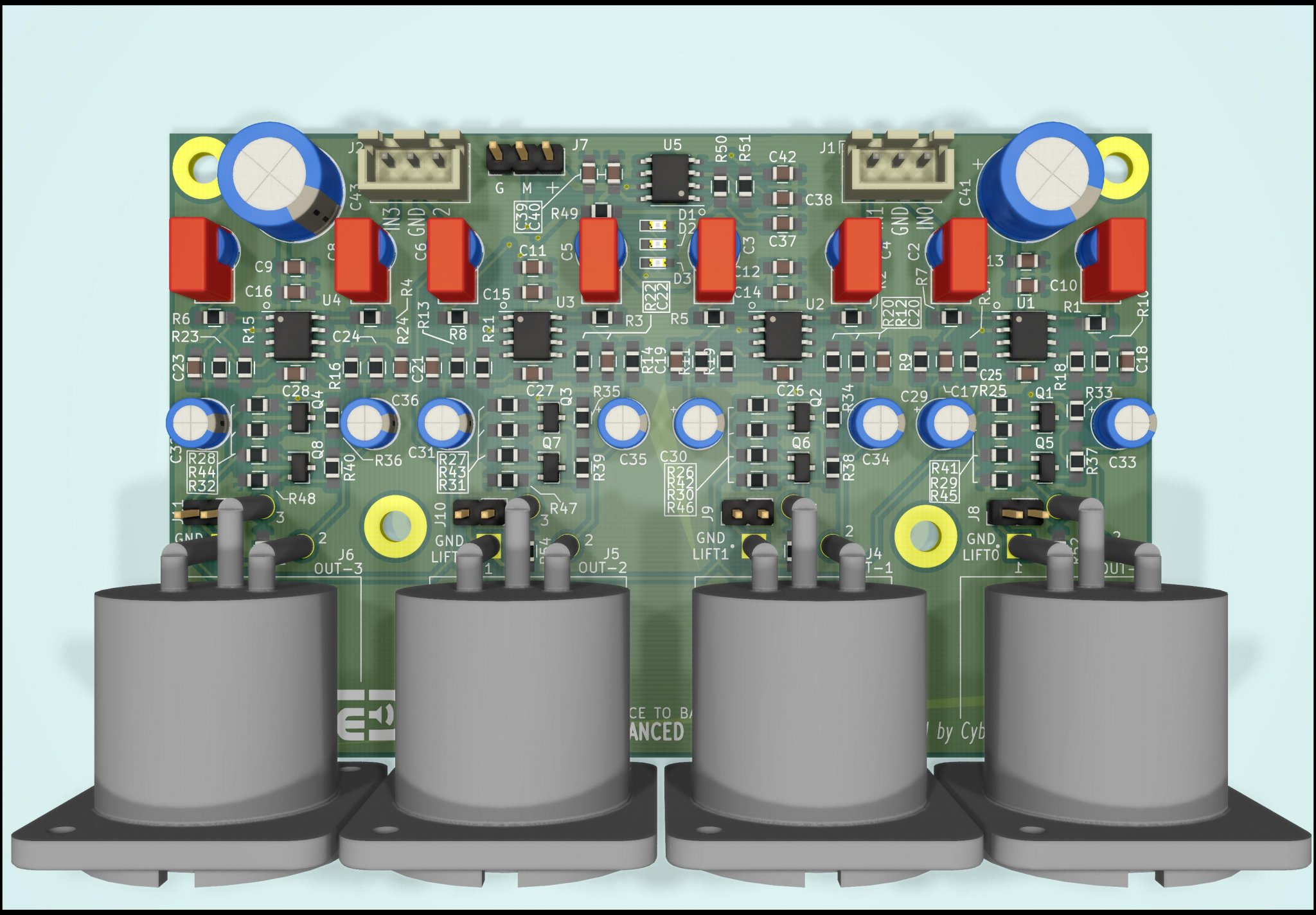

Hi Maurizio-San,
I guess you are expecting the much higher class system design concepts than such cheap DSP embedded codecs. Three times PA3 costs $360. It's too expensive for the mainstream Sunday DIY hobbyists. They are enjoying buying and connecting the $10 made-in Cina TPA3116D2 Boards or something like that at eBay or Ali-express. I guess you need much more audiophile-oriented designed DSP boards such as Shark, ADAU1466 with High-Class ADC, and DAC chips. Maybe your needs will not for this 48pin SoC capable things. It will be realized by another solution. Should be taken another way...
We should be much more focused on connecting digitally than Analog today. For example. A FreeDSP ADAT-IO-x4c enables to connection 8 channel I2S signals via a single cable. My TAS6422 Amplifier board has the capability to connect I2S directly via HDMI-Cable. There are no losses even if using a long cable. Should be connected digitally between DSP and DAC (or Class-D amplifier which has digital inputs) is my current idea for higher class approach. (Not this project)

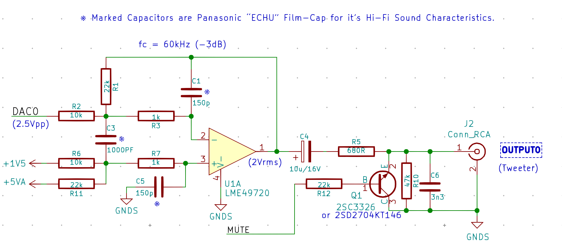

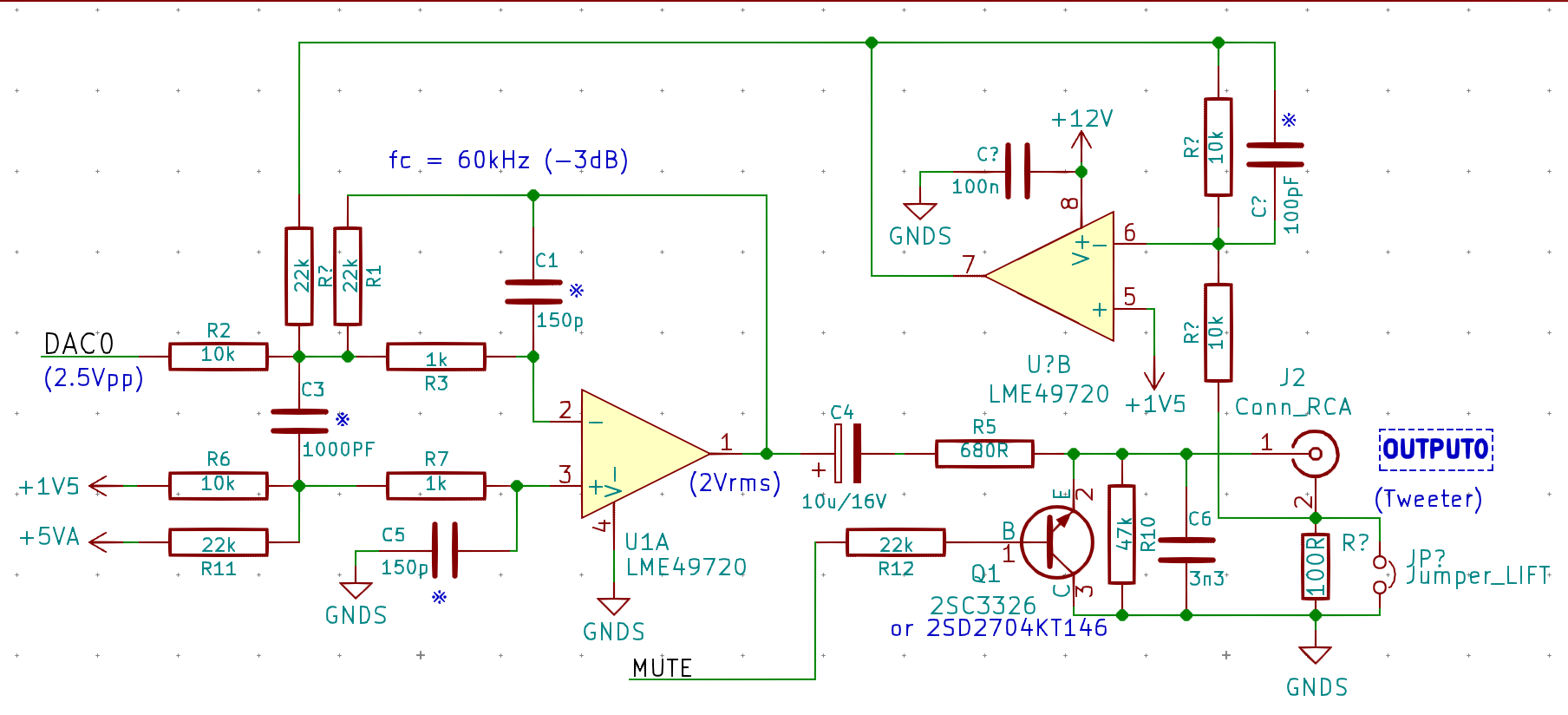

Anyway, I designed a new output circuit idea for RCA output. A differential output circuit with GND loosen (not completely lifted) enables to eliminate ground-loop hum noising. (Maybe, not tested yet).
Current MFB LPF Output Circuit
A new Idea, Differential Output Circuit
This circuit will act as Common-mode Choke for the target amplifier.
If I implement this, perhaps it take much more time, Because there's very little space around this part...😱

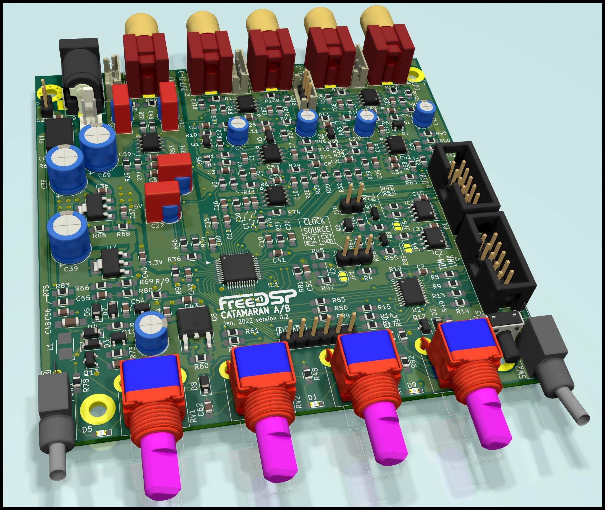

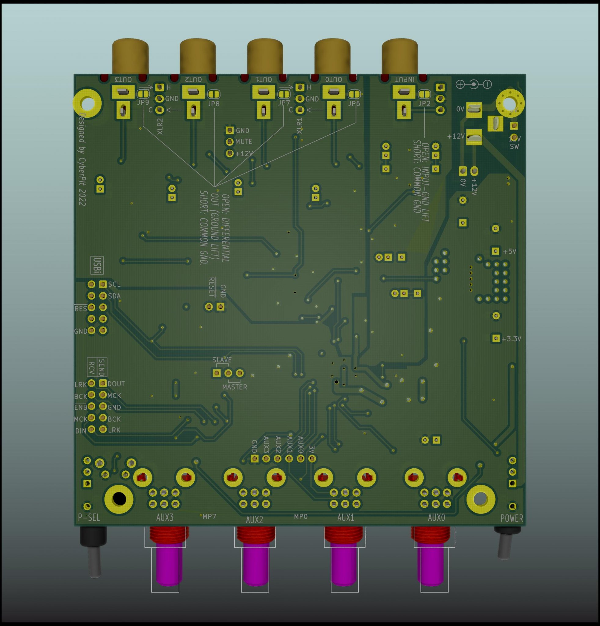

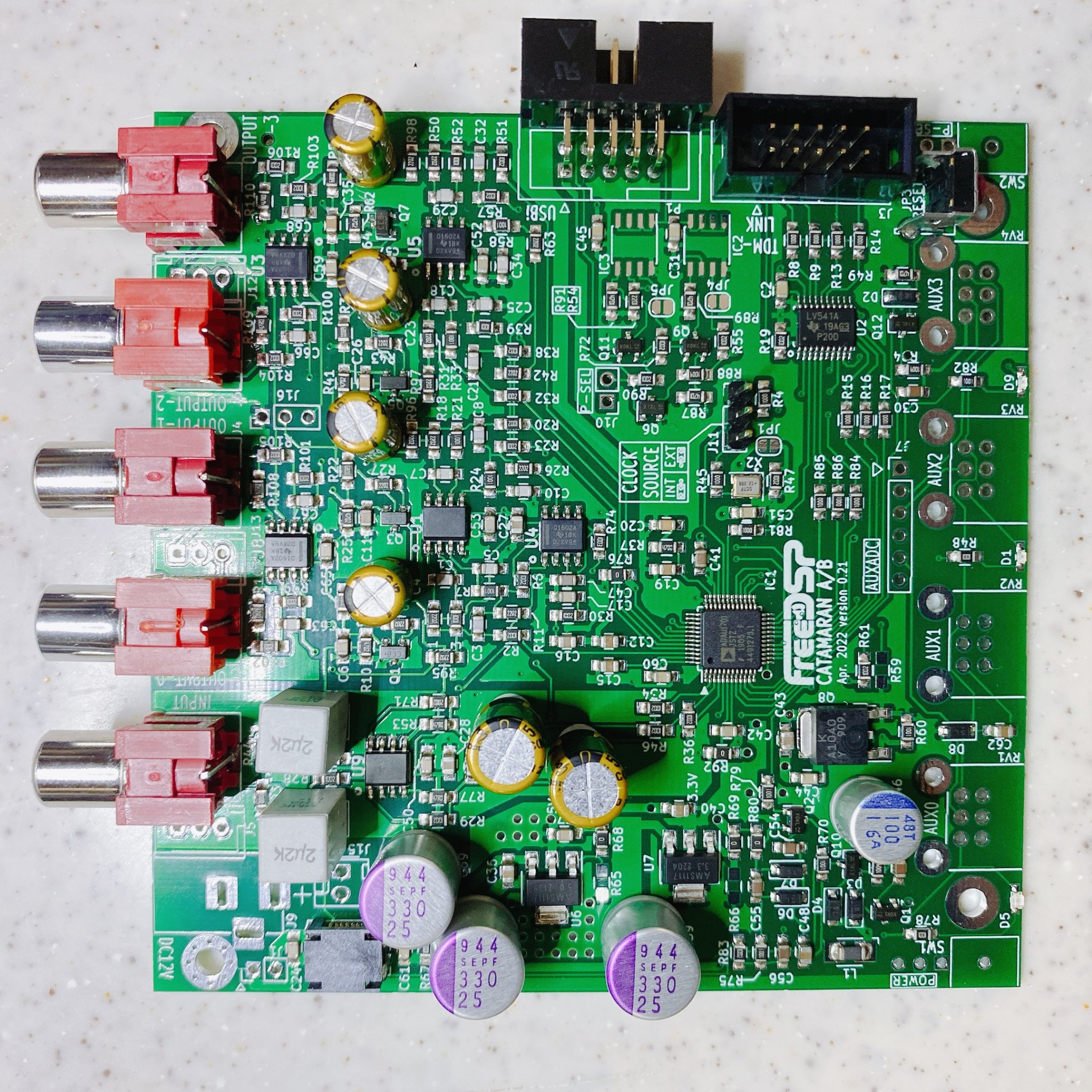

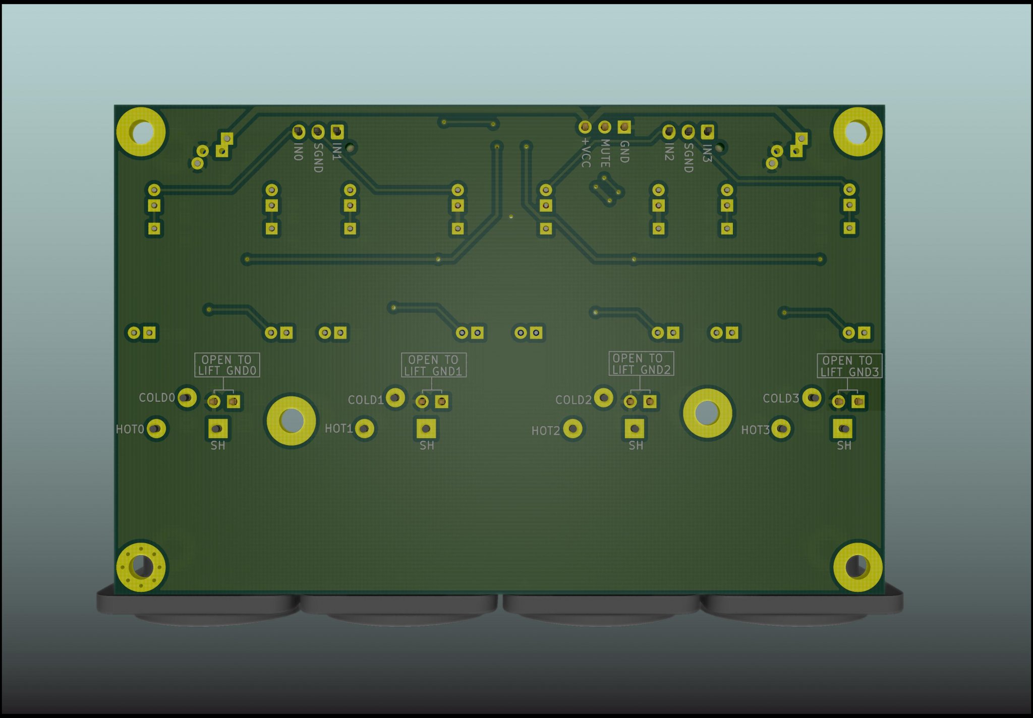

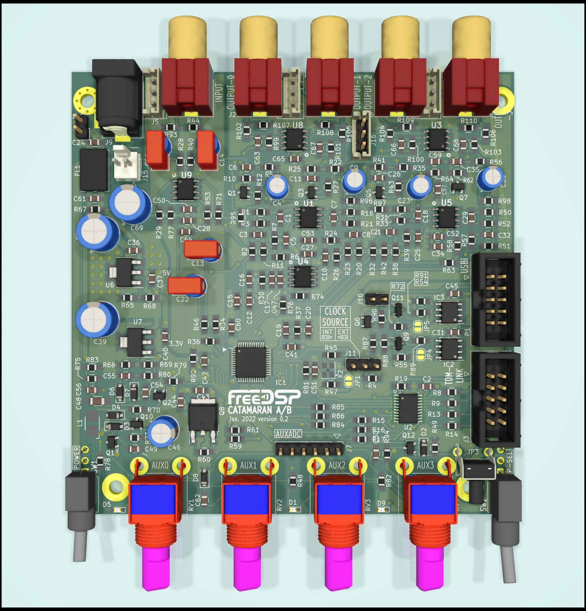

Hello DIY folks!
Now I complete the design of FreeDSP Catanaran A/B and its optional Balanced output Board.
Here's version 0.2 DSP Main Board

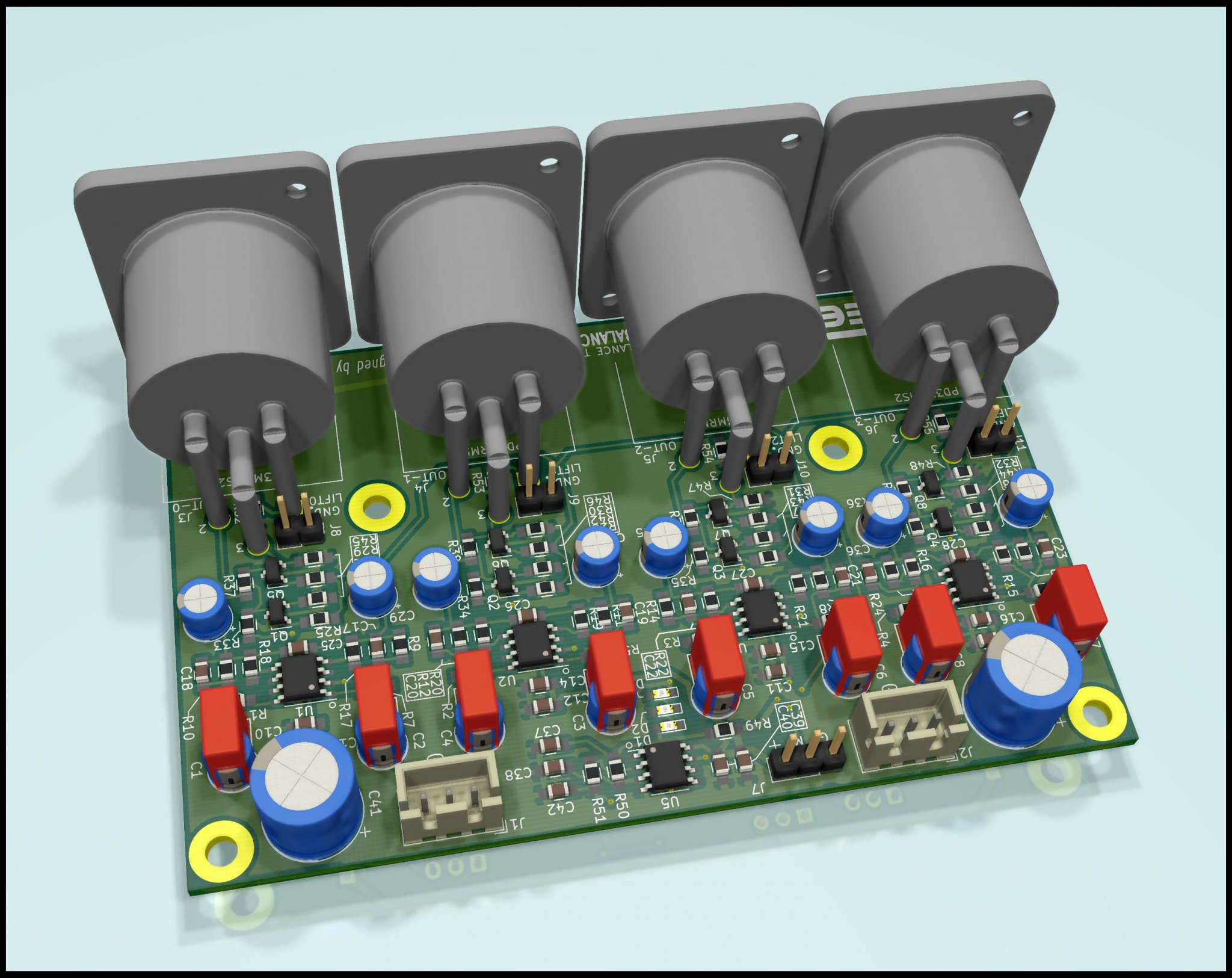

And an optional Balanced output Board.
Now assigning PCBA parts for JLPCB...
CyberPit
CyberPit

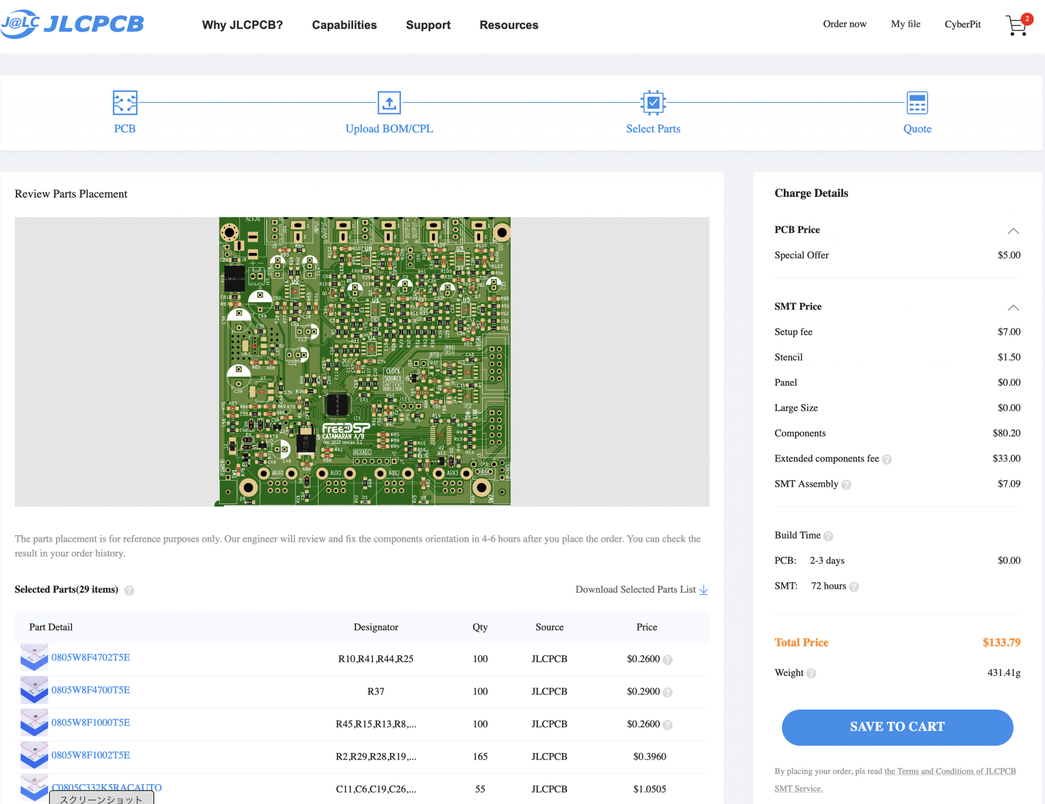

Joined 2018

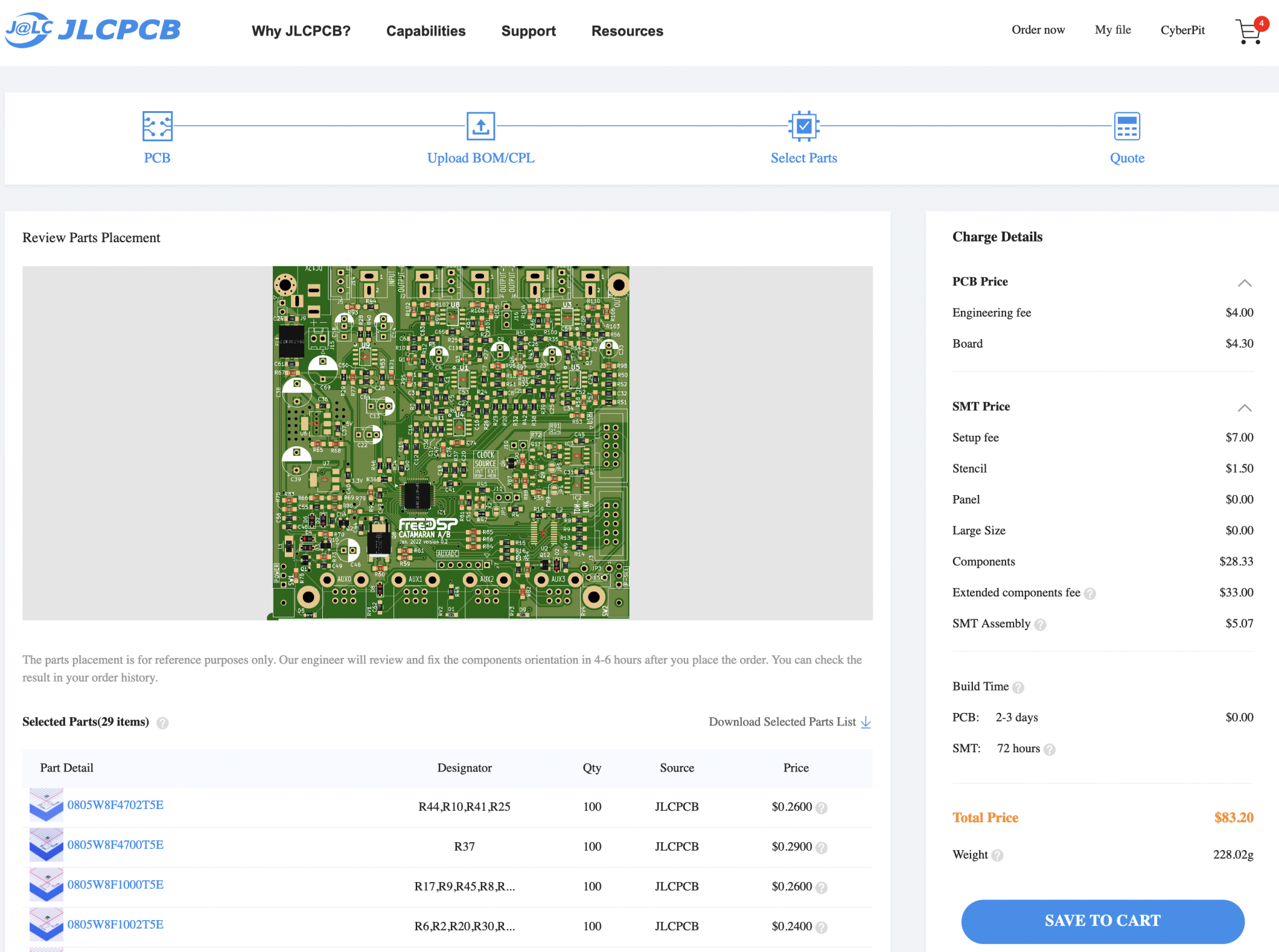

Thanks, Piersma-San
I just estimated Board and SMT costs at JLPCB.
It costs 83.2USD for 2 SMT boards of 5 bare boards.
USD133.79 costs for 10 SMT boards.
Shipping costs and shortage of stock parts (EEPROM and Muting-BJT) are not included.
You need to order other these and all through-hole parts and mount it by your DIY spirit😉
Special thanks to Maurizio, you inspire me with seviral ideas.
CyberPit

I found a mistake in the Optional Balanced Driver Board BOM.
From U1 through U4 should be OPA1632. PCB design is no need to change.
The attached files are for corrections. (Git-hub is updated already)
CyberPit

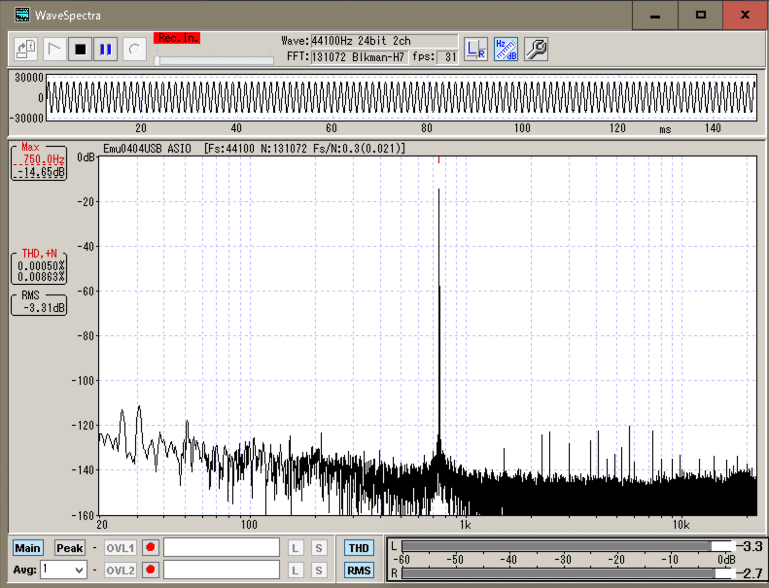

Joined 2018

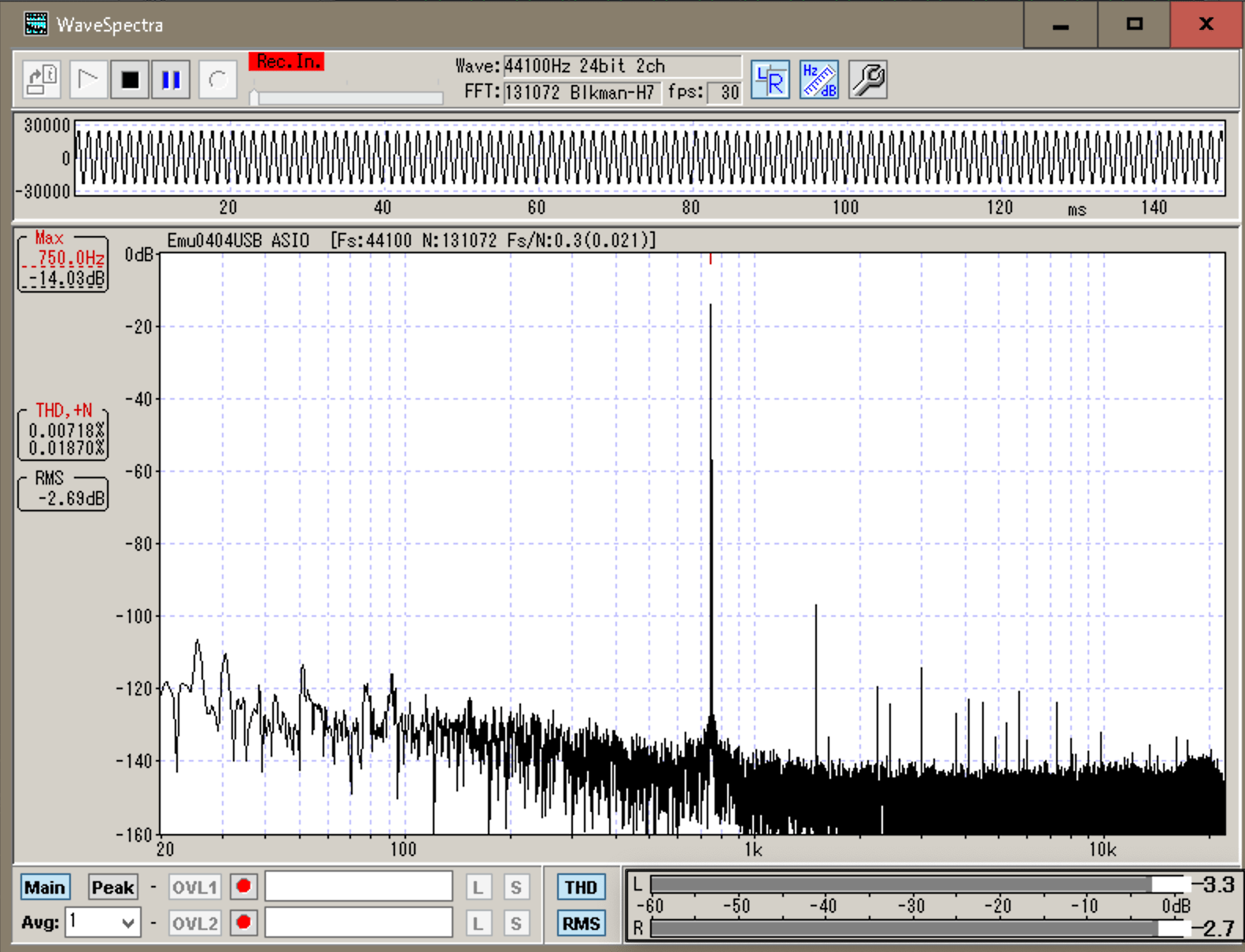

Now I'm in the evaluation step of FreeDSP Catamaran A/B.
There are some parts that need to change, so please wait for a while if you make...
The attached spectrum graphs are overall audio performance (ADC->DSP-DAC)
The left one is Single-Ended mode, and the last one is Differential ADC mode.
Extremely low distortion and cheap embedded DSP codec had realized... 😎
CyberPit

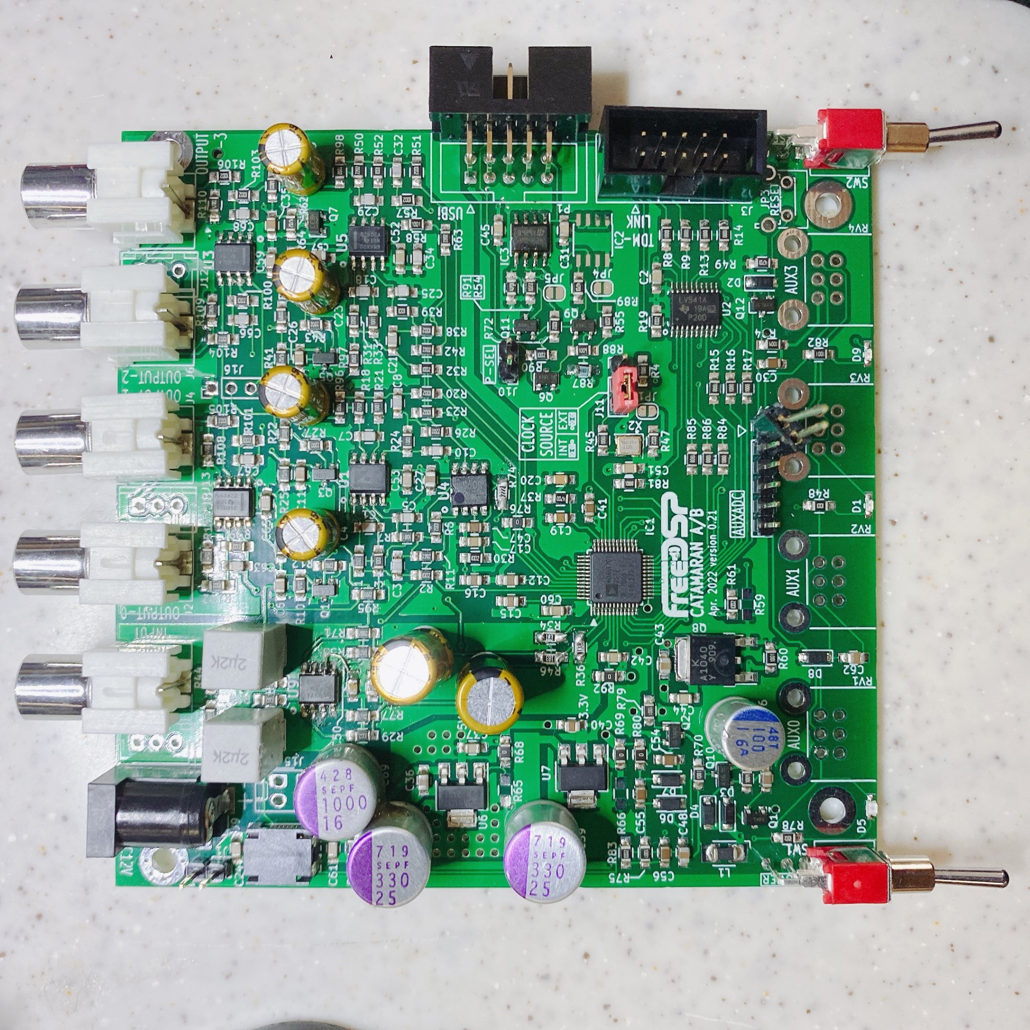

Joined 2018
Now I have completed version 0.21 board hardware evaluation.
Issue fixed release version 1.0 design files and JLPCB PCBA order format files are committed to the FreeDSP Git-Hub page.
4way Stereo Crossover Divider and 2.1chnnel 3way Crossover SigmaStudio project files will be ready soon...
CyberPit

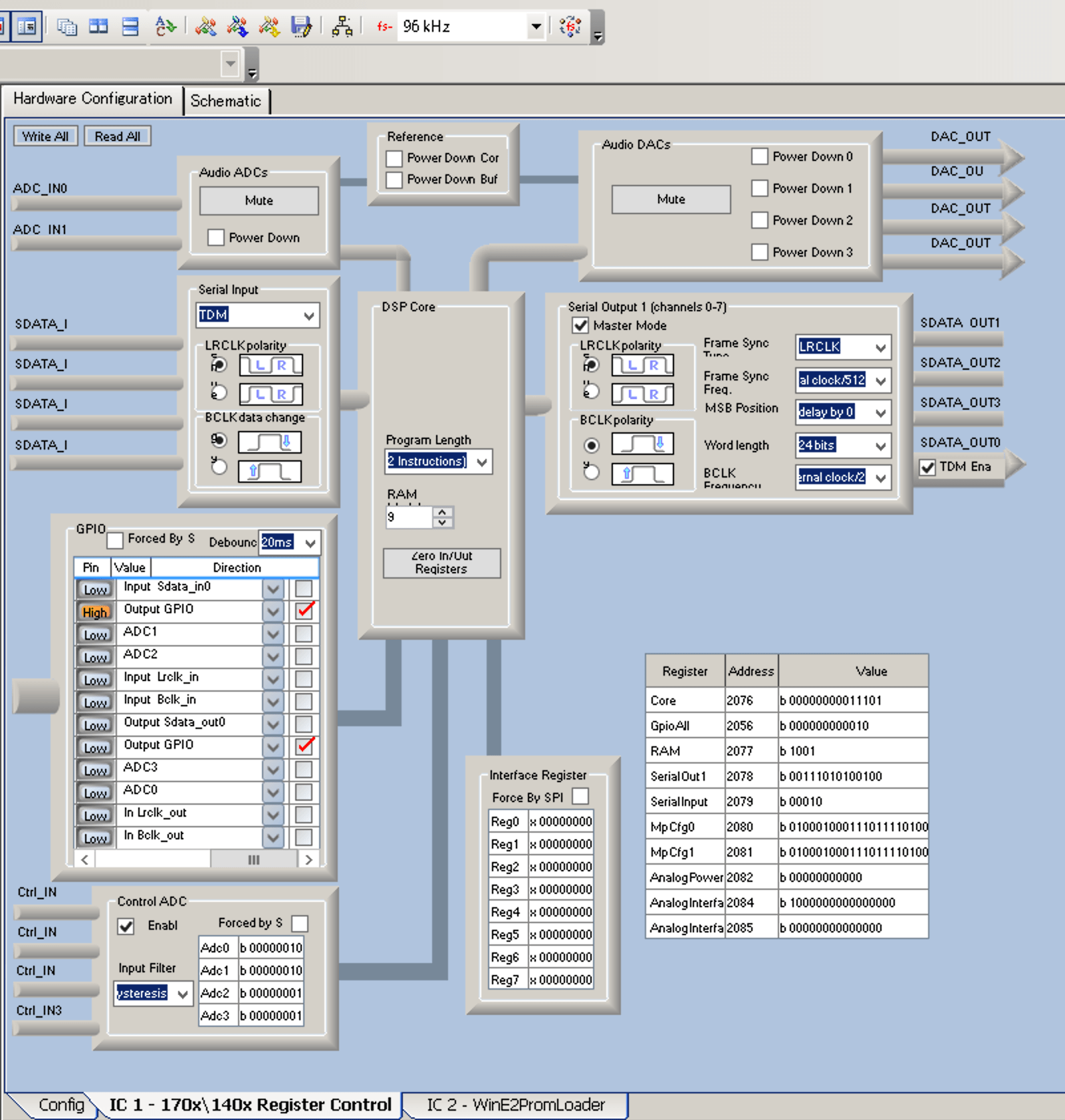

Joined 2018

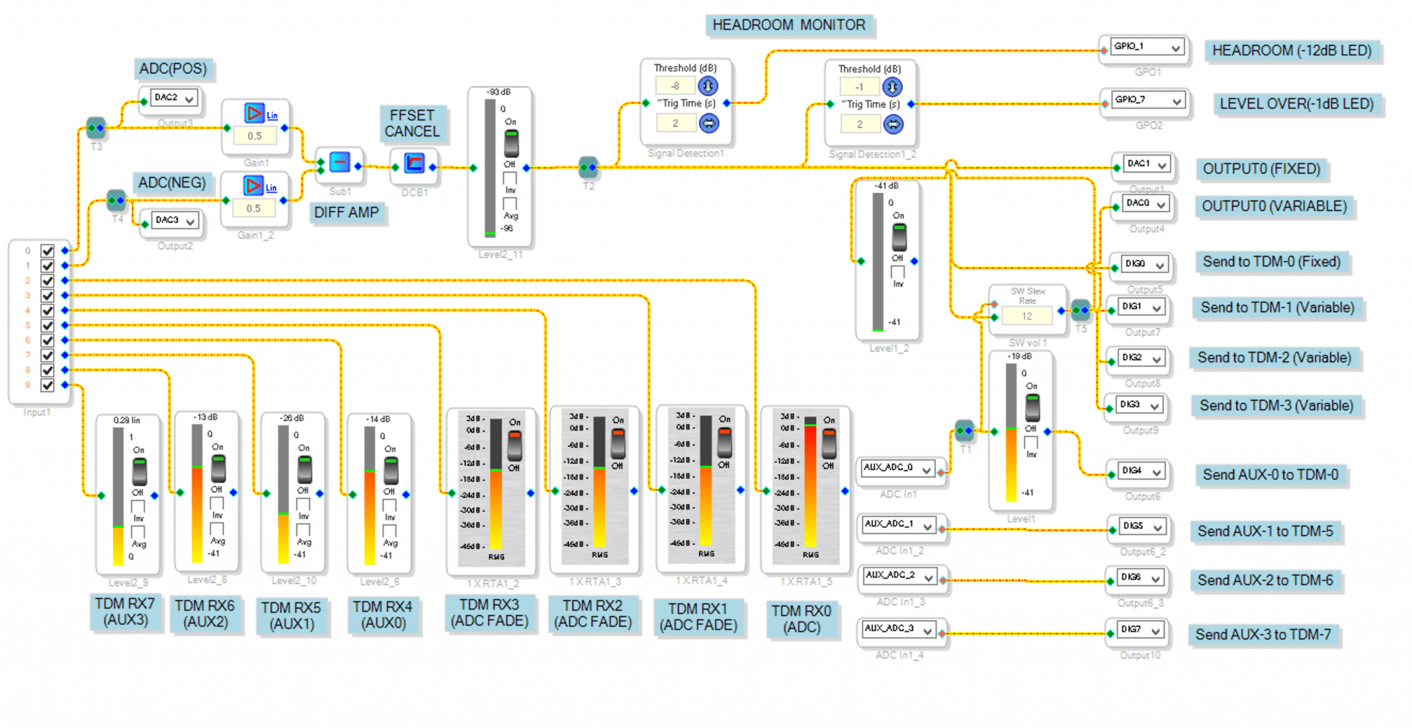

HI Maurizio,

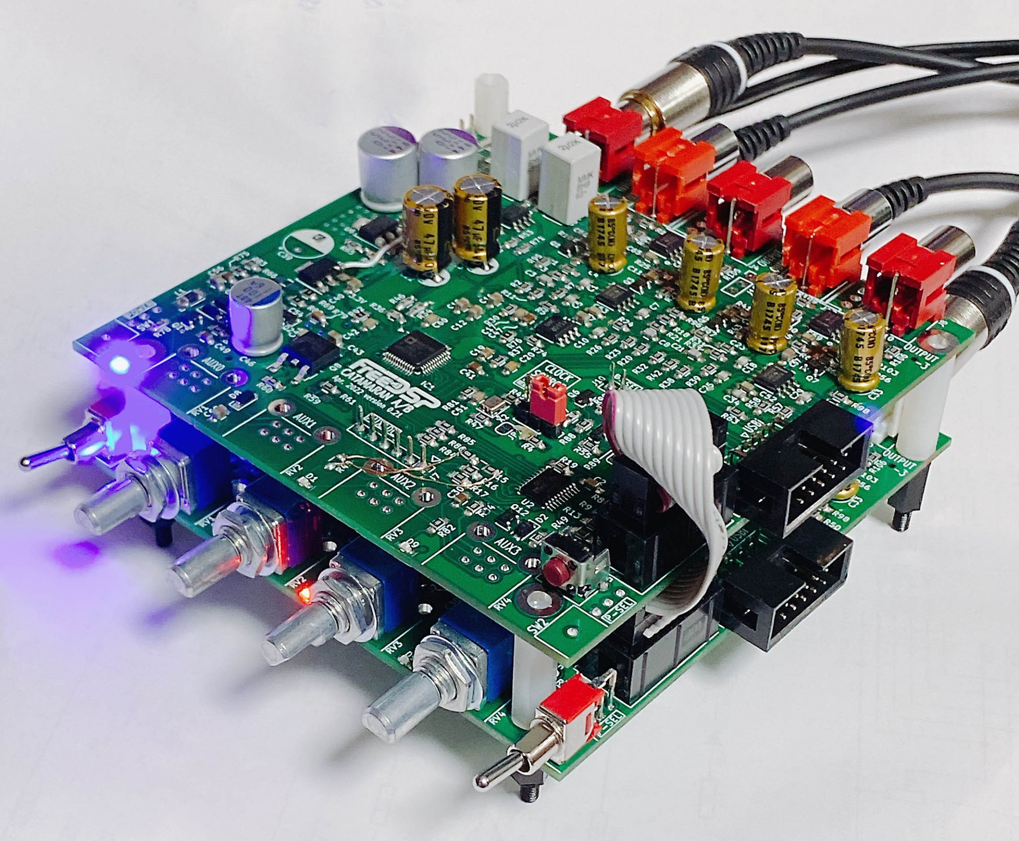

The attached image is my current evaluation setting. (fs=96kHz, TDM8 Interlinked, 4 Audio + 4pot information))
An Independent USBi connector is provided on each board. So you can write Master or Slave configuration firmware separately.
A/B program selection is linked via the strikethrough pin header.
CyberPit
No, TDM Interlink has 8 data slots. But it can be used only for Audio Data and AUX-ADC potentiometer positions etc... (Not for configuration)Is Sigma Studio detecting boards connected through the TDM interlink?
CyberPit
Hi Pit.
So..basically i can transfer the analog in of one board to the second using the tDM interlink right?
But..any board must be programmed separately...do i get it right?
Maurizio
Maurizio

Yes, you can transfer up to 8ch Audio streams to another board.can transfer the analog in of one board to the second using the tDM interlink right?
If you want to have a Master Volume or stereo tracked controls. You need to program the un-asymmetrical designed firmware codes. If you do not use TDM-LINK, you can download the same codesBut..any board must be programmed separately...do i get it right?
on both boards.
CyberPit
