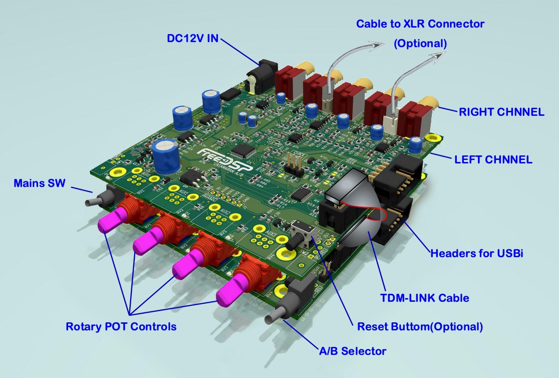

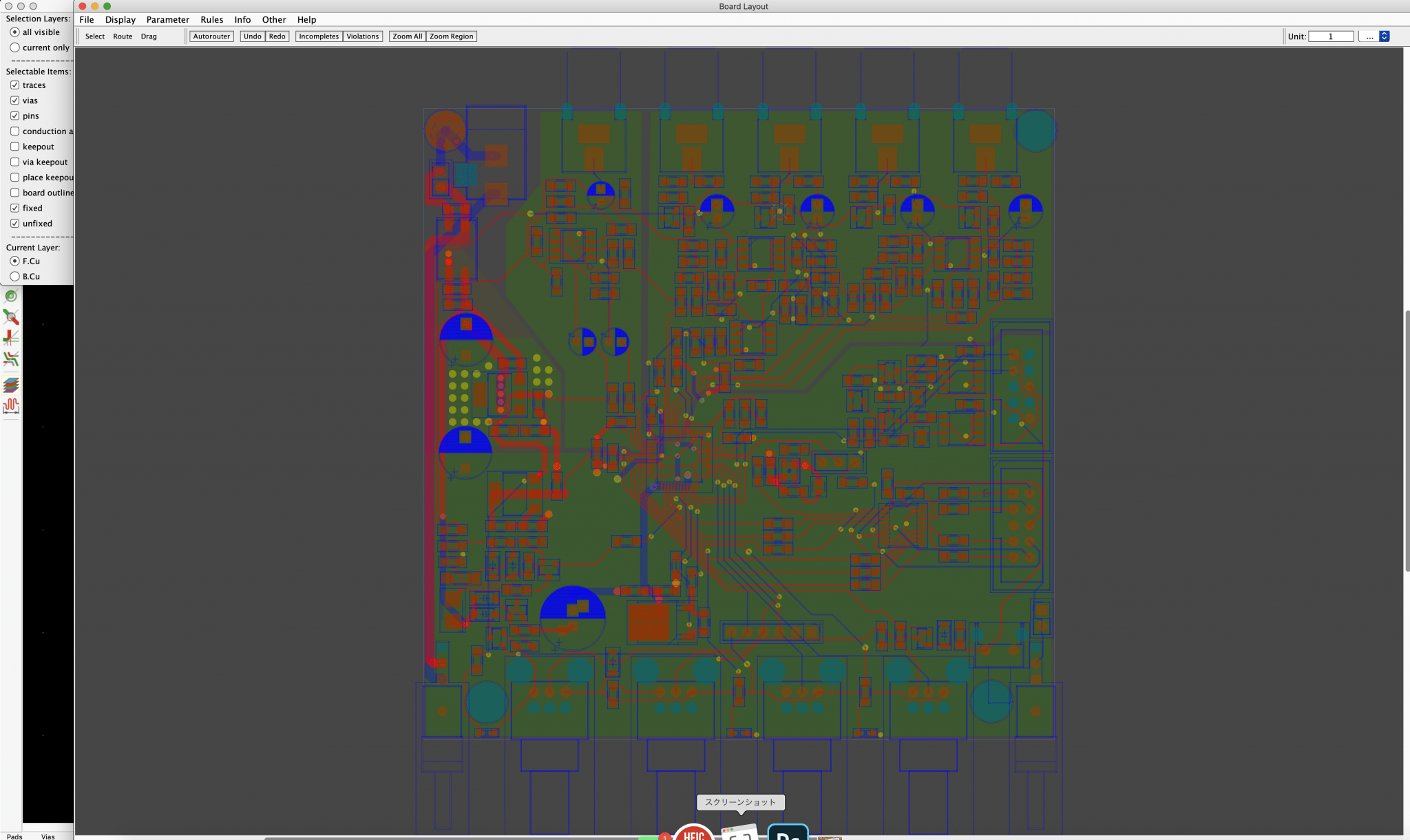

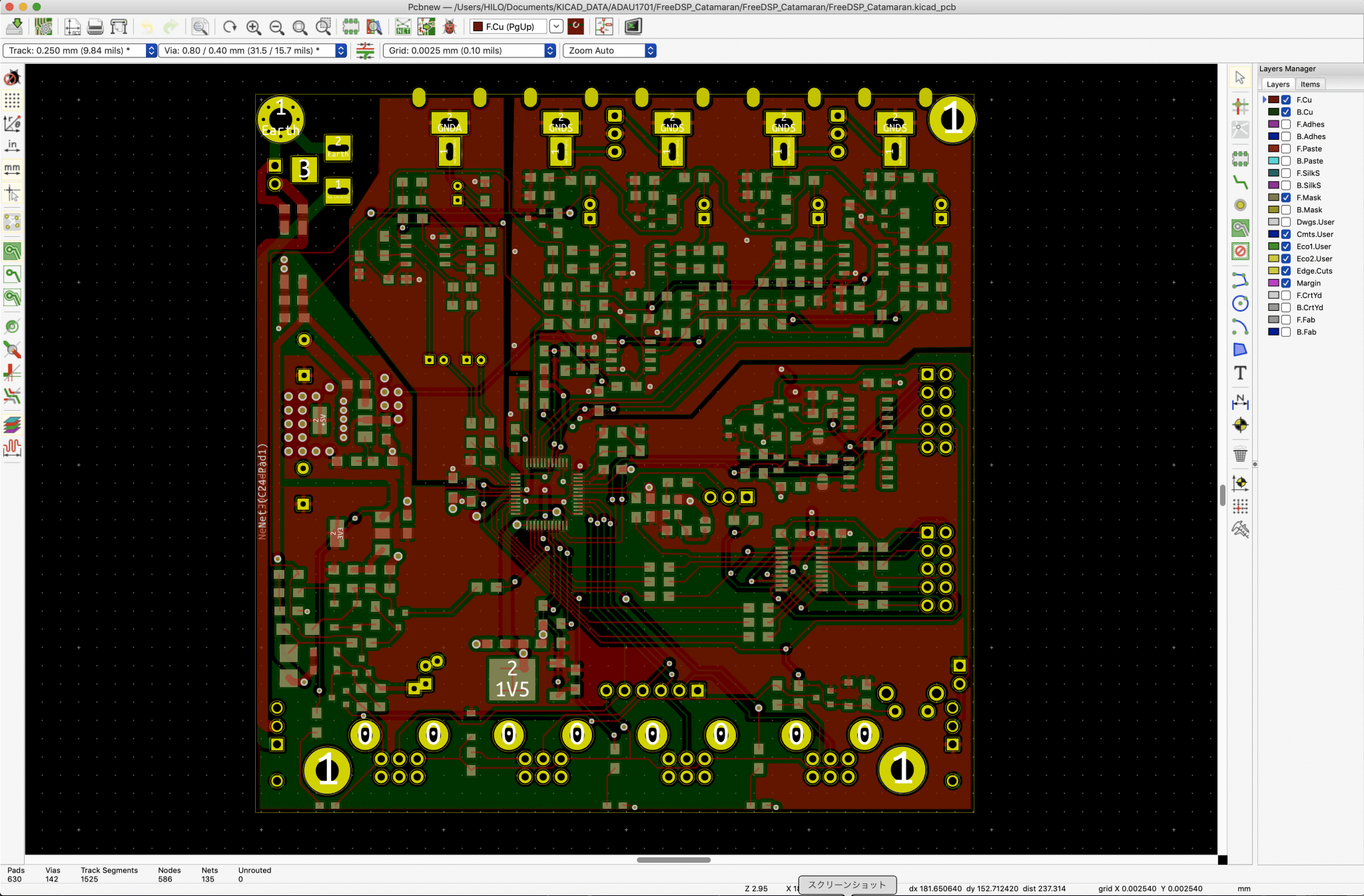

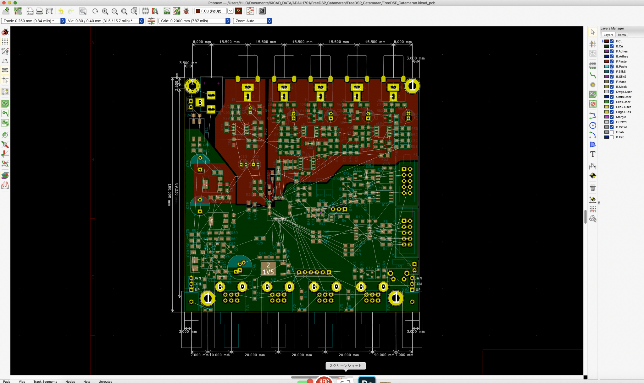

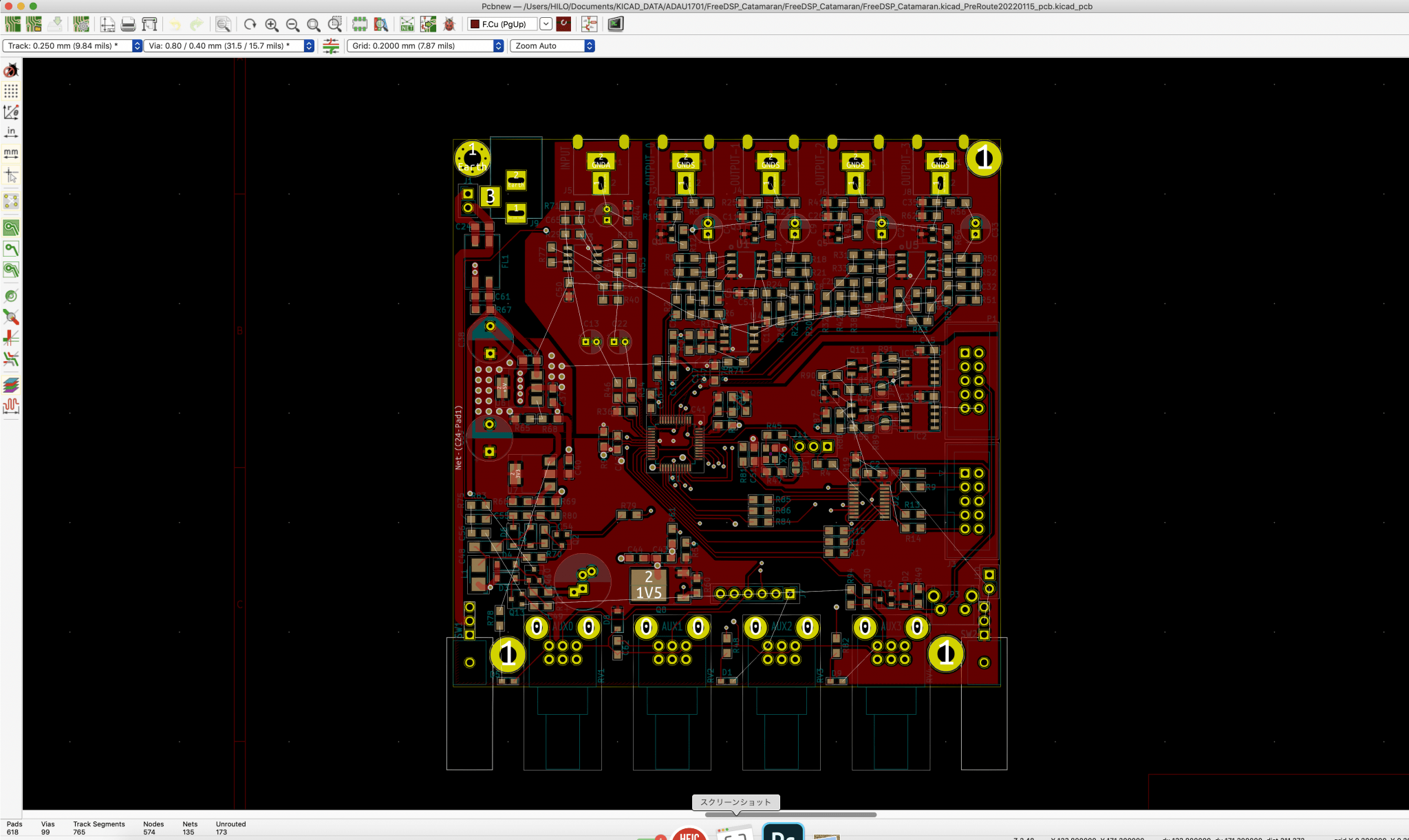

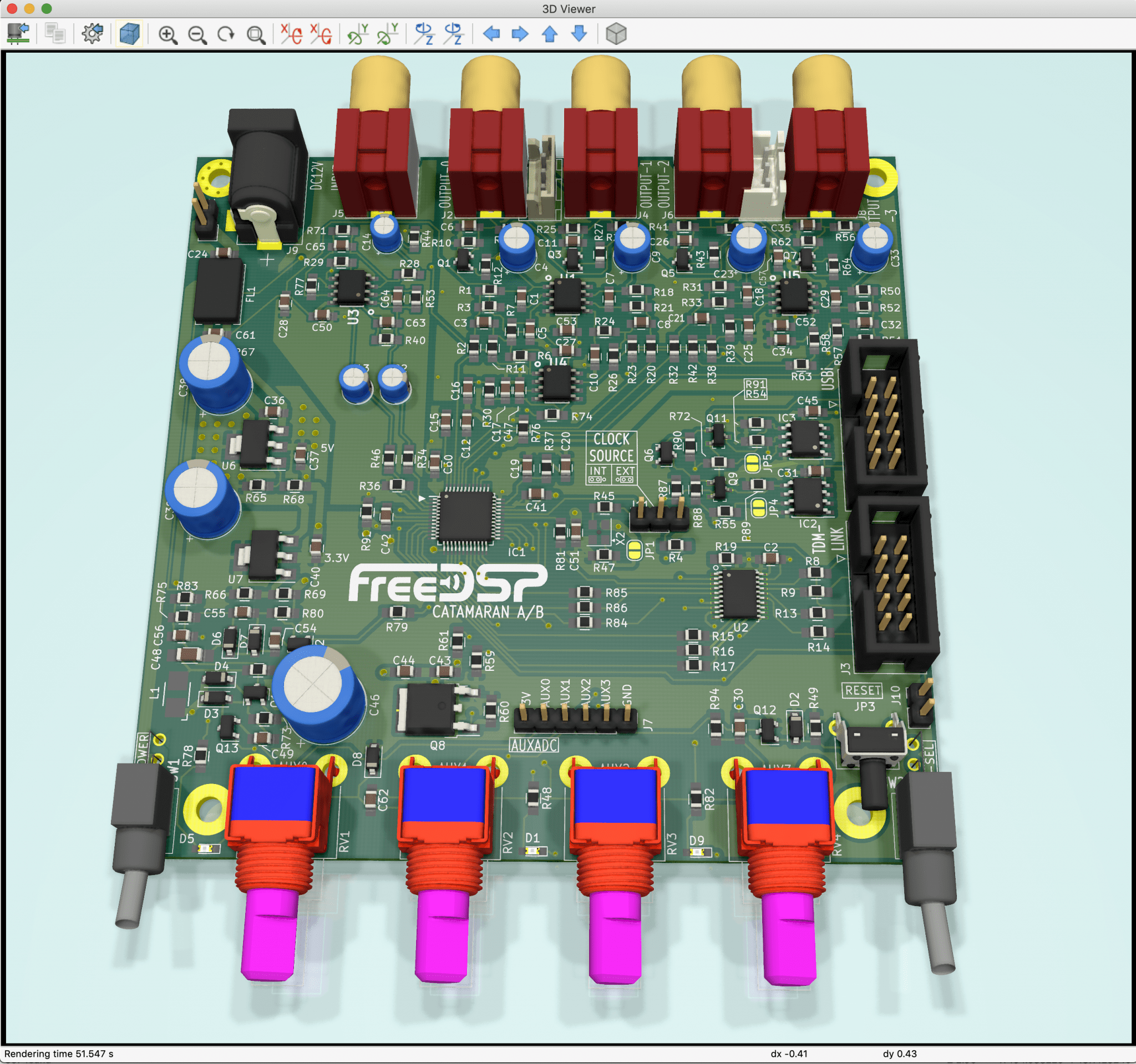

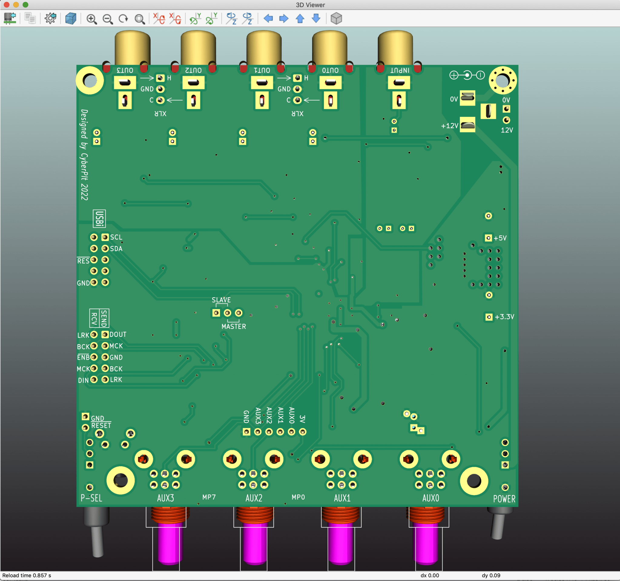

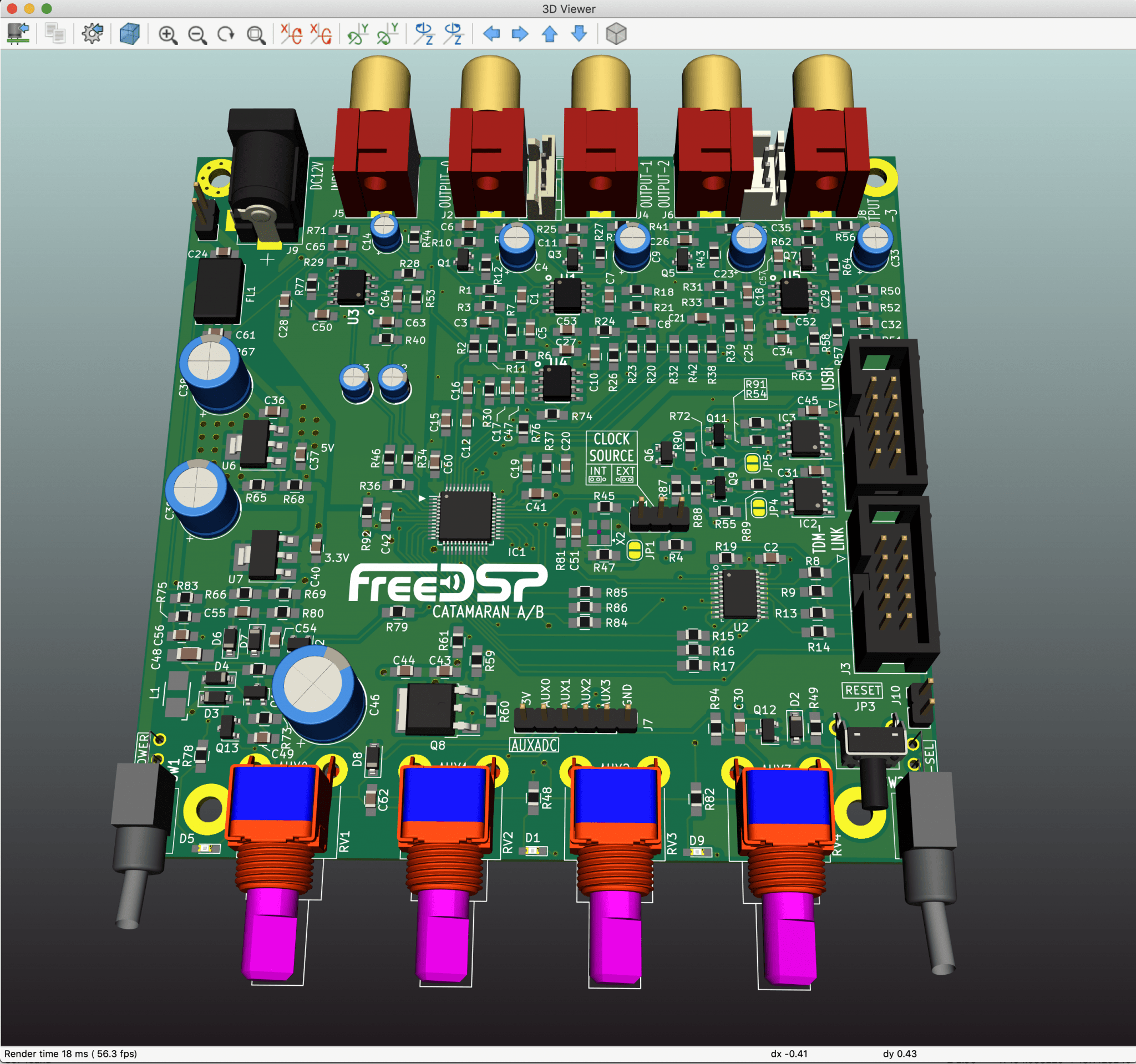

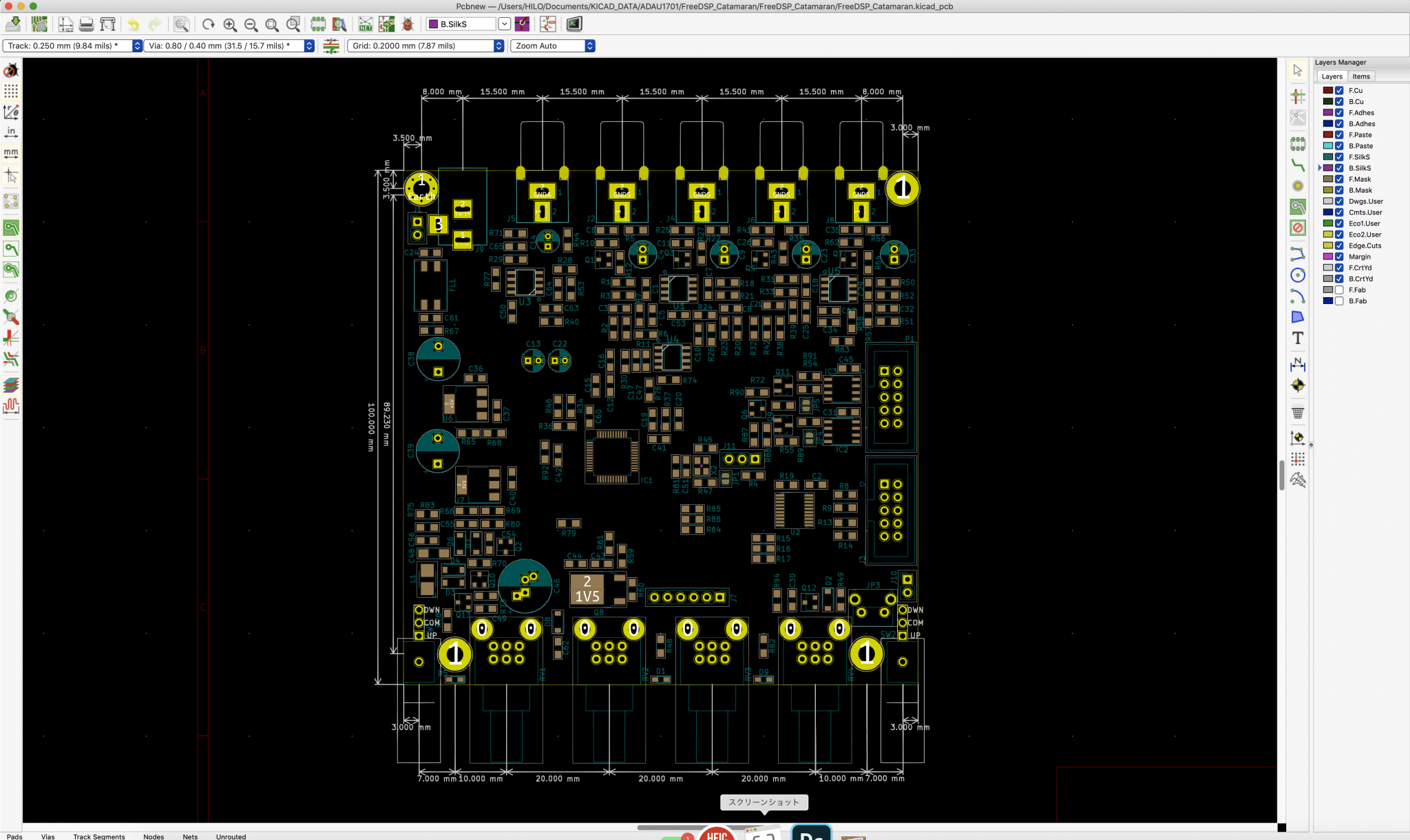

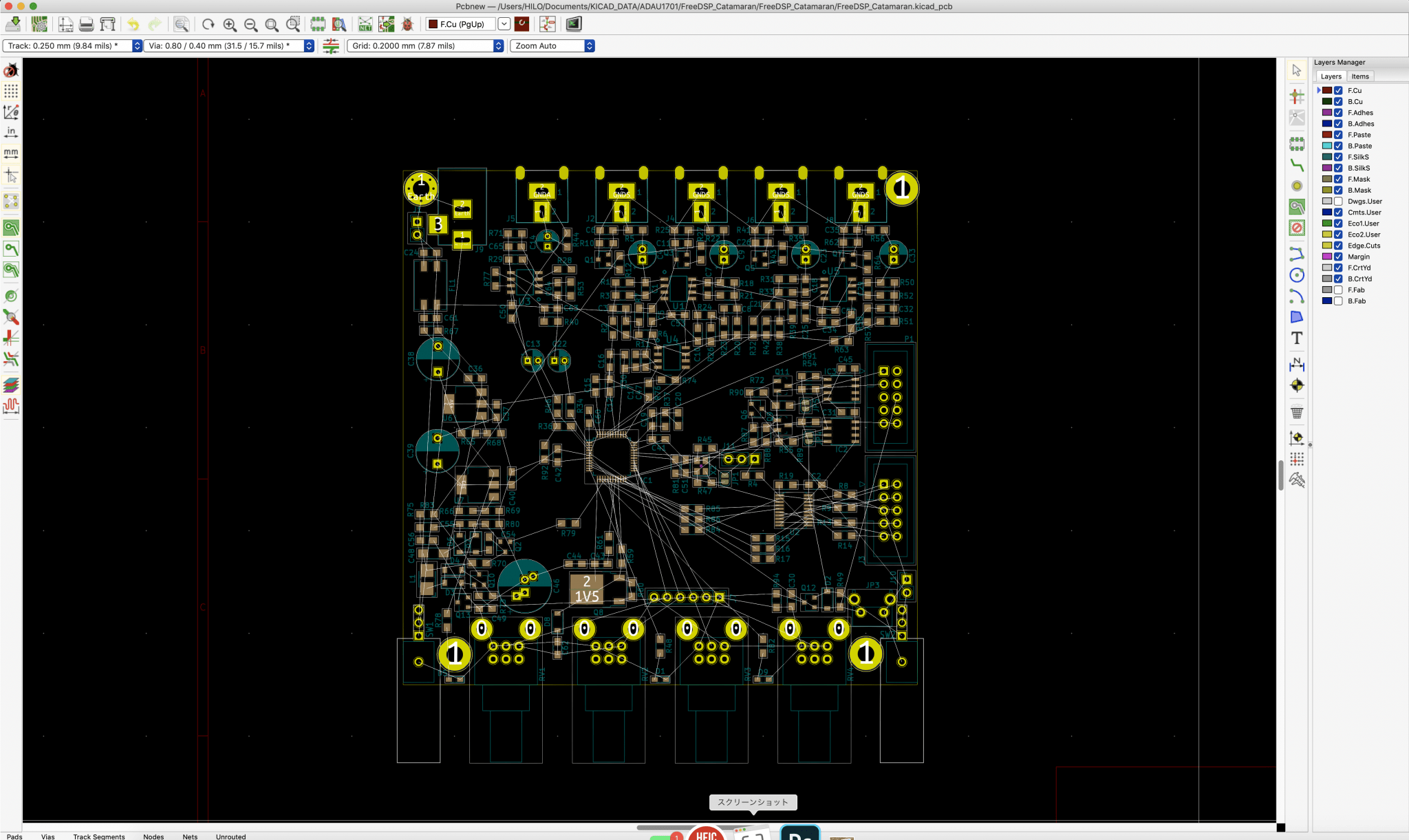

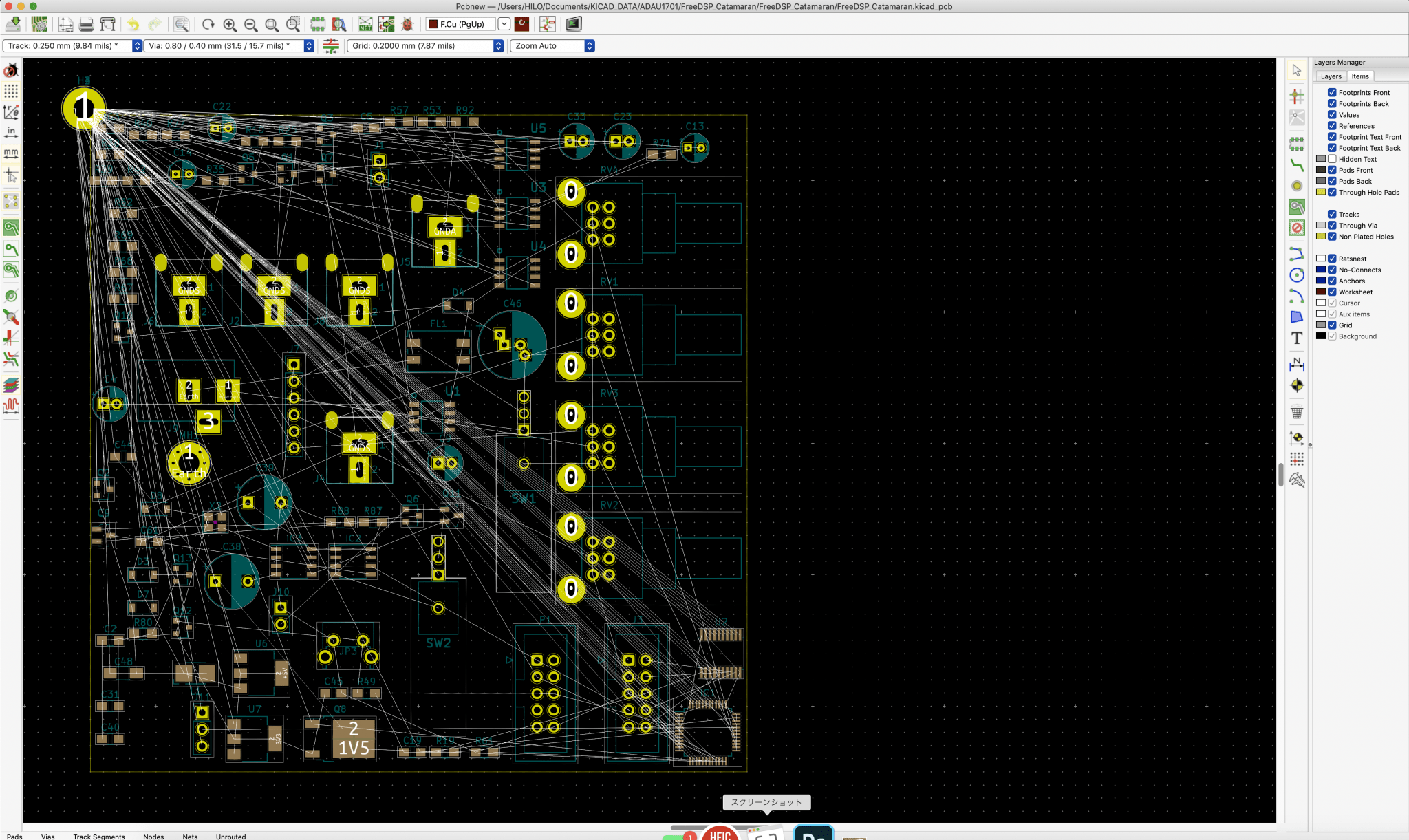

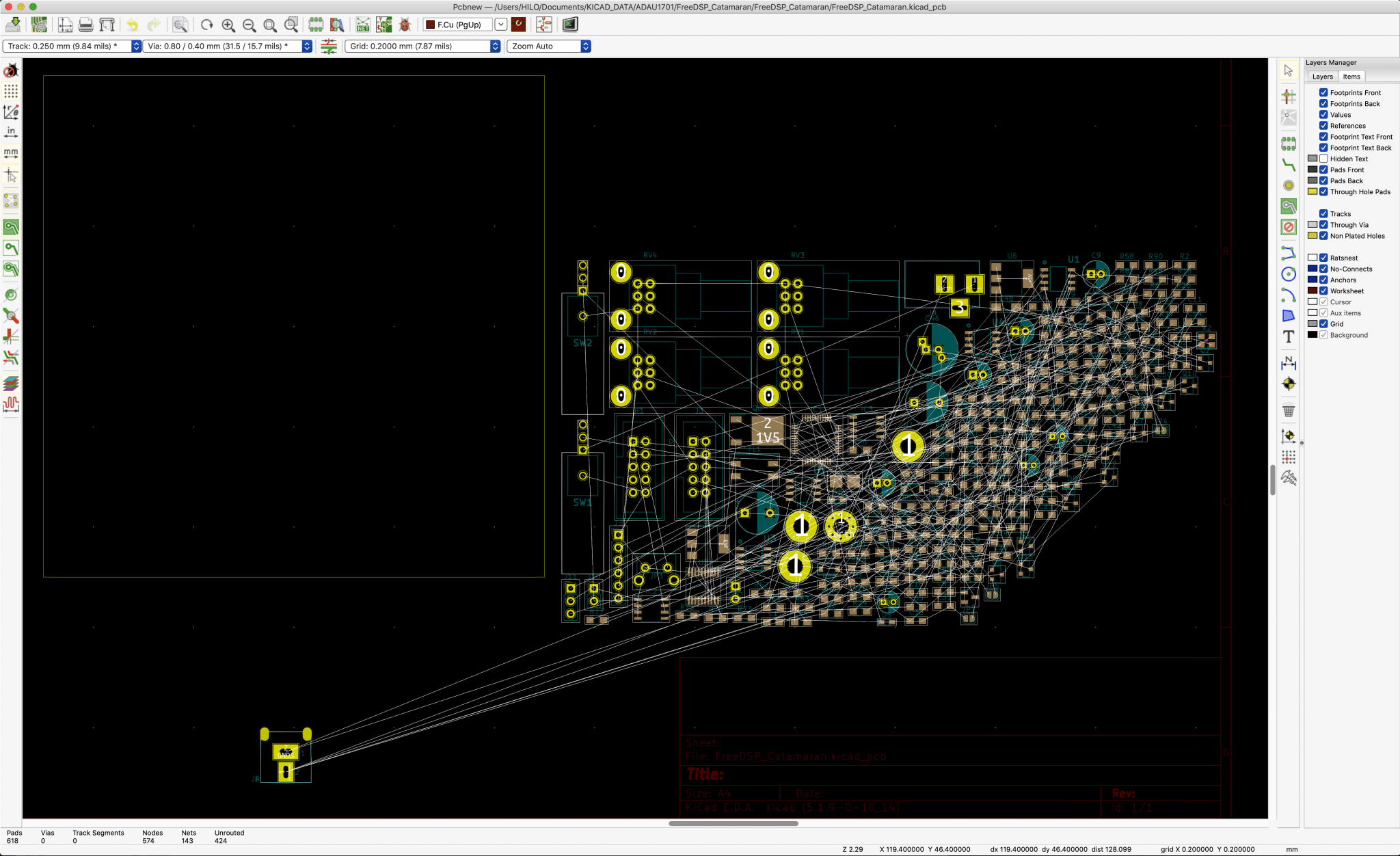

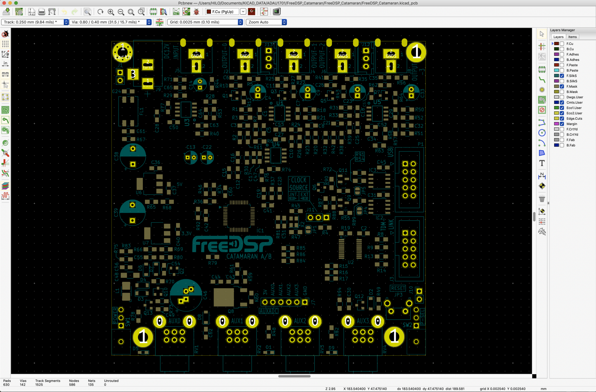

I updated FreeDSP Catamatan A/B board and schematic design. A new feature is automatic DSP firmware reload on the transition of A/B program switching. The reset button is not required anymore!
JLPCB's PCBA information is also updated.
[FreeDSP Project Git-Hub LINK]
https://github.com/freeDSP/FreeDSP_Catamaran_AB

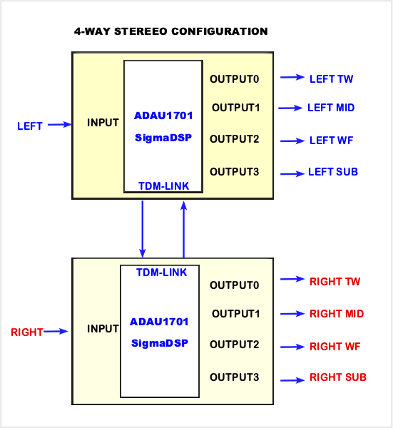

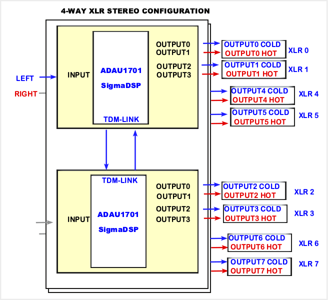

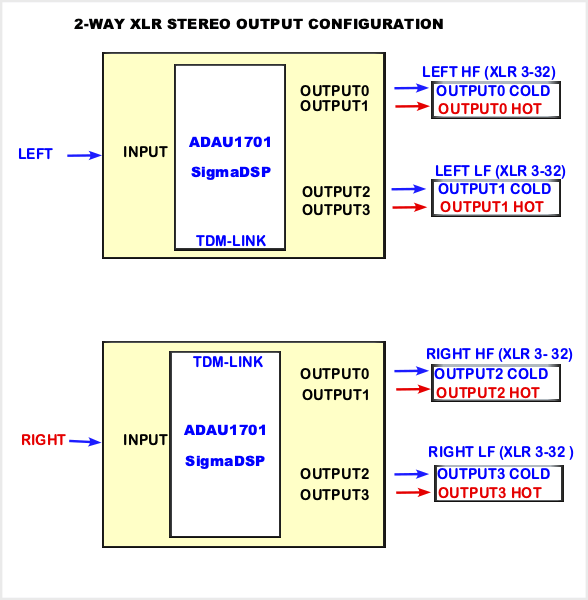

According to those reasons, FreeDSP Catamaran is specially focused on Analog I/O Application design as you can see.
Following few weeks, I will release the design FreeDSP OCTAVIA. It has Raspberry-Pi slot, USB, Optical/Coax S/PDIF, and analog input. 8 channels UNBAL/DIFF/BAL output feature. If you want to insert Raspberry-pi anyway, please have a look at that thread.
CyberPit
Thank you for your response.

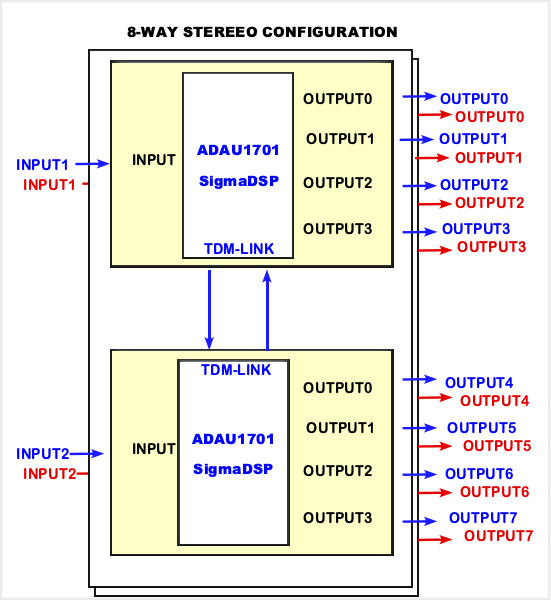

Technically some limits exist, those belong to the I2S I/O limits, and missing the sampling rare conversion block.I have a question is it possible give I2s input to "free DSP board". like from raspberry pi I2s out to I2s input to "free DSP board". is it possible.
- The Sampling rate should be the same as interlinking and processing DSP's fs.
- ADAU1701 doesn't have ASRC
