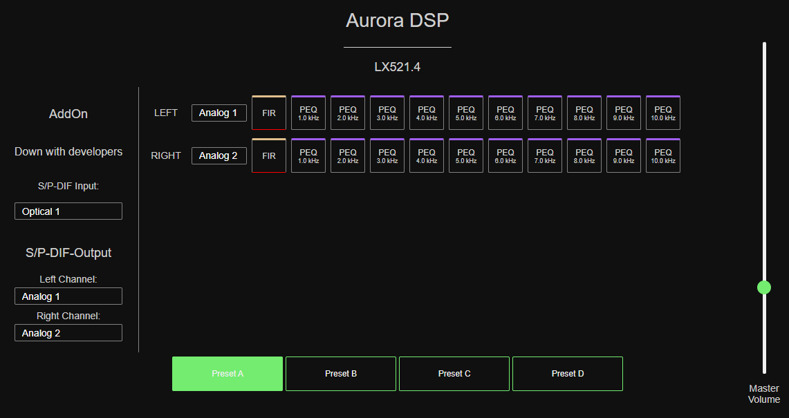

More progress on this. I'm now using the 2.2.0 release. Compiled everything based on the latest sources, copied over my custom plugin to the new style SigmaStudio files (where plugin is in separate page), modified the dsp.html file to match my custom plugin and then updated the plugin.ini addresses based on the .params file.
I'm just waiting now for proper soundcard to hook up everything and measure frequency responses etc with ARTA or REW.
I also need to build case for the whole system. I'm contemplating whether to just order bare case and drill/machine all the cutouts myself, or go with something like https://www.schaeffer-ag.de/en/ who can CNC machine the front/rear panels...
Screenshot of the dsp.html attached.
