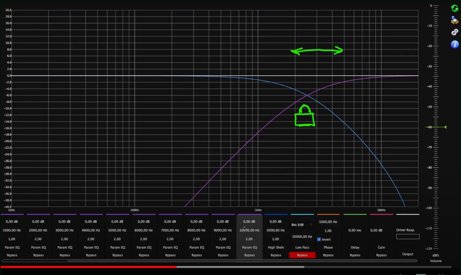

I finally got the board assembled couple of weeks back. It was difficult sourcing all the parts but got there in the end..
Anyway I'm working on implementing 4-way active speaker crossover + room correction with the freedsp aurora board. Crossover is made with IIR filters (based on LX521.4 minidsp filters) and room correction would be combination of IIR + FIR. I would also use FIR to unwrap the overall phase.
I took the 8-channel plugin as a starting point, changed input to 2ch and simplified the overall filter structure and add two FIR filters (left/right channels). The filters in the 8-ch plugin didn't quite suit my needs so at the end it was changed quite a bit in SigmaStudio (high/low shelfs were not like in minidsp). I got it to fit the memory etc. so I don't see problems from that point of view.
In the SigmaStudio design there are filters that I like to stay fixed (basically the 4-way crossover part), I don't need control for them on the webapp. I only need control for the parametric EQ + FIR for room correction (and there is already example plugins with these, so should be straightforward). I know how to compile the .fw file and .ini files from the sigmadesign files for new plugin, and the html edit should not be a problem.
Now I started wondering, since these fixed filters in my design don't need any control in the web app, where the default values for these filters actually come from? Are the default values for the filters part of the .fw file? Or do I need to add them to the web app, maybe modify the plugin.cpp and plugin.h, and what else? Are there instructions on generating new plugins somewhere? Especially adding new type of filters.
I guess one way to go would be going for SigmaStudio based control altogether (solder the EEPROM on the board etc), but I like the easy control over wifi/web page rather than SigmaStudio through USB.

I have been going through the files/sources and trying to figure out how everything works, especially related to developing custom plugins. I used the lowshelf filter in 8channel plugin as an example and tried to follow how everything works together. I'm not a SW engineer, so bare with me..

Here is also link to SigmaStudio diagram showing what I'm trying to accomplish. Basically in the web GUI I don't need the 4-way crossover filters (8ch) I only need two FIR filters and two parametric EQs (left and right).
Capture.PNG - Google Drive
So the question really is how to set the default parameters to the crossover IIR filters? I don't need/want to configure them in the web GUI.
