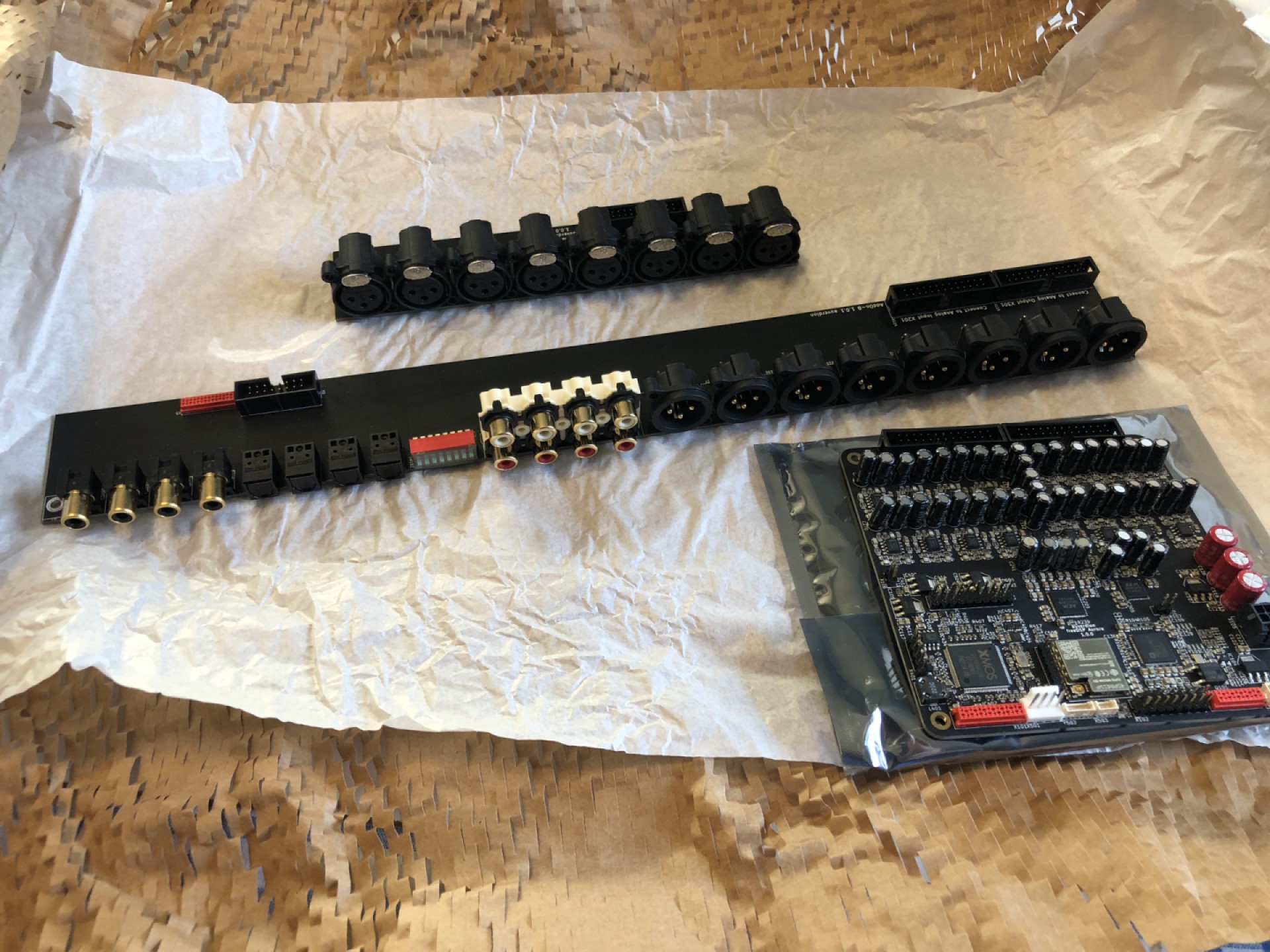

I have an Aurora DSP and AddOn B I will sell for $350 shipped in the US if anyone is interested.
My active speaker project is not going to happen, I sold the passive speakers(JBL 4722N) after setting them up at a friend's place and realizing they would not work in a small listening room.
