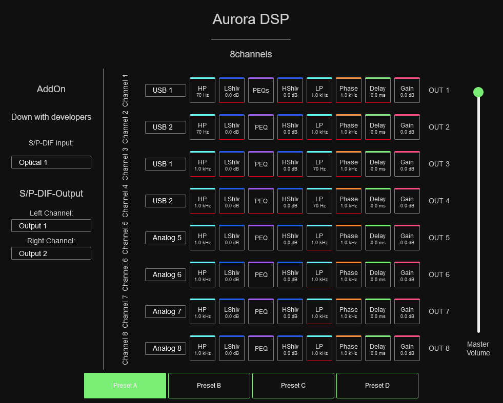

Could someone help me troubleshoot the S/P-DIF input please?
I have AddOn B connected to my Aurora. I verified that all the ribbon connectors between the AddOn and Aurora are properly installed.
The S/P-DIF from my PC's motherboard is connected to the first S/P-DIF input of the AddOn.
From the web interface I have configured the audio to be routed to Output1 and Output2 but I get no sound at all.
I tried all 4 inputs with the same result. USB audio works fine.
Plugin version: 2.2.1
FW version: 2.2.1
I also have a volume Potentiometer connected.
Any help is appreciated, thank you!
now, I dont have this board, nor am I familiar with it, but just looking at your matrix mixer there (to use an RME term), although you appear to have spdif selected as an input and output on the left tab (outside the mixer on the left), your spdif output listed underneath as output 1 and 2, is referring to outputting spdif channel 1 and 2 to the spdif digital output on the add on.
As far as your audio output, you havent got spdif selected as an input for any of the 8 channels, you have USB 1-2 from input channel 1-4 mapped to OUT 1-4, then 4 analog inputs (analogue 5-8) mapped to OUT 5-8. Nowhere is spdif shown as a selected input to the mixer. Again, it seems like you are mistaking your S/P-DIF-Output Left Channel = output 1 Right Channel = Output 2, as meaning you get spdif at the output? I may have misunderstood.
If I understand the mixer correctly, you should try selecting spdif input channel 1 and 2 as the inputs for all 8 channels, or however many output channels you want to use. if you are using outputs 1-2 (ie, if thats where you are connecting your cables), you should select where it says USB 1 and USB 2 to being spdif input 1 and 2. Then it will be selected for that preset and you can go about making your changes to the filter.
Yes, I would expect your last setting to work and give you output on channel 1-2, provided everything is working and you have tested the computer as a source using optical with something else. Someone familiar with the board will be better from here i'm afraid.
Yes, someone who has used the specific board and configuration might know what's wrong. In any case, I appreciate you trying to help me out with this!

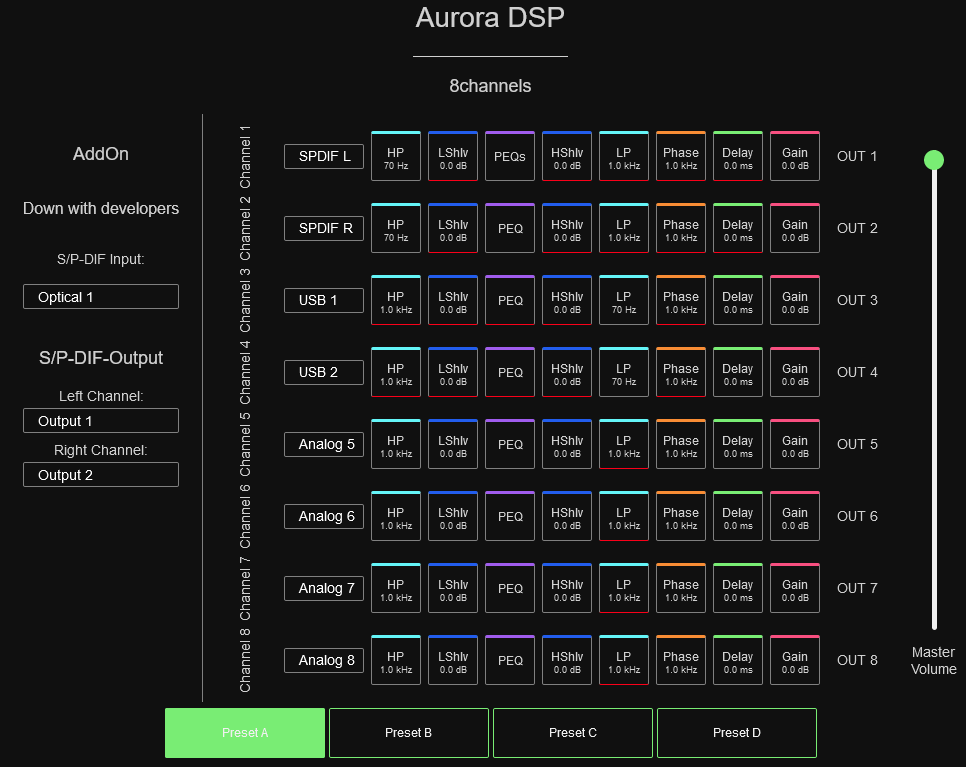

Yeah, I've tried many combinations of inputs and outputs but none works. I tired this one following your suggestion which doesn't work either:
You should get audio from optical1 to OUT1/2 in the example you have given. I have noticed you sometimes need to toggle the S/P-DIF setting on the left to get it working (so select for example Optical 2 and the Optical 1 again).
Thanks for the suggestion @tomik but unfortunately that didn't work either. I tried all S/P-DIF inputs but no sound.
Another strange thing I noticed is if I set SPDIF L and SPDIF R as inputs for Channel1 and Channel2 respectively, there is DC current going to the speakers (cones get pulled in). Could that be a sign that something is broken?
Thanks!
Thanks!
Yes that definitely does not sound good.. Is it the same with any optical input? Have you tried with coaxial?
