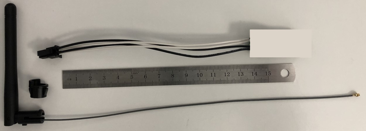

Just ordered a board, is this Molex piece the correct piece to use for the power connection?
44769-0402 Molex | Mouser Canada
Also, can't really find any details on the termination, can anyone tell me what "through hole" means?
EDIT: Never mind, I'll just buy the pre-terminated pigtail. 45132-0410 Molex | Mouser Canada
Why? The DSP unit already comes with the power connector pigtail in bag with the WiFi/Bluetooth anteanna.Just ordered a board, is this Molex piece the correct piece to use for the power connection?
I didn’t know that. Is it in the manual?Why? The DSP unit already comes with the power connector pigtail in bag with the WiFi/Bluetooth anteanna.
I don't think so.
Yeah... I had better wait until the thing arrives before I order anything else.I don't think so.

Actually I was wrong, the items are mentioned on pages 14 and 20 in the manual.Yeah... I had better wait until the thing arrives before I order anything else.

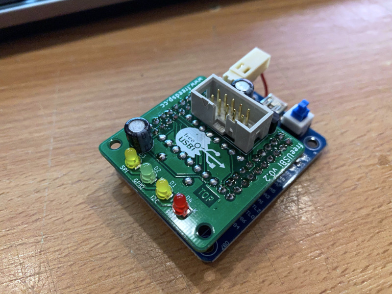

take a search for USBi
Build but not tested, to many other things to do ;-)
