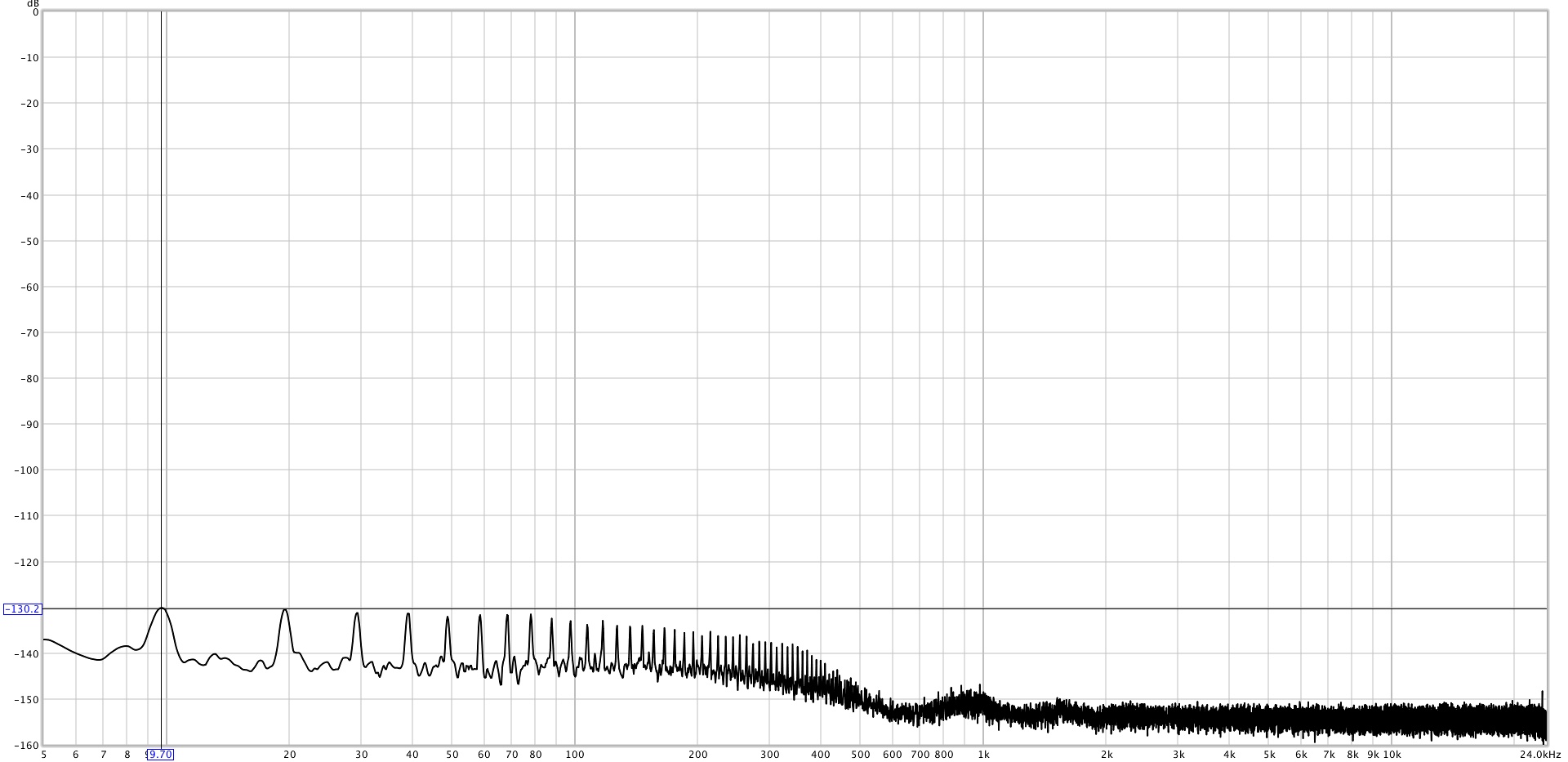

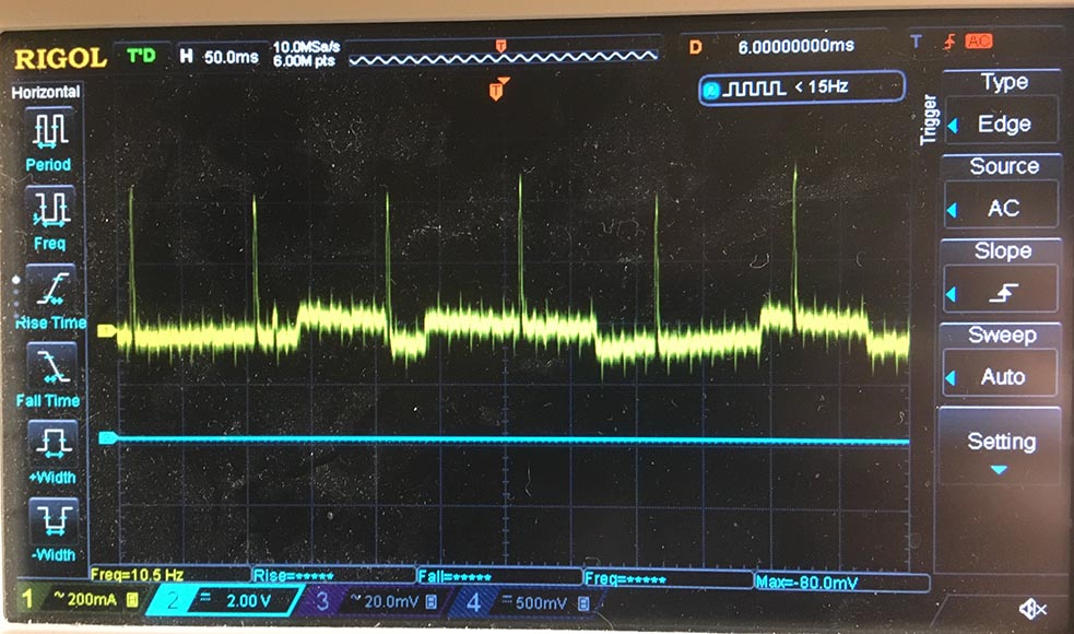

I’ve discovered an interesting behavior of Aurora that appears to be related to WiFi operation. As soon as the access point is opened on Aurora the ESP32 starts drawing HUGE current spikes every 100ms (> 500mA at minimum). This 10Hz pulse frequency is creating a lot of low frequency harmonics that are severely limiting the output noise levels.
Below is a probing of the current consumption of Aurora showing the offending spikes. Note that this is with an additional 1,400 uF of bulk capacitance added, so the effects of the current spikes are actually rater muted.

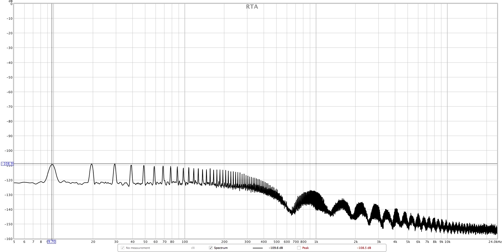

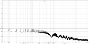

Looking at D/A/D Loopback performance in REW, the noise apparent, and lowering the signal-to-noise (S/N) performance of Aurora from the expected loopback performance of 112dB S/N to only 83dB S/N (was even worse before adding the bulk capacitance).
Interestingly, this primarily seems to be affecting the DAC, rather than the ADC. As feeding the ADC stage with a muted signal generator produces 108dB S/N, much closer to the targeted 112dB.
I’ve not been able to diagnose this issue much further than looking at the serial monitor and narrowing it down to the ESP32 radios, as it appears immediately after “AP Open.” The pulsing then continues for the entire duration of operation.
