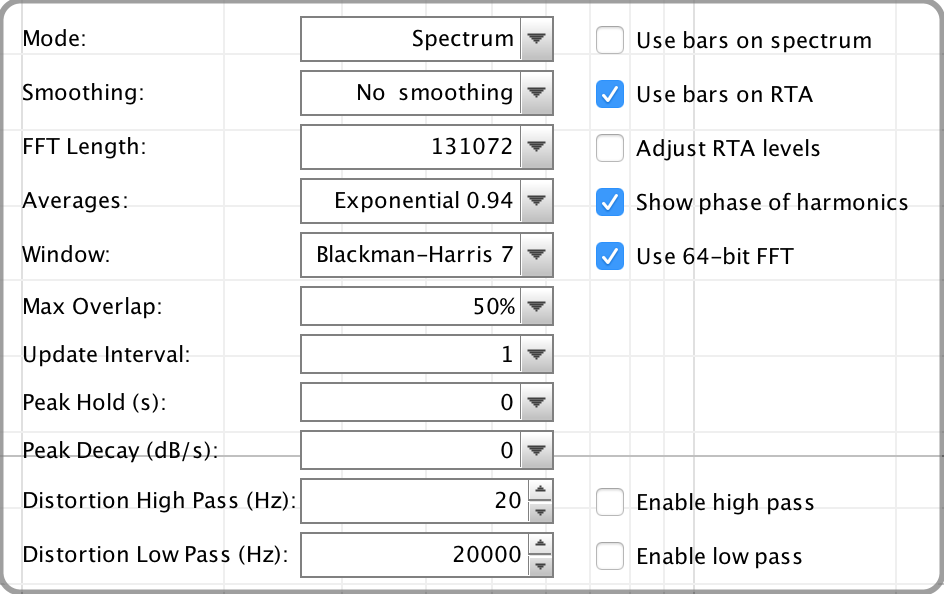

I’ve discovered an interesting behavior of Aurora that appears to be related to WiFi operation. As soon as the access point is opened on Aurora the ESP32 starts drawing HUGE current spikes every 100ms (> 500mA at minimum). This 10Hz pulse frequency is creating a lot of low frequency harmonics that are severely limiting the output noise levels.

Can you describe a bit further how you measured the pulse? I couldn't verify it so far.
I first noticed the current pulses when measuring loopback in REW. Any channel to any channel should work, any plugin, all DSP disabled. I monitored the input in REW's RTA with the attached settings.
Once I saw the 10hz harmonics I put a 0.01 ohm current shunt in series with the power supply (9v, as this provides best S/N performance) and then probed across it, seeing the previously attached scope plot.
Across the 9v input rail

You could try to set the 1400µF across from +3V3 to GND on the pins of the ESP32. A small ~47uF Tantalum could improve it, too.
But I am still a bit confused. Because I cannot see these spikes. Perhaps you pick them up somewhere else? Ground loop?

Ground loop *might* be possible. The only additional ground-ish connection to Aurora is the "Low" terminal of a digital potentiometer on the volume input, through that should be ground-ground isolated (MAX5481). I will test again with this disconnected in a few minute and report back.
This still doesn't really explain the current consumption pulses appearing on the power supply... I will try again with a fully differential probe in case the single ended probe is picking up some strange interference
it is known that the ESP32 causes some short high current spikes once WiFi is enabled. I had trouble with that on the first prototype. There it caused the ESP32 to reboot every time WiFi was enabled because the voltage became too low. At that time an additional cap on +3V3 to GND helped. And later I added an extra LDO for the ESP32.
An additional 47uF tantalum on the 3.3v rail did not seem to significantly reduce the offending 10Hz harmonics, nor did disconnecting any additional grounds. However, as I was moving wires around I noticed that when my hand was near the antenna, the noise decreased slightly. Moving the antenna as far away from the board as possible decreased the 10Hz peaks by around 3-6dB, and placing my hand against the antenna between it and Aurora made them disappear below the noise floor. Seems like these harmonics are all radiated energy rather than power rail corruption.
I happened to have a flexible copper rf shield hanging around that I had used for other projects, but wrapping it over the Aurora board and grounding it to main 9v power ground actually increased the 10hz peaks, rather than attenuating them (possibly capacitive coupling), so I'm not sure what all I can do to improve this other than the 3-6dB boost from moving the antenna.
Aha. Sounds similar to something what I observed when I made the Aurora Limited builds for the kickstarter campaign: When aurora was placed in an aluminum case I could hear some ticking in the audio signal and the WiFi connection was really unstable. But only when the top cover was removed. Once the top cover was back and therefore the antenna could not see the board anymore, the ticking was gone and WiFi was stable again. Interestingly the case was not connected to any ground or earth.
This describes what I'm seeing perfectly. My case is plastic and the antenna I'm using is an internal patch. I think the flexible copper I tried earlier produced something similar to your case with the open lid.
I'll try moving the antenna externally and foil wrapping the entirety of the case to see if that helps, thanks!
