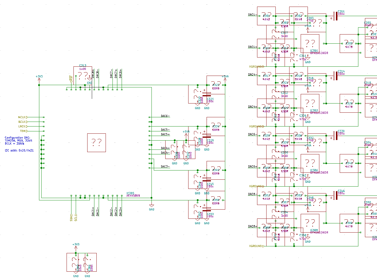

Getting some funky layouts, I'm thinking I don't have the correct symbol libraries (or that they're set up incorrectly). Any guidance would be great.
