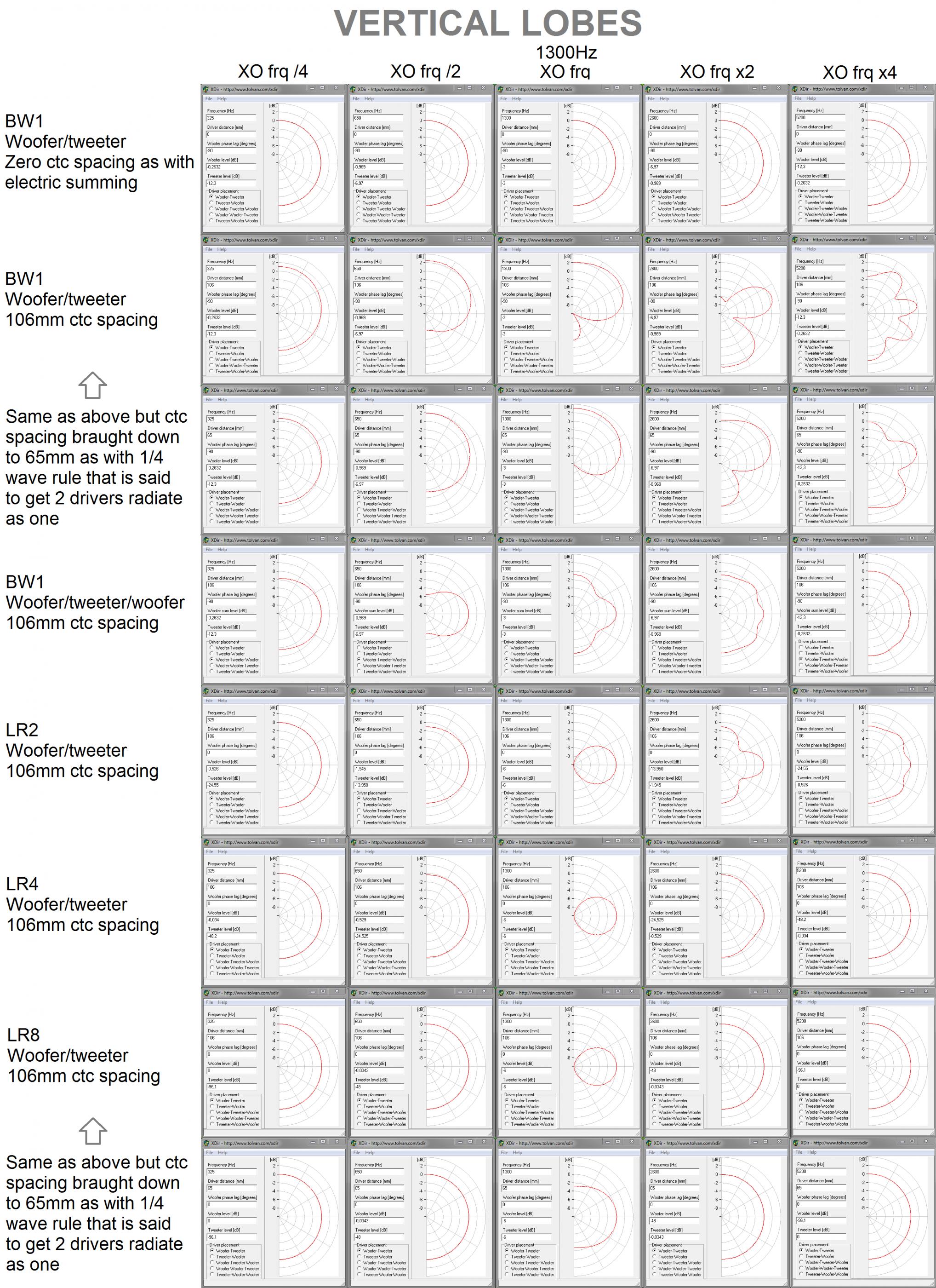

XO vertical radiated power response from post 78 continued.
Added LR2/LR4/LR8 and two examples setting spacing <1/4 wave rule.

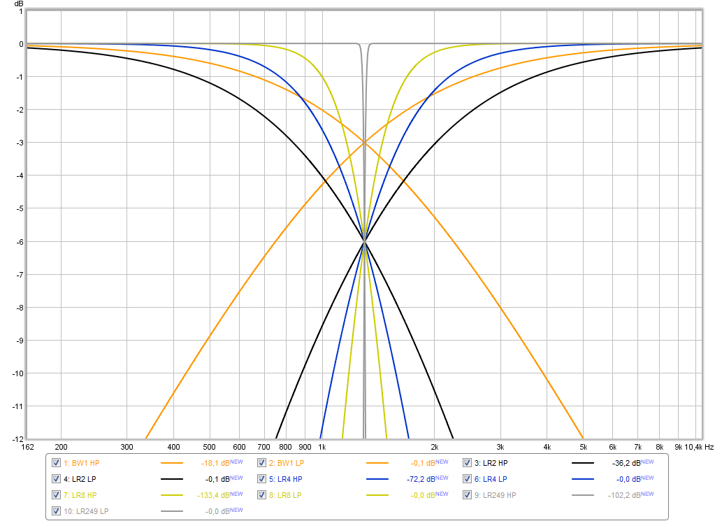

To create data made slopes in Rephase as IR-wav file then imported into REW where dB setting for XDir was decoded.
Picture 1 show slopes into REW plus a exstra brickwall LR249 because could imagine will have a very narrow lobe that will degrade power response but think will need FIR filter else phase distortion will be too manipulating to input wave. FIR filters would be good for all the LR ones in they would get flat phase and then perform square waves at least on axis.
Picture 2 could be upgraded with HARSH on request, but it will take some time and concentration to get right because phase is probably only real coherent exactly at XO point where LR is easy in they always in phase and BW1 always 90º apart in textbook scenario.

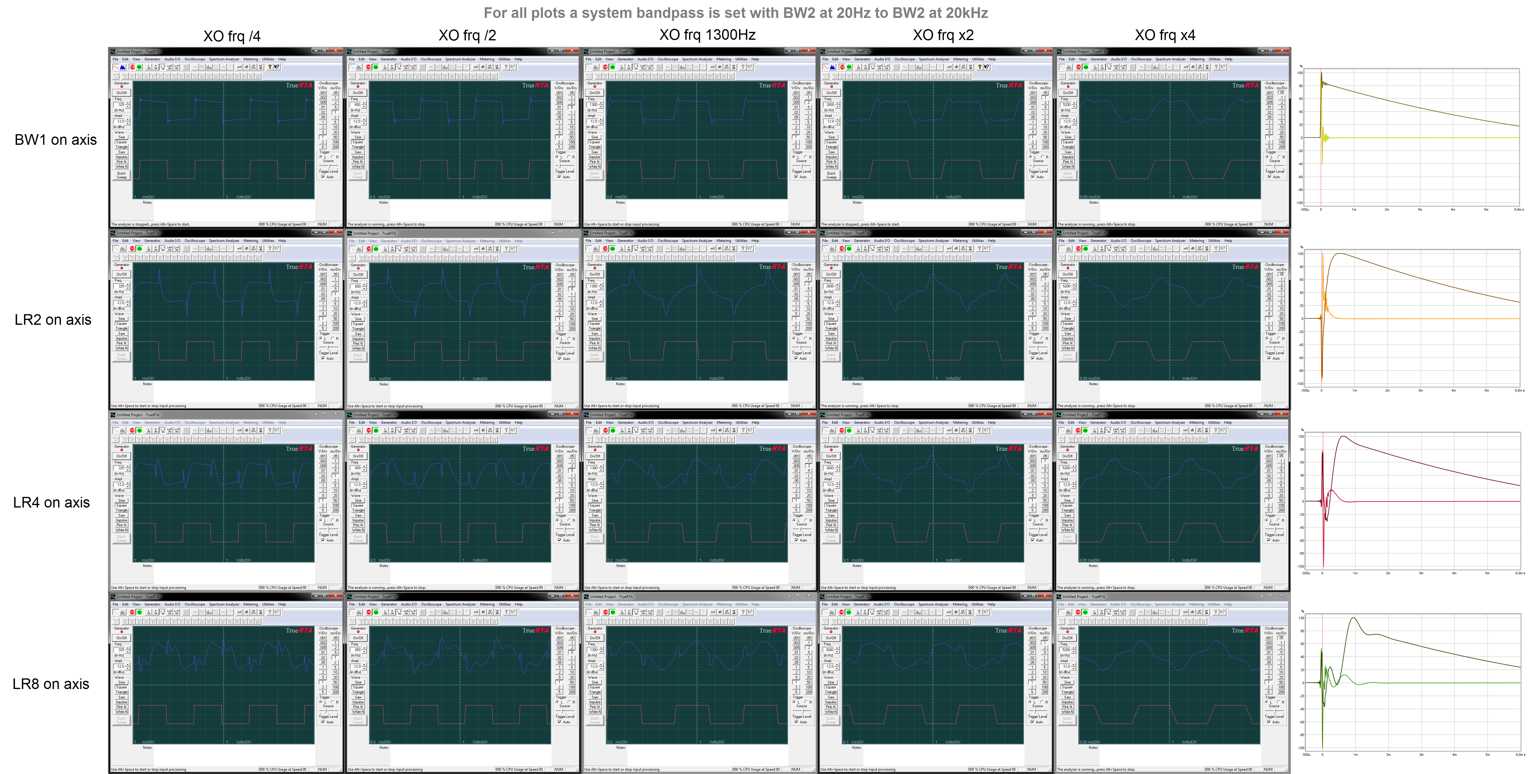

Picture 3 is square waves and IR/SR related to picture 2 plots and created with live soundcard loop 16bit/48kHz, therefor bandwidth is limited to below 24kHz so expect that will add a bit ringing to last octave.
Hope is usefull information personal learned a lot having visuals to help understand radiation and power response in XO region when sources is physical spaced apart.

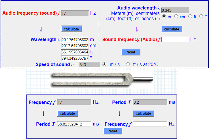

and what of the 8 dB difference at 17 Hz. How do you explain that?
Own experience is below 30Hz area trace from repeated measurement is impossible to replicate, and looking at a live RTA measuring in real world enviroment shows there is plenty of LF rumble going on down there.
Also wavelengths is more than 20 meters at 17Hz think will probably need more than a handful scotchbrite to damp 8dB.

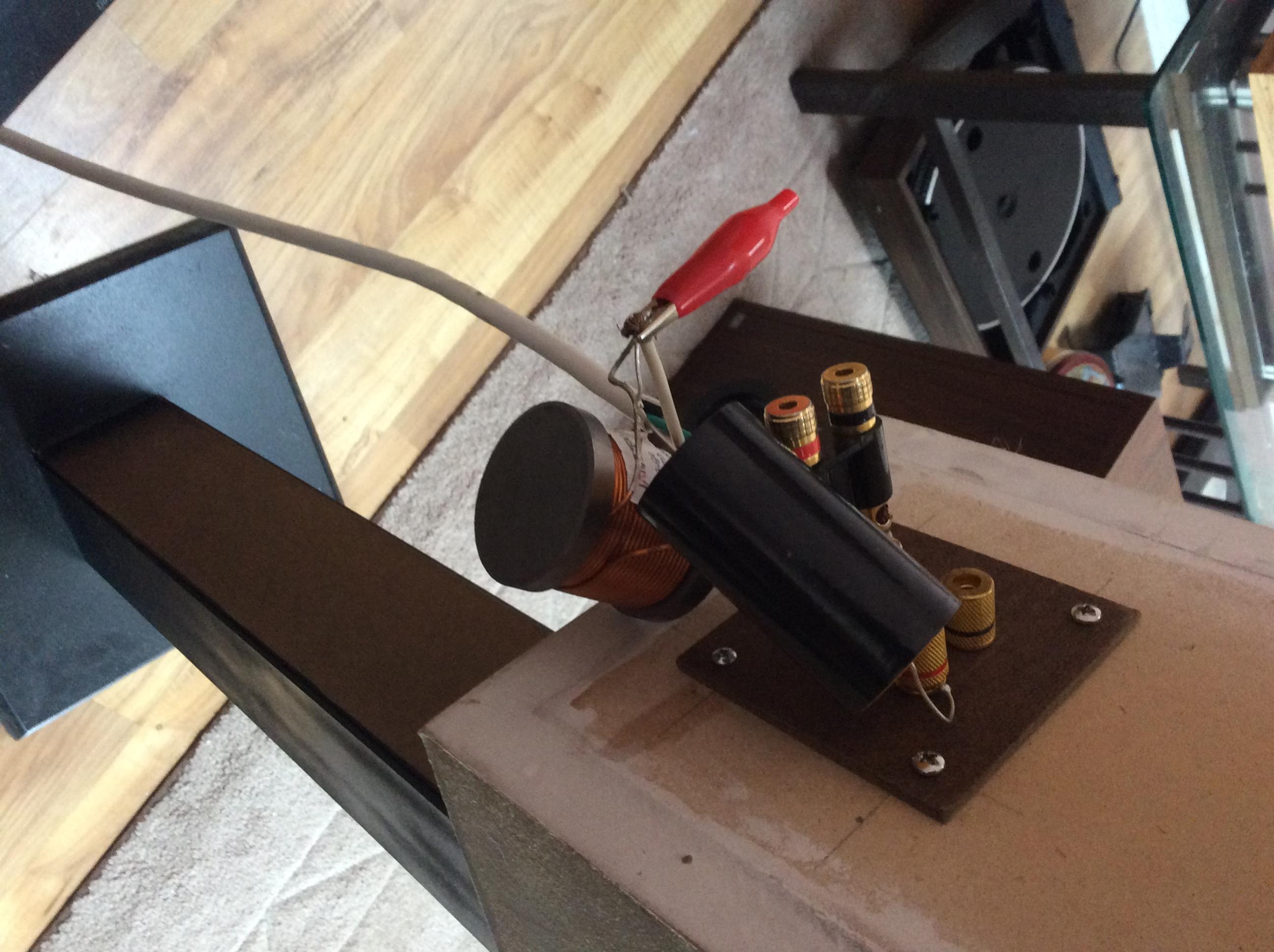

I repurposed an enclosure originally intended to be a ZD5 and fitted the Fountek and HiVi m5n. Light stuffing in the sealed cabinet and a 1.8mh inductor on the woofer and 30uf cap on the Fountek. With a little eq using my HK Citation 17, it sounds promising without any padding on the tweeter. Now to assemble the second one.

Not yet. I’m hunting for some misplaced 4” dia heavy cardboard tubes that I bought from PE a while ago. I’ll cut about 2” long and glue them in place around the Fountek, lightly stuffed....when I find them.
I’m surprised how clean the speaker sounds without the full range driver being enclosed.
