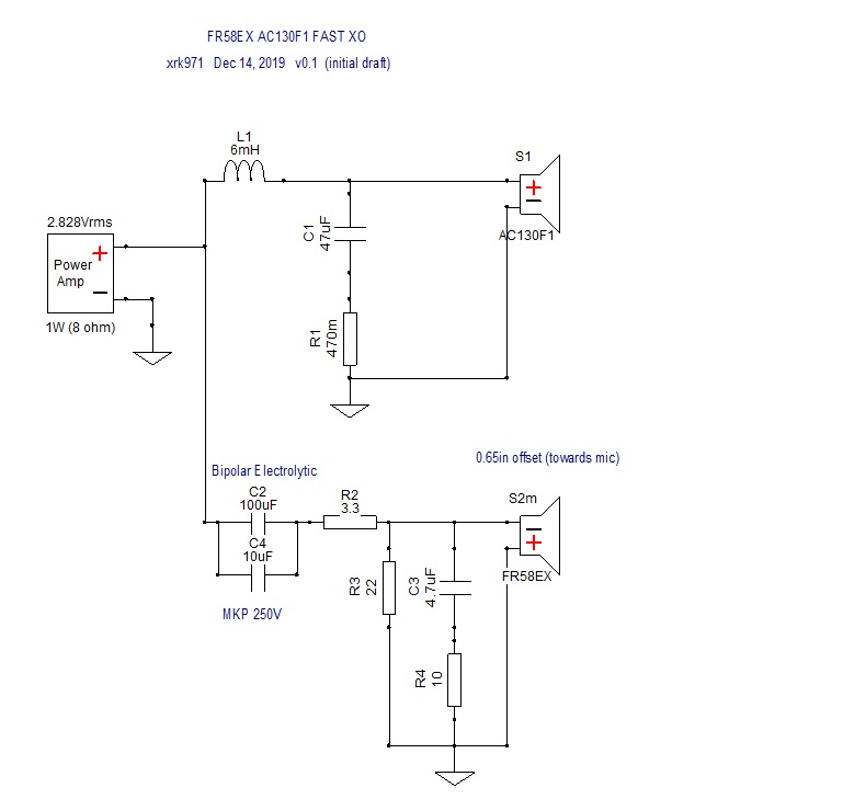

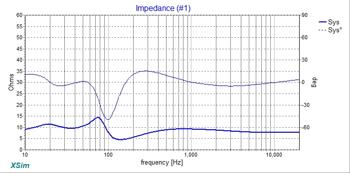

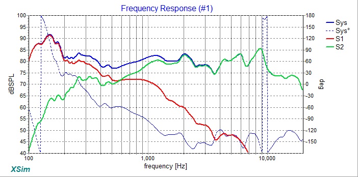

Using the files you provide above, here is my first cut at the XO, at a nice FAST frequency of 600Hz. I was not able to make it a transient perfect - as I had to invert the tweeter. However, that may have something to do with the drivers acting electro-acoustically like a 2nd order crossover despite being 1st order electrically. You can tweak it from here - but this would actually sound pretty good. I am not sure why the FRD has such a big peak at 170Hz as the AC130F1 is really quite smooth. The Xsim DXO file is uploaded as .ASC. Rename to .DXO to use in Xsim.

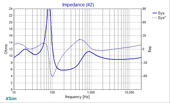

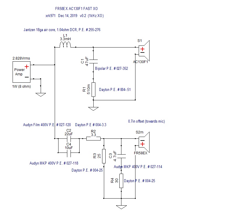

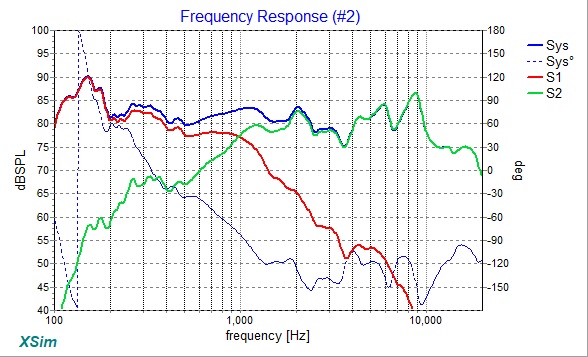

Here is a XO at 1kHz, which might give a little more power to be delivered from the woofer as a midbass. There is a high impedance peak near 90Hz that I have not dealt with yet... But here are standard Parts Express part numbers for all the components.

I have a question, what is your box alignment? Sealed or bass reflex? The peak at 170Hz might be result of too small a box and not enough damping.

You can use the Dayton 3mH coil if desired, should not affect Xo too much.

The box is sealed. I believe it is the same box I used for the Continuums. It is 12" H x 7" wide x 8 3/4" deep. The woofer is mounted 1" from the top of the box. I wonder if that could have anything to do with the peak at 170 hz.

I am confused by your schematic for the FR58. I can't tell which is + and which is -.
The + comes off the bottom of the driver but them down by the R4 there is a ground. I am having trouble wiring things up correctly.
