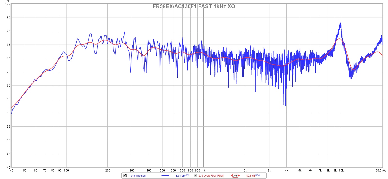

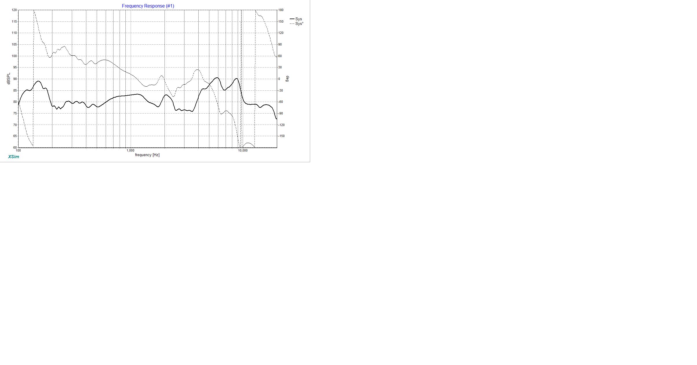

I would attenuate the tweeter a bit more. As it is, you have about a 5dB to 10dB enhancement from 4khz to 10kHz over the average value of 80dB. It might sound a little bright. Is this just an Xsim XO - not an actual measurement of the response?
It is a system plot from Xsim using a 100uf on the FR58 and a 3mH on the AC130f1.
I was just starting there and thought I would give it a listen when my other supplies arrive.
So you don’t have the 3.3R/25R voltage divider yet - that’s what will balance the levels between bass and highs.

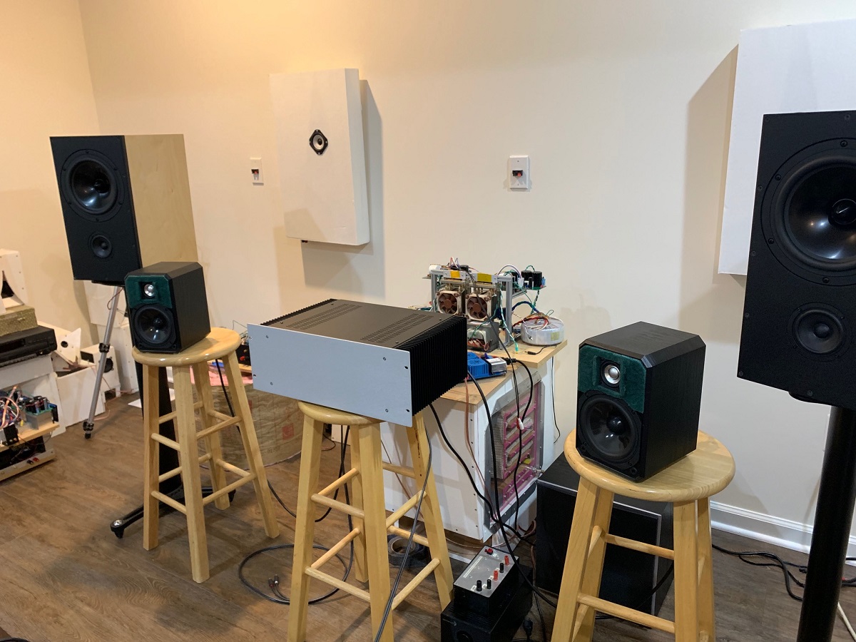

My Parts Express order showed up today - I got a new pair of FR58EX and some 3mH inductors and a few resistors. After scrounging by bench for poly caps, and a large 47uF bipolar, I put the XO's together. They aren't pretty but I did not want to solder them too tightly in case I needed to change a component. I opted for an R2 value of 2ohms to bring the highs a little more into the foreground. I am using the 1kHz crossover otherwise.
Crossovers (I can move the parts over to the new FAST XO PCB when I get those in):
Here is the XO PCB from the 10F/RS225 FAST speaker that will work here too:
Listening to them in the lab:
Closeup of the revived Boston HD5 cabinet now fitted with AC130F1 and FR58EX and a nice XO. Listned to a fe tracks so far - it is late so I will have to resume tomorrow at higher SPLs but what I hear so far sounds very good. Nice balance - similar to my big 10F/RS225 FAST but not as loud of course.

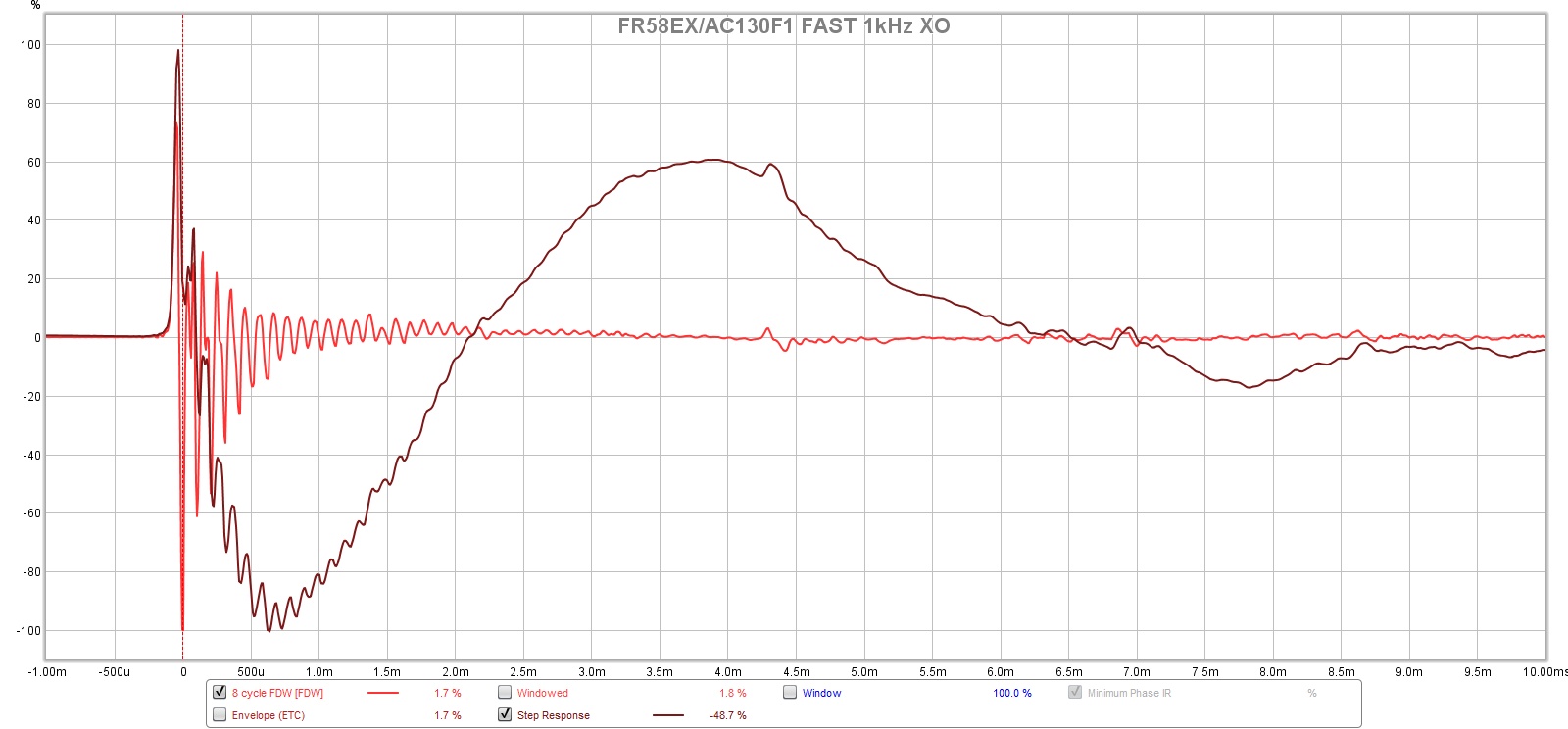

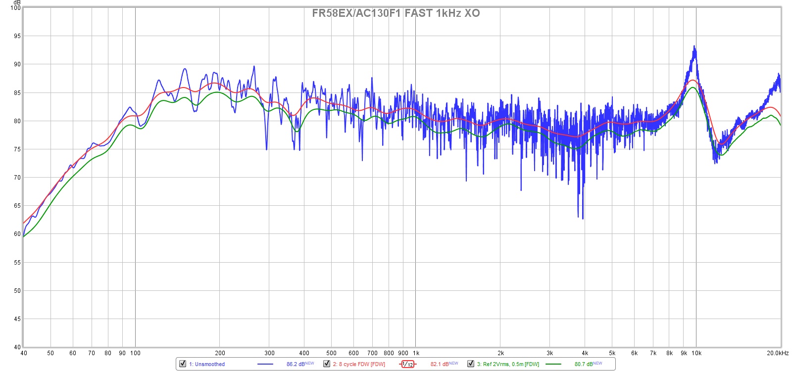

Measurements

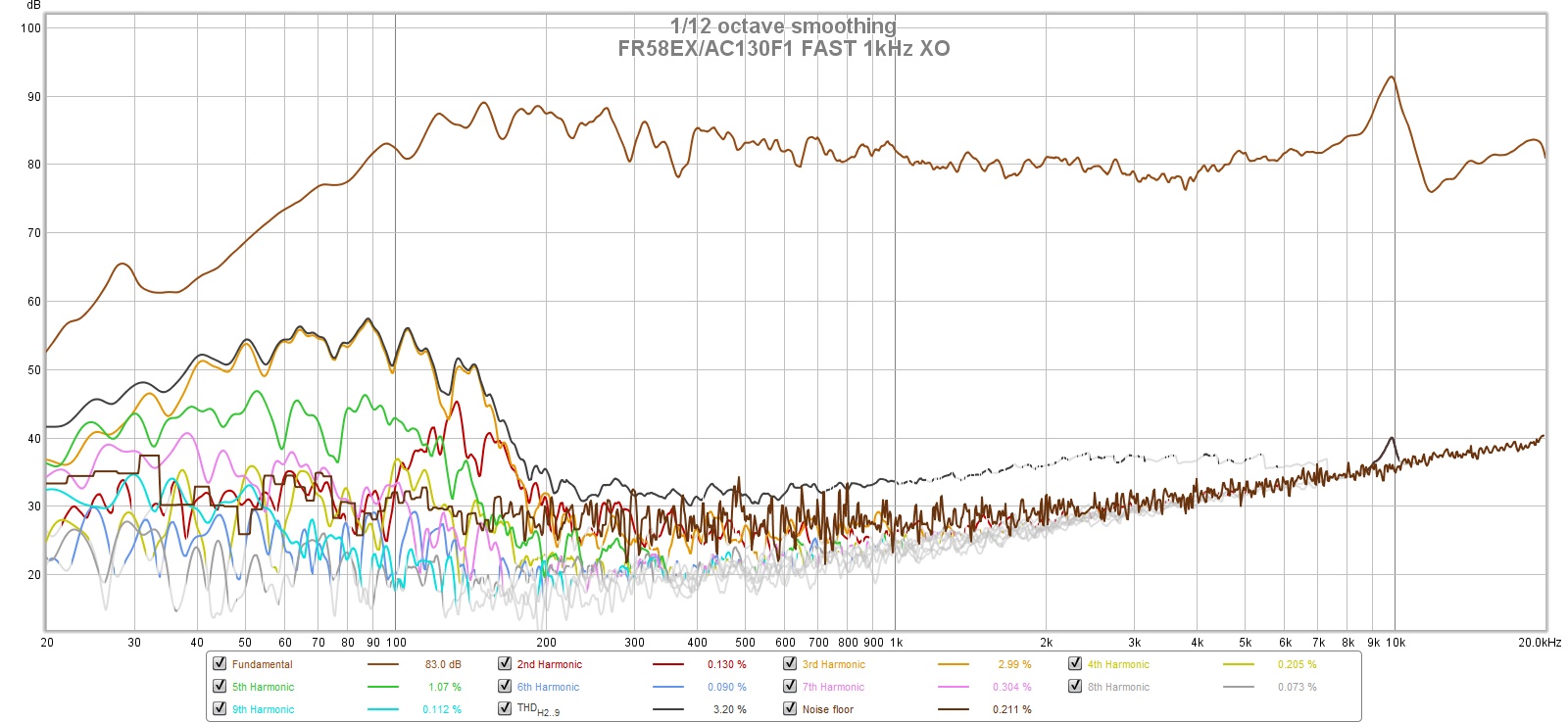

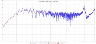

I have not taken out the UMIK-1 microphone in a long time. Here are some measurements of this speaker at 0.42m distance, coaxial with the tweeter. I am using my new Alpha Nirvana Class A amp, and an SMSL Sanskit 10 DAC for the output. Excitation was 1.64Vrms (0.33 watt). I took another measurement at exactly 0.5m and 2Vrms which indicates typical sensitivity for 2.83vrms at 1m just to have that data point for the record. Looks like this speaker box is a bit undersized and causes a large midbass hump which can be seen as a pressurization oscillation in the impulse/step function. A larger cabinet is needed for ideal operation. The pressurization causes higher distortion in the AC130F1 (a known problem) so ideally, a larger box will sound cleaner at lowe frequencies. Above 150Hz, this speaker shines relative to distortion. I am not sure why the Continuum, a well regarded speaker using a similar box size doesn't have any distortion complaints at lower frequencies? Also looks like the 2ohm padding resistor is uneccessary, although here a slight downward tilt can be pleasing. The 1kHz crossover integration though looks very smooth and I am pretty happy with that - it does sound quite good there. There is a definite aluminum breakup peak near 10kHz though. So not the smoothest driver at highs but has some characteristic aluminum cone "zing" to the sound.
Frequency Response (red is 1/8th cycle freq dependent window (FDW) and blue is unsmoothed):
Distortion:
Impulse and Step (UMIK has inverted response - large step should be positive):

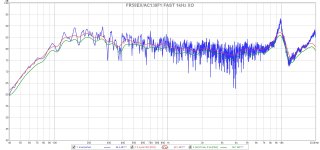

Compare with Reference 2Vrms and 0.5m data (green) to show SPL sensitivity at usual 2.83Vrms and 1m standard:
So the takeaways are: larger box, reduce padding to maybe 1ohm or 0.51ohm resistor, maybe make as a TL for deeper bass with less distortion. But XO balance looks superb.
Manufacturer recommends 0.3 cu ft vented for 70Hz F3. For sealed, they recommend 0.13 ft cu which is very close to what I have.

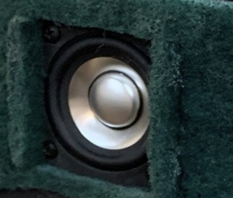

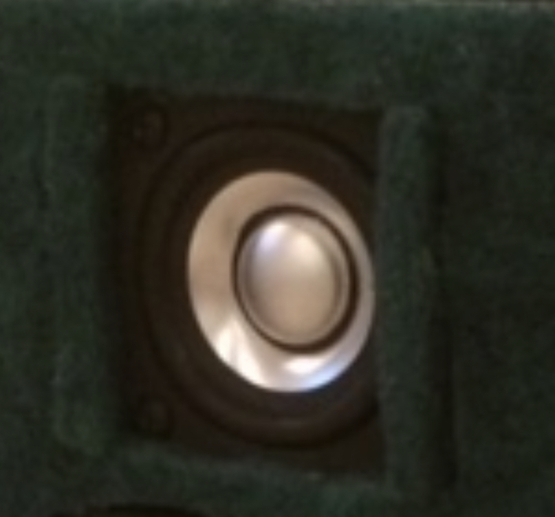

That 10khz peak is odd because it was not there on the previous units I had. If you look at the measured frequency response from post 1, it doesn’t have the huge 10kHz peak.
I think the driver has changed.
If I look at how much extended rubber from the surrounding touches the cone on the old ones, I think there is now less rubber and more aluminum.
Current ones:
Previous ones:
I still have them - the sure way to know is to swap them - but they are sort of hot glued into an open baffle speaker.
Current ones:
Previous ones:
