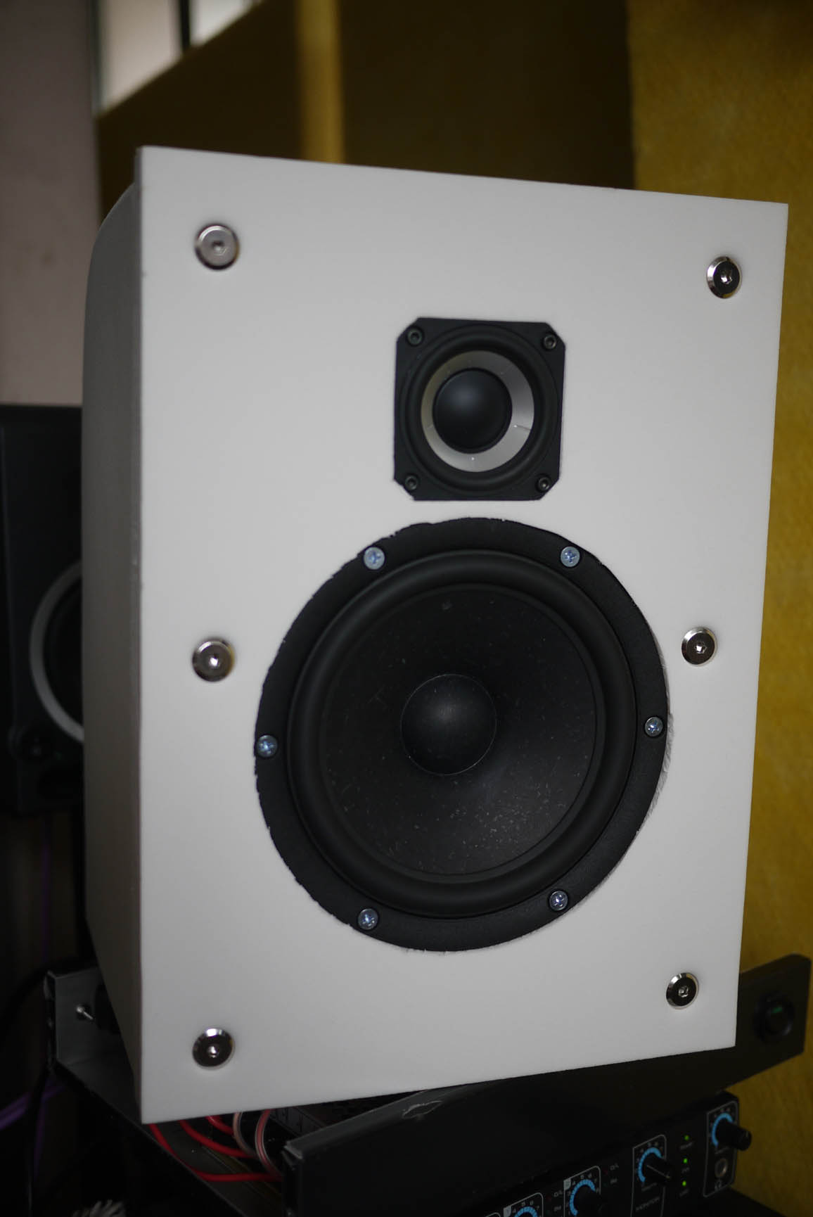

Jeshi,
That looks awesome! I really like the white EVA baffle with flush mounting. If you still have the baffle I would try adding the Dagger backside or Canolli quickly to test. Not having a rear chamber subjects the backside to all the pressure generated by the Satori. It would cause a lot of distortion.

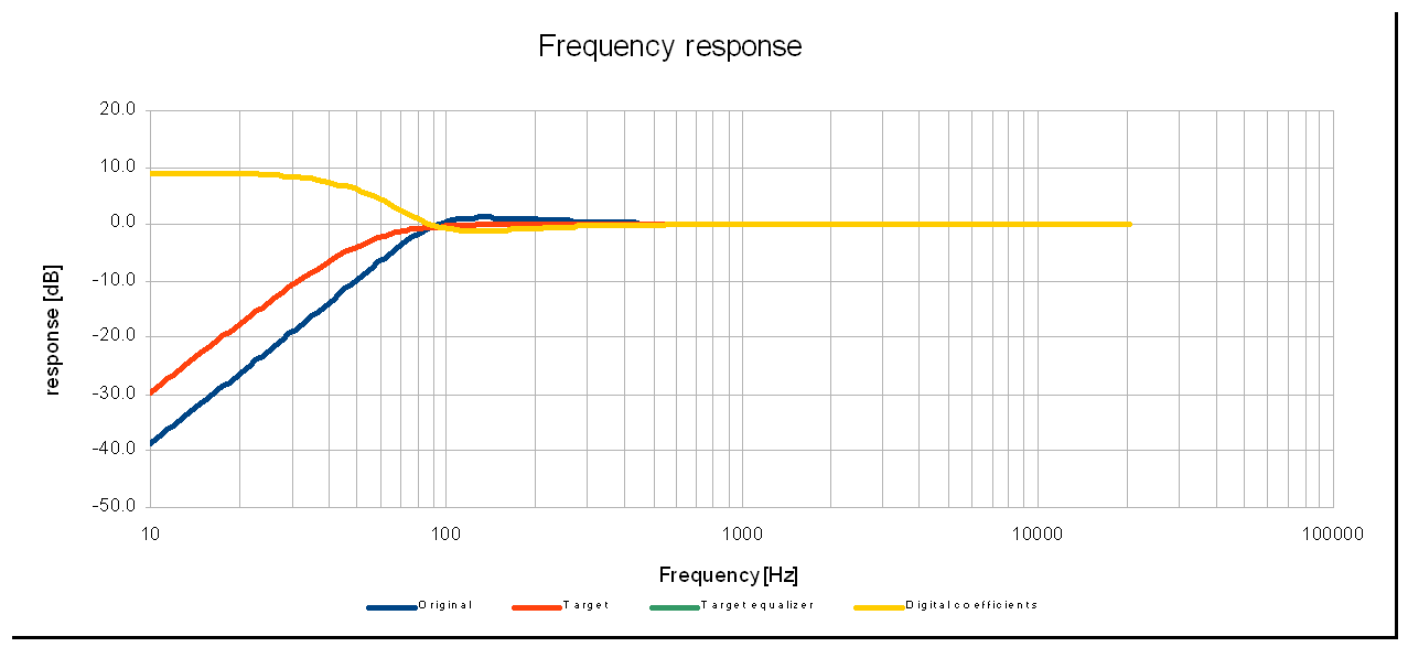

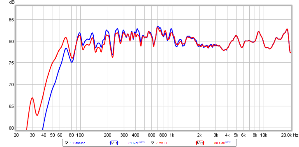

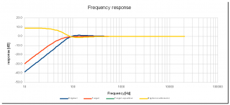

Here is the current response and target response with LT EQ that will be needed:
Linkwitz Transform on AC130F1 in HD5 box
It's nice when the theoretically predicted bi-quad coefs for the LT worked out perfectly. I now have a 55Hz (-3dB point) speaker with a Q=0.71 response. The HD went from 2.24% to 3.20% at 60Hz with a +7dB boost in SPL at 60Hz. This made a significant difference in the overall balance of the sound and it sounds even better now. As a nearfield moderate SPL (<85dB at LP) it works beautifully with a reasonable level of distortion.

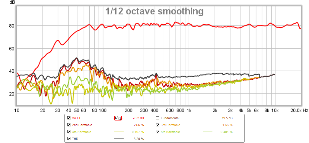

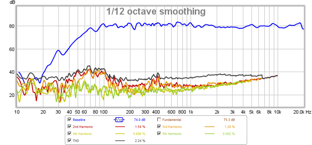

Here is the before and after response with the LT applied - it appears to have helped the mid and HF ripples somehow:
HD before LT:
HD after LT (cursor at 60Hz):

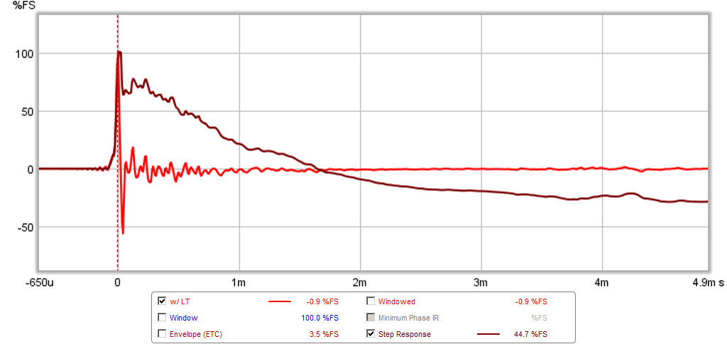

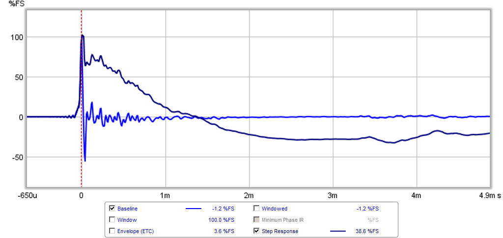

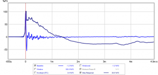

The step response also appears to be more improved with a longer duration triangle shape.
Before LT:
After LT:
HD before LT:
Before LT:
After LT:
