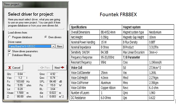

You think that I can give the TB W3-1053SC I got a shot in the Fountek FR88EX box linked 2 posts back?
Here you go with side by side specs.
That should work just fine looking at the specs they are barely different...
