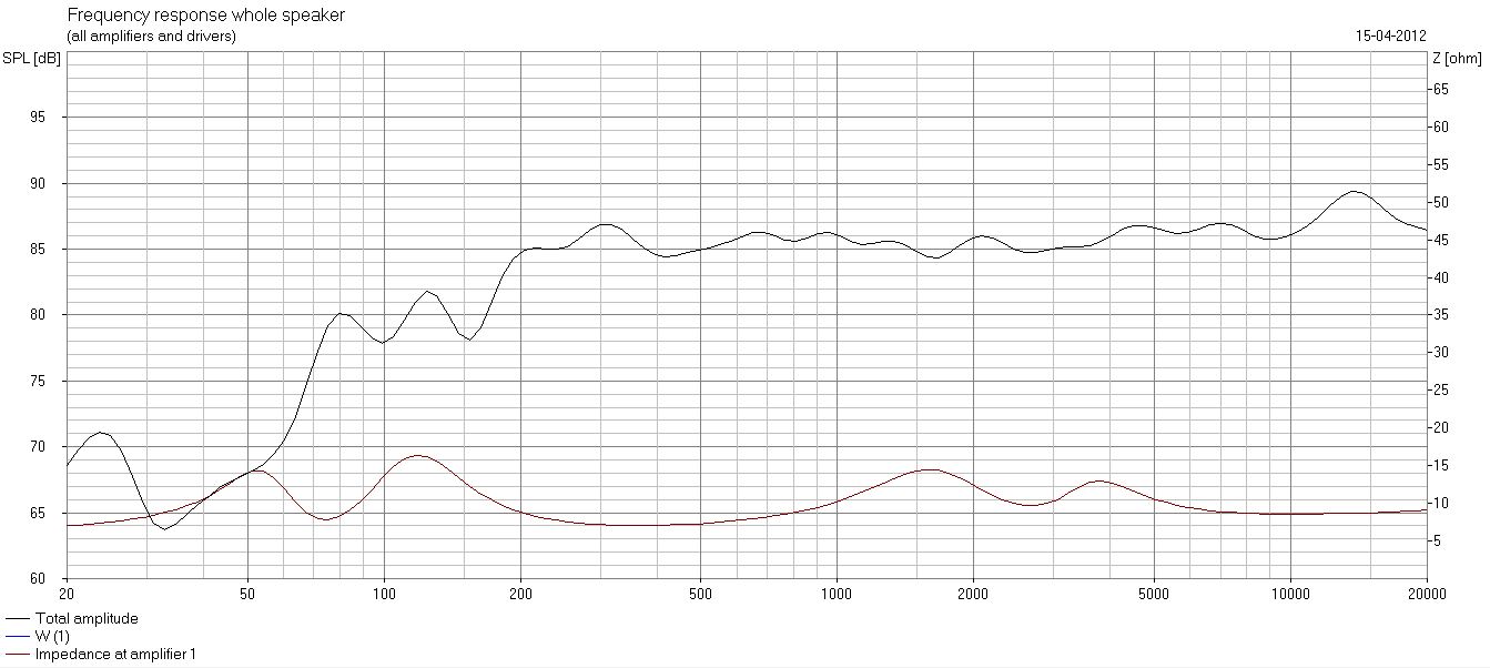

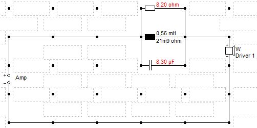

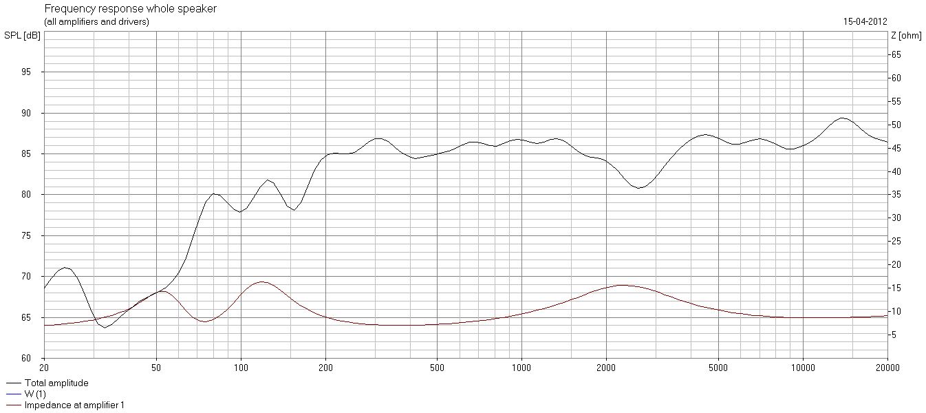

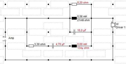

In regard to K3 filter, I would guess that it does not correspond to a series of two parallel notch filter, but parallel notch filter in parallel with a series notch filter. I tried this on my early version of FR89 box (now is a 2 way loudspeaker). I didn’t fully work this concept but the results were promising since I realised that with a single notch filter I would never get a fairly raising flat response.
Bellow I present the single notch filter I implemented with better results (to my ears).
Measured unfiltered FR89EX in the box
Single notch filter
Parallel notch filter in parallel with a series notch filter
As I previously said, I didn’t fully worked this last version.... so just keep the idea 😉

My unfiltered in box measurments differ from Cardoso's. Mine have a more pronounced rising response. I'm currently using Omnimic but I also have a calibrated Earthworks. I'm going to remeasure when I get a chance. I can hear this rise though (48 years old). I use a DEQ to help guide me when I develop crossovers, or in this case passive EQ so I can dial in what ever I want.
I guess I was thinking Fountek used a double notch on the K3 because thats what they used on the T5. So that's what I was trying. Cardoso's series/parallel didn't sim all to well with my measurments but we'll see when I remeasure. I'll have a listen to it either way. I've got the parts. I think I've listened to every circuit that's been posted here on diyaudio at this point.

Sounds like they need a parallel LR, not notches. Those are wide bandwidth notches that appear to deal with baffle step rather than response anomaly.
I would agree, though mine definitely don't seem to suffer from this rise, the highs are rather too dull than too bright. Maybe the variations in these drivers from specimen to specimen are pretty great, or we all use a very different enclosure. I know these little ones are very picky when it comes down to baffle size...
The measured response I posted above (unfiltered FR89EX without tweeter)

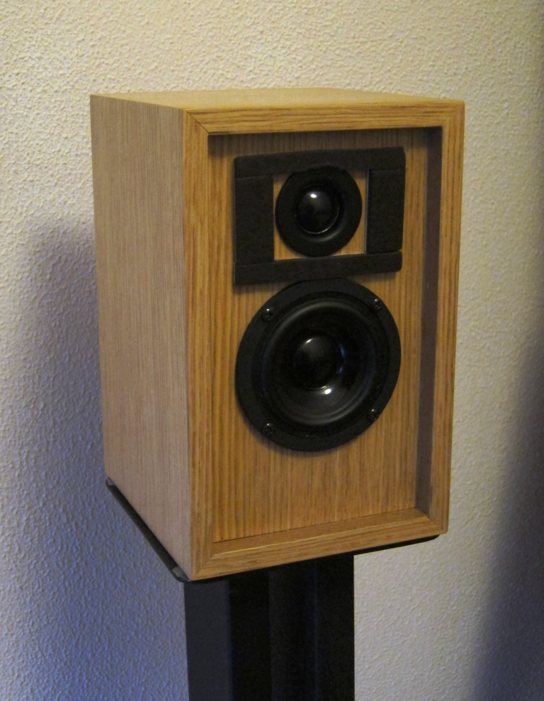

corresponds to this enclosure (22.2cm high x 14,4cm wide baffle).
The wide baffle compared to the driver diameter leads to the pronounced mids in the frequency response (definitely not a good baffle design 🙁 ).
I think that with a narrower baffle you will get better response. That’s what probably happens with v-bro’s and grymtr’s designs.

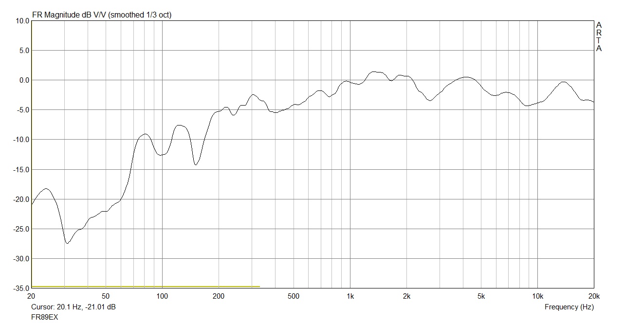

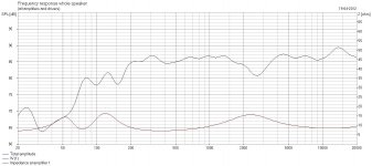

Here are the measurements I once did on a similar active speaker with SPH-30X from Monacor.
41Hz Audio - Megamini the active little beast
No filtering, no grille:

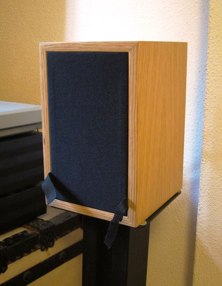

Then with the grille, still no filtering:
Then still with grille and a beta version filter:
Grille removed:
Then I made a different kind of grille, but nowadays I just use fan grilles for computers...

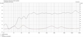

The filter I simulated in LT spice for the SPH-30X
And the final result:
They sound fairly good, but definitely are on the aggressive side still in the mid-high range, probably due to resonances in the cone.

Yes. I admit that LS3/5 was an inspiration to this design.

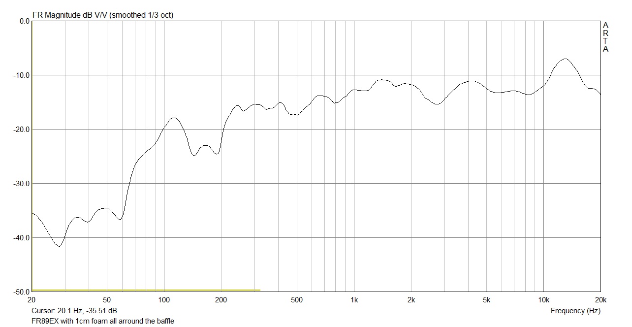

I did try a 1cm thick foam all around the tweeter and the fullrange but the differences was only minor. Actually I thought from the beginning that filling the front baffle with this foam would solve almost completely the bad baffle shape….. Wrong!
Frequency response with 1cm foam
As to the tweeter, I keep from the beginning the possibility of using a tweeter.. just in case. I’m still working on it…

Any way, considering all this problems with the baffle, I always felt that FR89EX was a very good fullrange with very soft and precise response…. but with a narrow well designed baffle.
