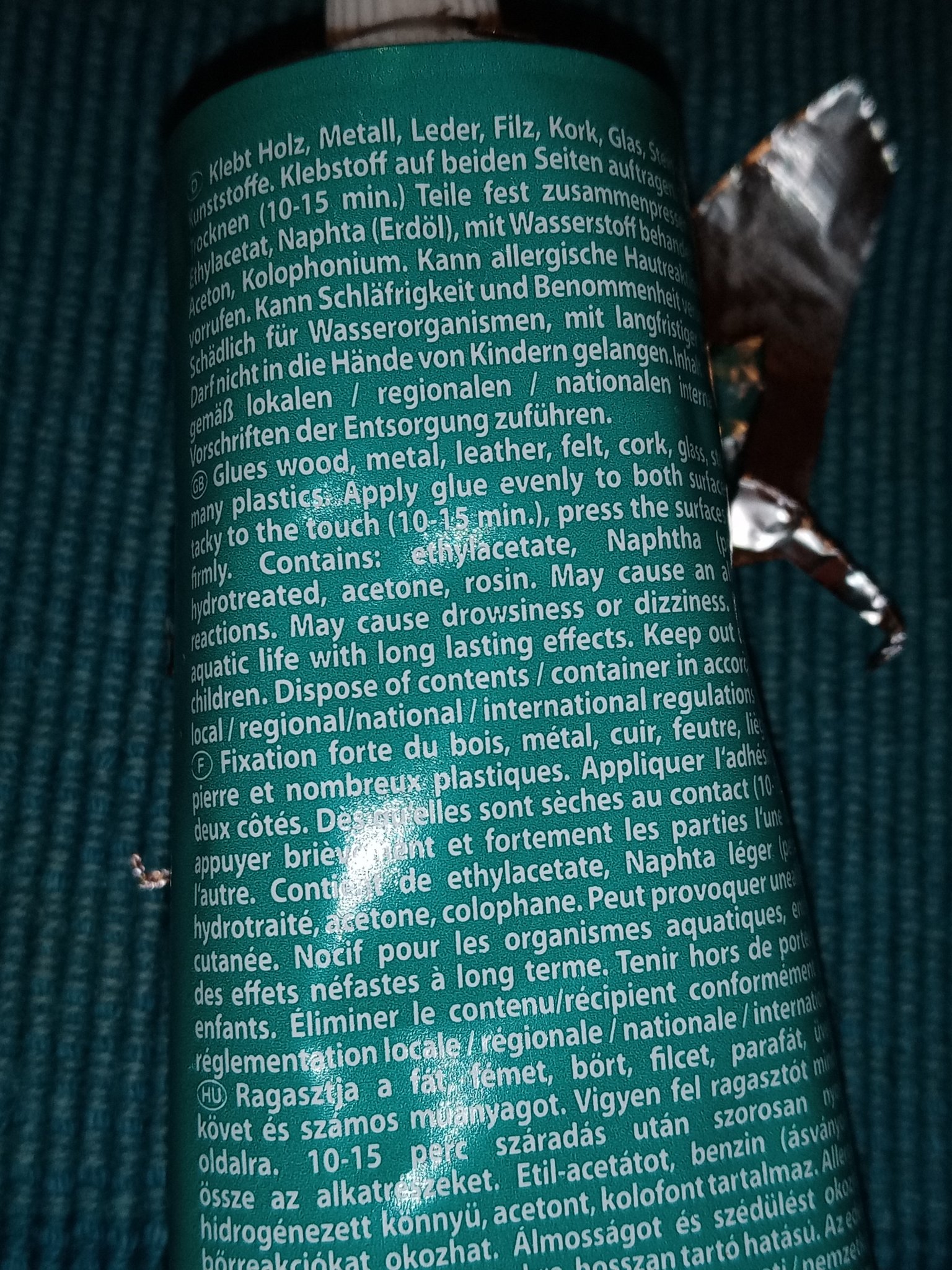

Glues wood, metal, leather, felt, cork, glass, stone and many plastics
Hm,but thats conntact glue. I use that one sometimes to glue wood veneer to metal,also to glue wood veneer to bigger wood surface without press.
Becuose you need to put glue on both side,wait,and then glue them together,without option for correting position,it look to me that is easyer to work with glue like e6000 where you have time and posibility to adjust folie to be in perfect position.
I wonder whetehr it is the glue or the foil or the combo that does the improvement? Have you tried any driver swith just glue?
It's a constrained layer damping panel scenario, so I view it that the glue sets how rigid/damped the coupling and the tin/gold foil sets its TL modes wave speed with the diaphragm reduced to theoretical pistonic action due to mass loading.
