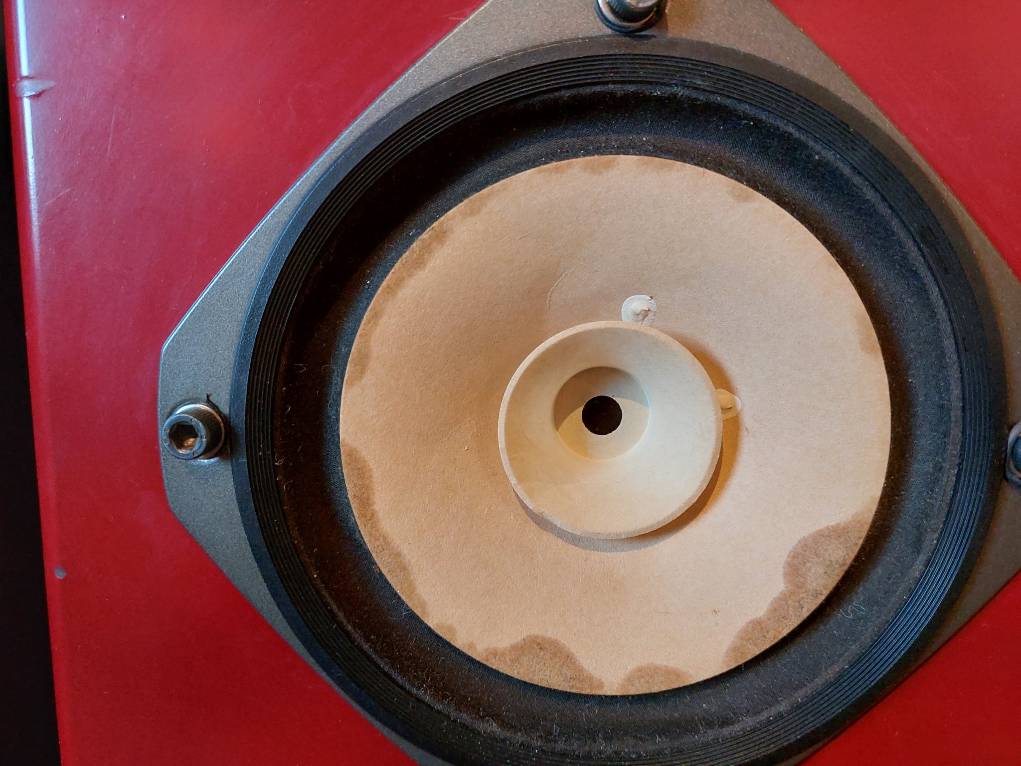

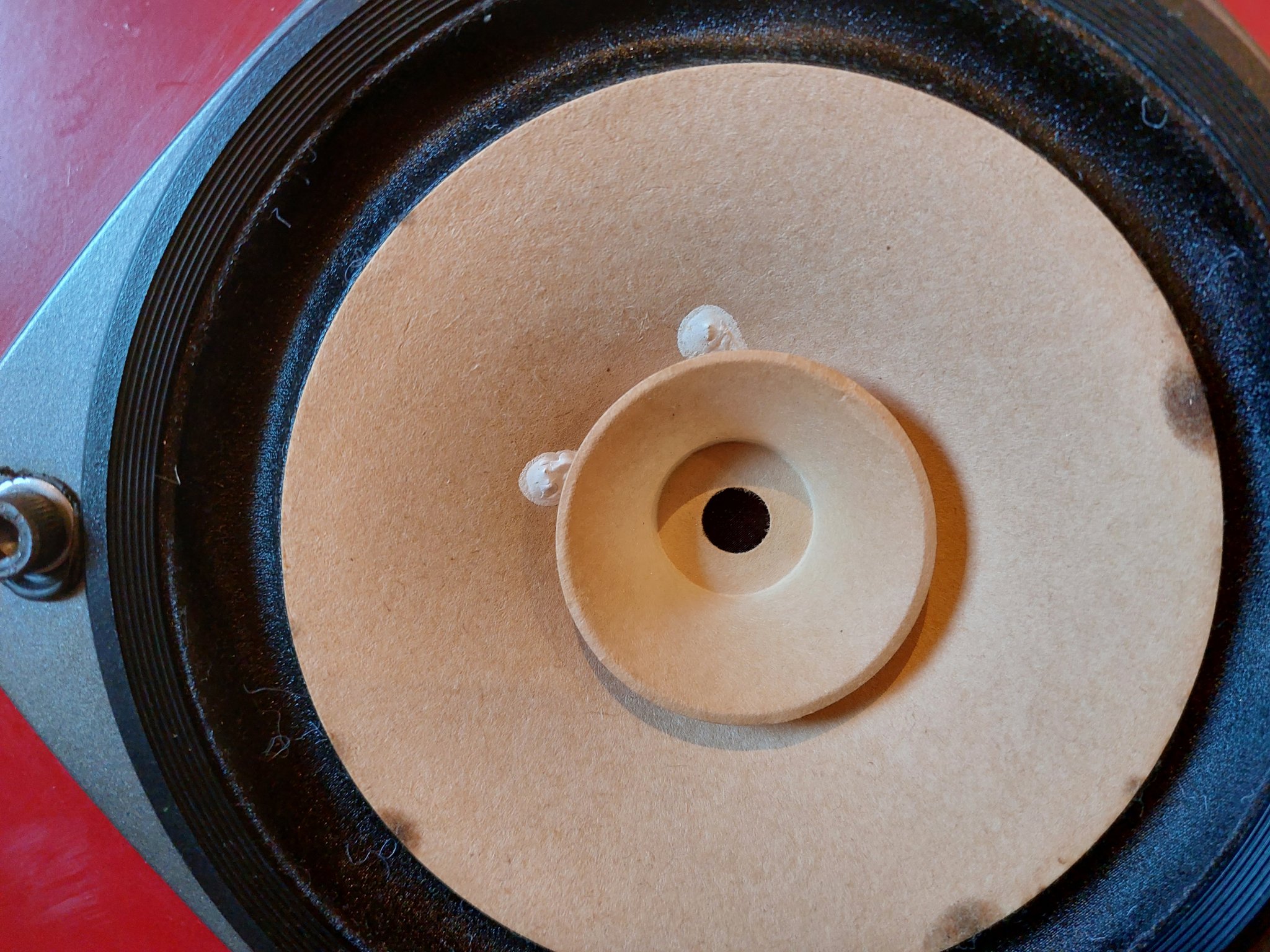

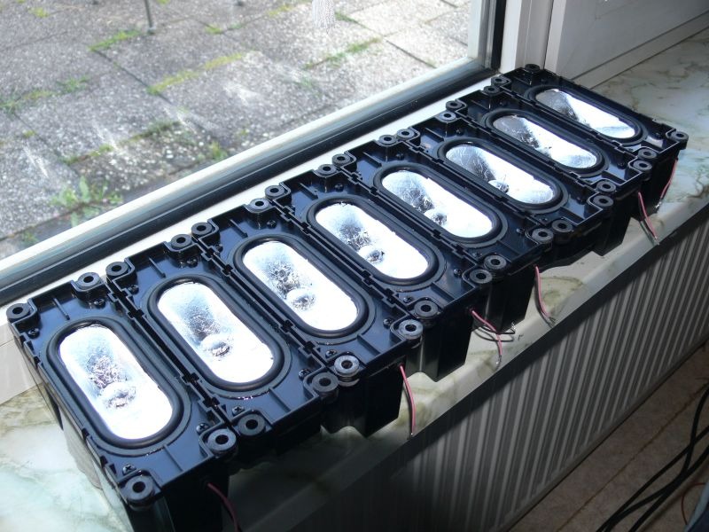

Help requested: how to repair a vintage driver whose paper-fold surround has one spot (just inside the folds) where fiber has been creased hence "broken"? White glue underneath to harden while cone propped up to flatten the crease? Or insert small piece of (what kind) paper backing? Thanks in advance.
I was kind of forced to buy this 6x10 Loewe/DEW alnico driver along with its mate which I needed. Picture didn't show much damage at all but it is unuseable as is.

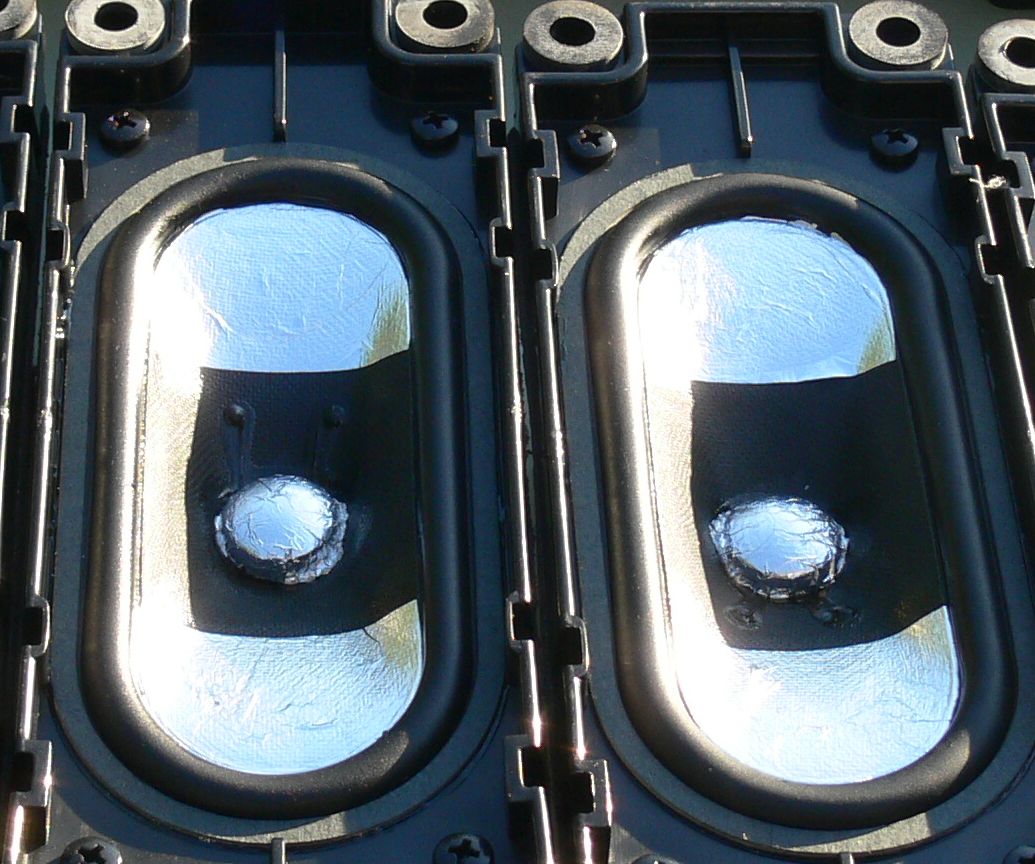

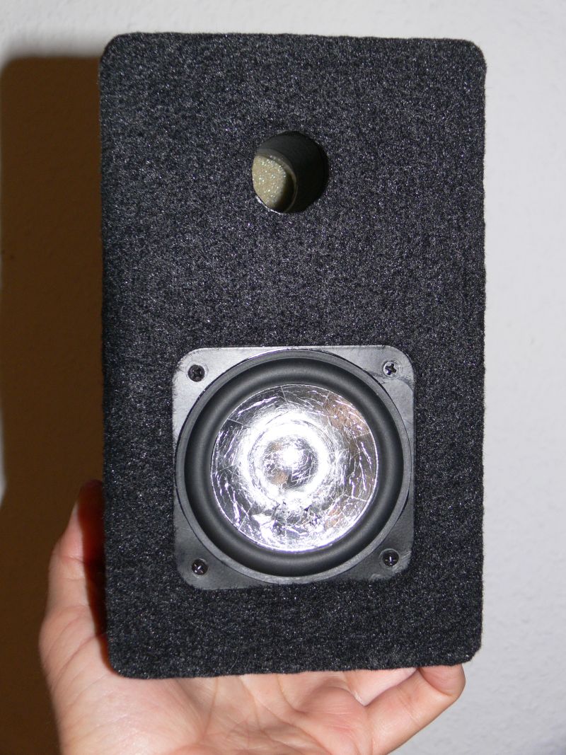

You can try self adhesive foil just report how long it lasts and stays in place.
Here you see use of very thin foil from the goldsmith in sandwich use.
Glue is nitro Zellulose also sold by the goldsmith.
Driver with double magnet and a paper box filled with sand damping resonances of the plastic basket of the driver
A small spot, think pinky nail size, will not hurt sound if other 99% of cone is fine (not the case in OP's Fostex where the whole co e is deeply creased).
Cones, like most paper, are made out of a paste of wood/cotton pulp, some adhesive and additives, and "wet paper" sort of becomes paste again, that´s why it´s so weak.
If the hole tear is very small, edges almost touching, a plain drop of wood glue will do.
If possible apply on both sides, in/out.
Now if edges can´t get within a mm ¿¿¿, make your own paste out of toilet/napkin paper and a drop of glue, use it to fill gap.
Press it between fingers so it´s thin so as to avoid adding excessive weight.
After drying, colour it similar to cone with some water based black felt pen.
That is kinda acceptable in a woofer, which is "dull" by definition, has a thick heavy cone, etc.
Now on a wide range thin flexible cone speaker, such as a full range one, it will murder frequency response.
Thanks for the suggestions. The broken-fiber crease just off the folded surround is very small but needs stiffening to play right. A small tear had been glued by the seller.... I will take pictures or attempt something after New Year's.
