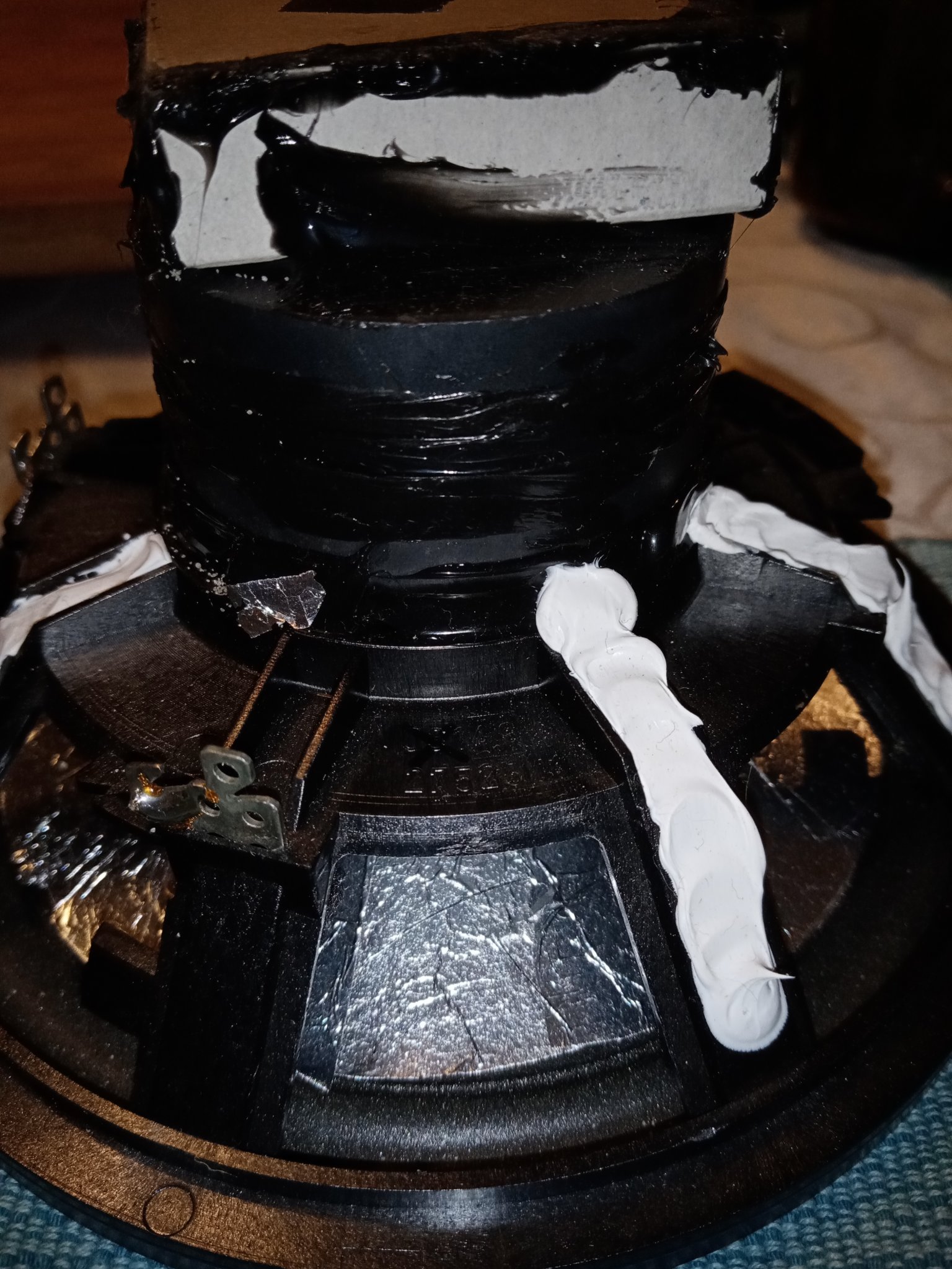

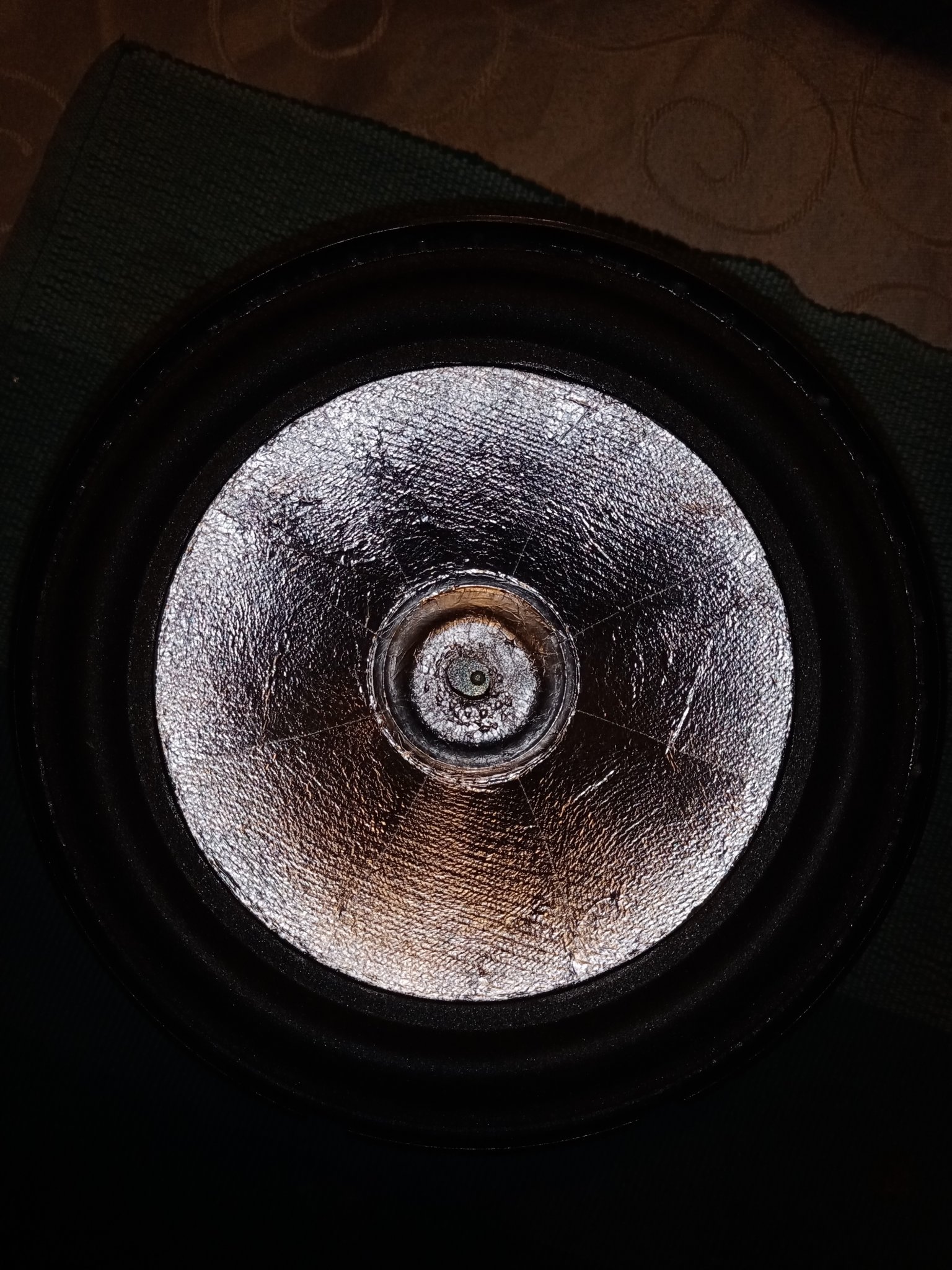

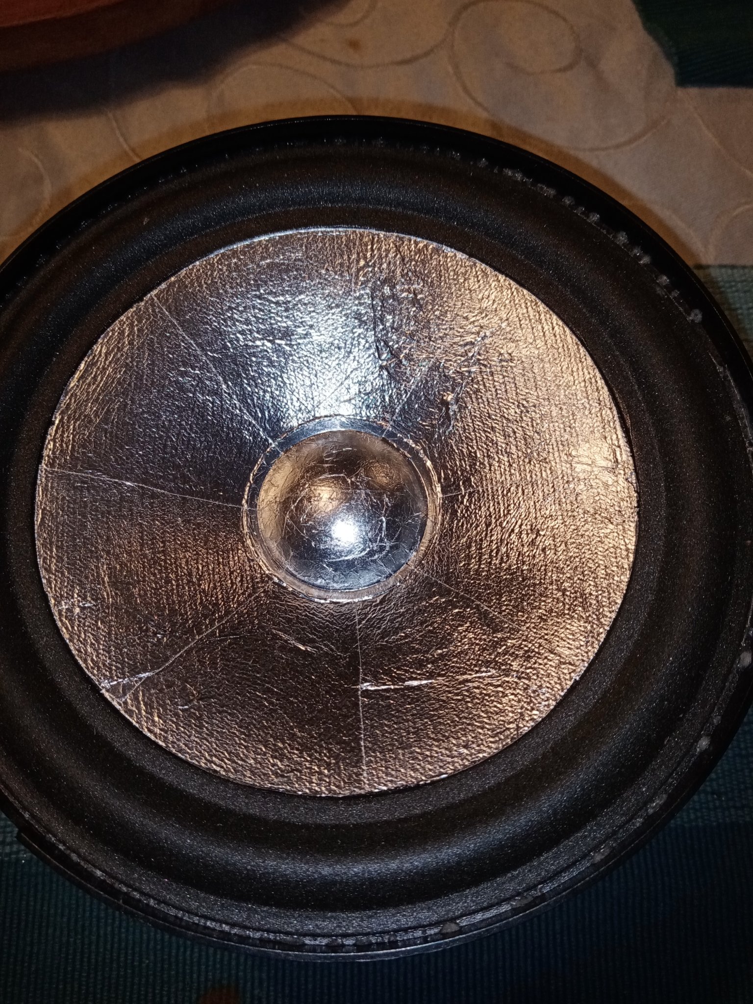

Here you see use of very thin foil from the goldsmith in sandwich use.
Glue is nitro Zellulose also sold by the goldsmith.

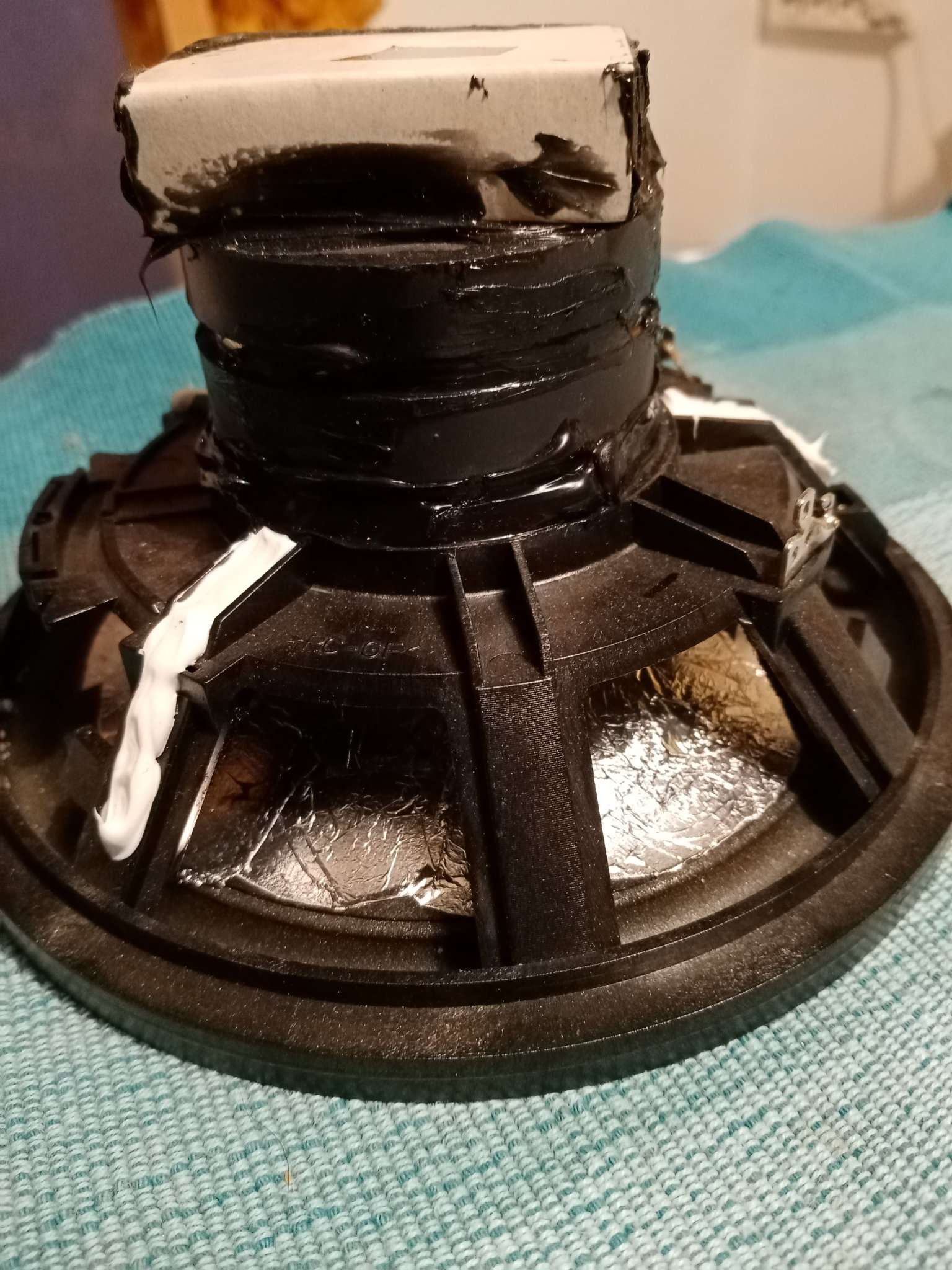

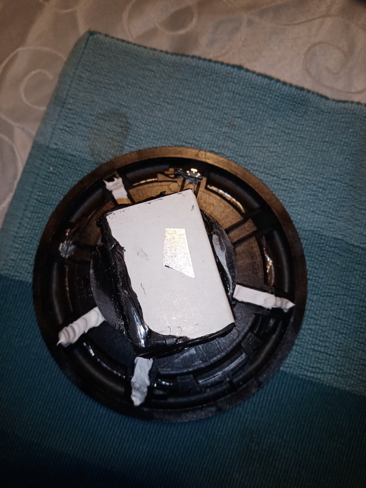

Driver with double magnet and a paper box filled with sand damping resonances of the plastic basket of the driver
Interesting. I'm surprised a plastic basket had significant issues with resonance in its structure; most have quite good self-damping. Still, plenty of exceptions to most things. 🙂
