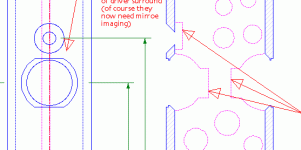

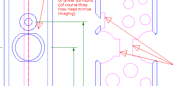

I'd do something a bit more dramatic....
The pic is a detail from a WR125 bipole box... note the cutout for the magnet -- that is meant to fit quite tightly to the magnet (an in this case couple it to the other WR125 -- you'd couple the FE166 to the back of your cab. Note that it is slightly off-centre
dave
dave
That's a cool approach for more than 1 reason, but I trust
Fostex enough not to worry about it. They seem to have their
maufacturing straight, and I haven't seen any alignment issues,
possible because they use a bigger gap than Lowther, where
more attention seems to be needed. (idle speculation, that - feel
free to jump in)

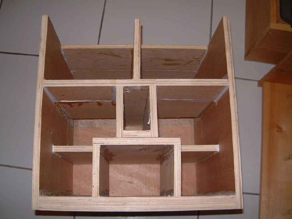

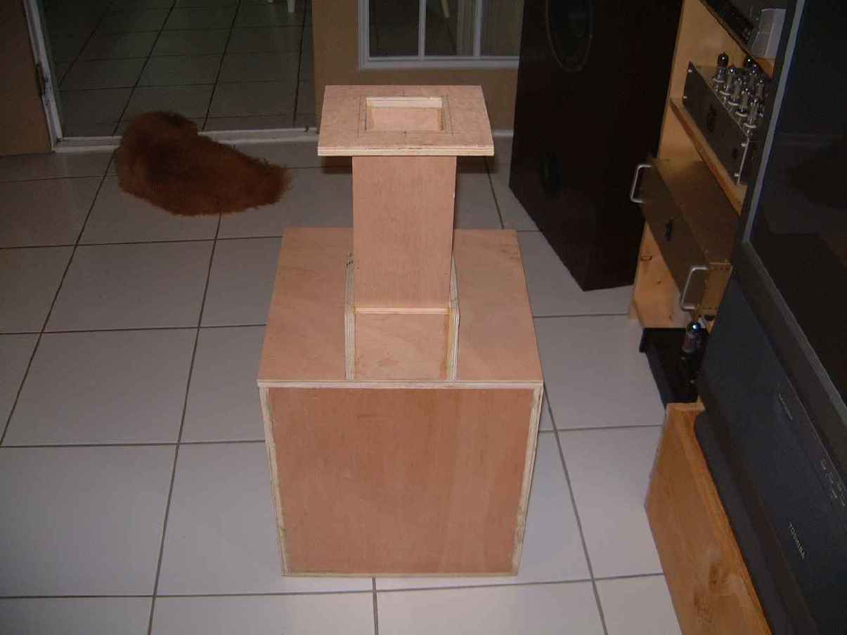

The top and neck are just placed on the body in the above pic and of course the head is not yet complete.
In this pic.
I need to get carpet felt / poly fill to place in the body at the end of the neck to kill the highs as they enter the body. I made a boo boo on piece # 9 I think it was, the second to last piece in the rear of the body, put it in upside down and had to correct that yesterday, took about 30 minutes but all is well.
I made the same mistake when I built my 101a Swans but caught the error before I glued that time and was looking out for it this time and still messed it up.
I use liquid nails adhesive with horns so I know the internals are sealed.
Circular saw and sawboard and practice gets me to within a fraction of a millimetre on 95% of the cuts, the other 5 % are usually about a mil over so I sand those. I used yellow glue for the patch in #9 and then silicone on top of that and anywhere else where I did not see the liquid nails squeezing out to my satisfaction.
I cut all the pieces for one speaker last week Saturday and have been assembling
during this week. I have other things to do like work (and two exams to sit and pass by the 20th) which get in the way of finishing my projects.
The sound path is (from the bottom of the pic with the doubled wood) down the neck (from the pic above) and into the centre front where it is divded into two equal paths at the bottom on each side, right and left, over the top of the second piece and then down the bottom of the third piece and then back up and exits at the top of the rear. When the top piece with the neck goes on then the back of the top piece forms the top of the exit.
The carpet felt / polyfill is used along the bottom of the speaker below the neck entrance along the full width of the speaker.
The smaller rectanglar opening behind the neck entrance is usually filled with sand or stones etc.
Depending on your room / likes / dislikes you can also add more polyfill at the rear exit of the horn. I have not measured how long the horn path is but you would be surprised at how long it gets, I guesstimate this one to be 5+ feet.
Andrew
