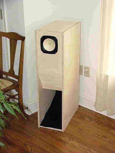

yep, you got the picture up, but it is very large & very pixelated... i took the liberty of tweaking it into a smaller, clearer (that last is actually just an illusion) picture.
What process did you use to make the jpg?

planet10 said:yep, you got the picture up, but it is very large & very pixelated... i took the liberty of tweaking it into a smaller, clearer (that last is actually just an illusion) picture.
dave
I shot it using a Fuji digital camera, reduced the size of the image using an HP photo-management program and saved the reduced image to my desktop. I posted the image from the desktop. The image should be 57KB.

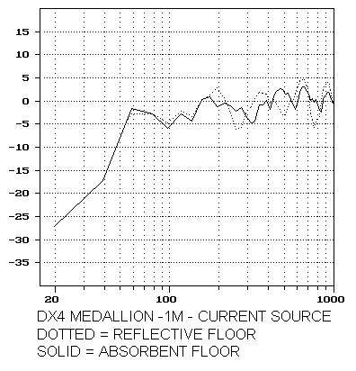

greenie512 said:Nelson's comment re floor reflection worries me. I have floating timber laminated floor on a concrete base, with with only one small rug in the room. Will this "hard" surface cause acousic problems with the BLH
This is not my best example, but here's a DX4 in Lowther's
Medallion with and without an absorbent floor space between
the speaker and microphone. You can see the "comb effect"
from floor reflection pretty easily at 250 Hz spacing.
I say that this is not my best example because the placement
of the Medallion mouth and its tuning are such that the
inteference pattern occurs at about 250 Hz and is fairly minimal,
where usually it's around 150-200 Hz and the first dip is bigger.
