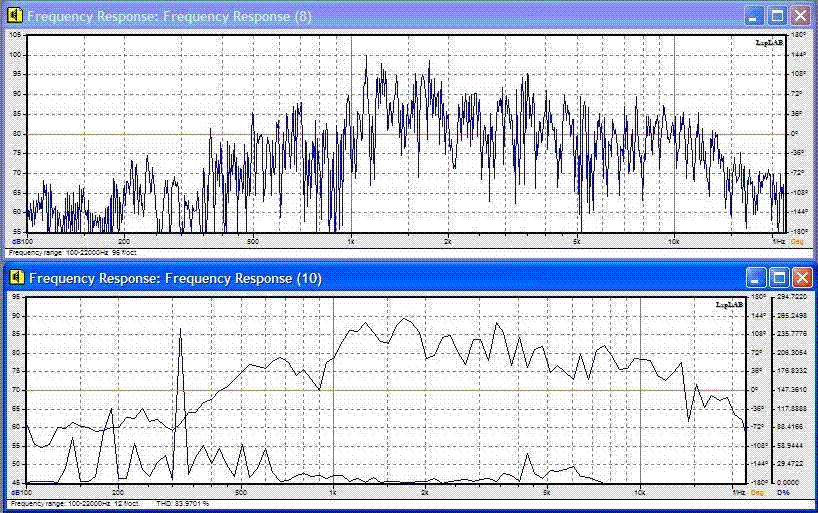

These are the freq. response graphs I've been getting (usable from 1.3kHz): The Top graph is a freq. sweep method and is more accurate (with no smoothing), The bottom is a gated freq. sweep which is less accurate. Note that my test equip is so poor that distortion measurements on the gated response are essentially worthless (and as a result are worthless for a CSD).
