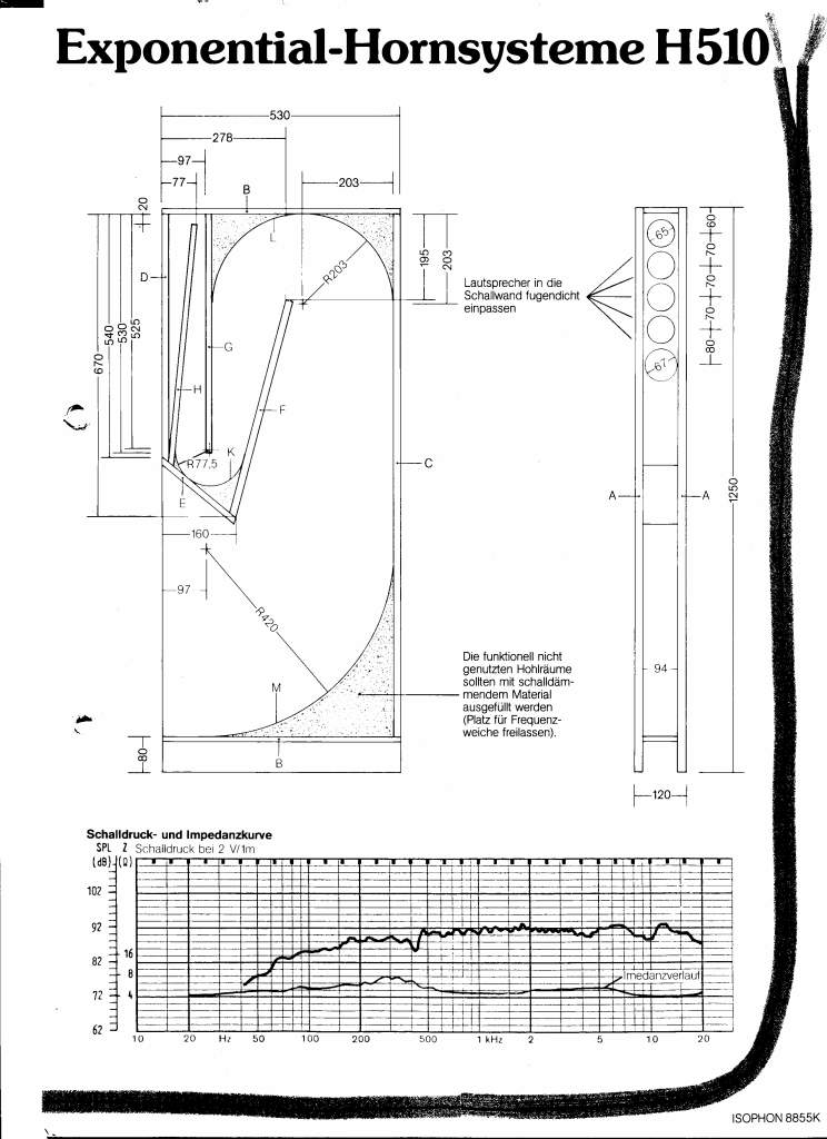

Hi!
I would like to ask some theoretical question about the factory recommended enclosure of the FE166 ES-R?
-What kind of horn is this? Expo?
-What is the correct line lenght of the horn? ca 245cm?
-What frequency is it "tuned"?
And the last, but most important:
--Is it possible to build 2 drivers in one factory recommended enclosure of the FE166 ES-R? Is there any theory about it? What would need to modify?
Greets:
Tyimo

Hi!
Answering to my last question:
-yes, it is possible to use 2 or more driver in one BLH enclosure! For example: Isophon H510 🙂)
Tyimo

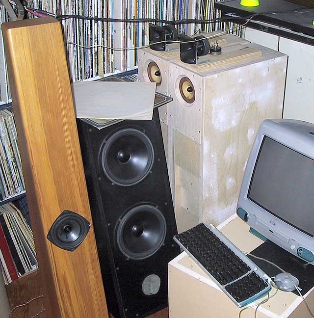

mine
well, i have been waiting a while before i posted about my speakers. I have some experimental enclosures. double horns (8foot eachpipe, efectively doubling the total horn length to 16 feet. and sure enough, close to the lowest pitch these produce is that of a 16 foot organ pipe, and man, is that low!) they are made of maple. for a while there i had no damping whatsoever in the cabinets and the sound was surprisingly passable and danceable. to my ears, maple coloring tend to be somewhat eauphonic overall, so there was little problems with this. i have now finally stuffed some stuffing into the exantion chamber and the sound has thoroughly improved. the highs (13k up) are a little soft on these, especially off axis, but everything else is 100 per cent coherent. i have bass like i heard in the fostex room at ces without the tungsten, and all of my music sounds great. I feel that it will be a realistic goal to get these sounding in extremely similar overall character to my sennheiser hd 650s. these things have headphone bass. and though they are more bright than the headphones, i find it to be quite a pleasing attribute. needless to say, i am going to be doing extensive tuning and tweaking to the speaker as a whole, but very slowly, as i consider this driver/horn combo to have the potential to be nearly unbeatable in all attributes as a musical instrument. right now the room i am in is far less than ideal for these horns, as the lowest frequency of these speakers cannot be produced because my room is physically not large or reflective enough.
in either case, i feel extremely lucky to have them, and to be able to play with them. to me, and though i am just a newbie, these things are very very special indeed. they sound space age to my ears. probably the most impressive attribute is simply effortless musical dynamics in all frequencies (except the highest of the highs, where the imaging suffers a tad). also, inner detail is totally there. i compared these to the sennheiser hd 650s, but honestly, i think that in overall presentation (except absolute detail) they are more akin to the orpheus headphones (pleasing brightness). i would heavily suggest that folks really try to get the damping amount and placement right, i have found my set to be very very sensitive to this.
question: when placing damping on the driver chassis, it it logical to place it on the inside of the metal peices connecting the surround to the magnet? and also, i think i can hear certain sounds reflected by the magnet, but i am not sure. should this be dampened too and if so in what fashion. thanks.
look forward to discusing this with all of you.
Clark
Clark
Clark photos please
Ditto on the photos Clark.
So are your cabinets basically the Fostex recommended enclosure doubled up? How did you handle the expansion chamber (dimension-wise)? Come on, share, fess up.

Clarks cabinets are a modified version of my double horn built to accomodate this driver.
TC
http://fullrangedriver.com/show_image.php?id=211
TC
pictures
I don't have a digital camera, and i was trying to wait until i could get them into a proper room (i am moving in a month, yay!) to post audio reviews. The picture TC posted is pretty indicative of the way they look now. I think that another coat or two of finish was put on so they are shinier. I must say, i was a tad skeptical as to whether or not the bass would work out with these enclosures, them not being the reccomended enclosures. I have not heard the reccomended enclosures, but i guess i reccomend these! I must concur with previous debate - do not use MDF for the cabinets. high quality plywood is what is called for by fostex in specific and the whole theory behind the BLH. the difference is not subtle. even then, these things are worth having a few different cabinets in various styles just for different styles of music. (i think maybe maple for string instruments and pine for piano?), but i am just being playful. you could say that about alot of drivers. i think the main thing contributing to the spectacularness of the bass and life of the music in these is the stiffness of the maple in these cabinets. after all, string instruments are maple except the soundboard. course, I think that analogy might have limited application to this specific acoustical context, and the tons of symphonies that i listen to for class. granted, it will take many more hundreds of hours of listening and then experimenting with damping of all various kinds to get them just right. the cool thing about it is that these are so worthy of the time spent on tweaking. i have been so surprised with what a difference just a tad extra or less or different kinds of damping, and not to mention amplifiers. i found my favorite solid state so far has been a sugden headmaster (which is for sale by the way) preamping a sonic impact tripath, 5.5 watts into these things will rock a rave party. but usually i use a bottlehead sex amp (which does alot better than it has any right to). I would imagine that these would benifit from paramour monoblocks coming from a foreplay. there is an endless need for tweaking without spending lots of money. heaven.
I am not sure whether or not any more cabinets can be built of this specific model. however, if patience were to prevail, I am sure something will materialize eventually.
I guess again, the most surprising thing to me about this whole project was how dirt cheap the driver was. i mean 120 bucks for this!! i want my 25 cent deusenburg! i mean it is an exxageration, but still. i am constantly surprised about how well these (and fostex drivers in general) compete with some of the craziest of the crazy designs. maybe compete is not the right word though. they are simply a valuable and valid music producing entity in and of themselves. in a way, they don't have to compete.
again, though, anyone saavy on the magnet damping, please give me some guidance. if i glue anything it is a little irreversible. I have this material called deflex that i got from madisound, and it is kindof thin, dense, black, and rubbery. would that work?
