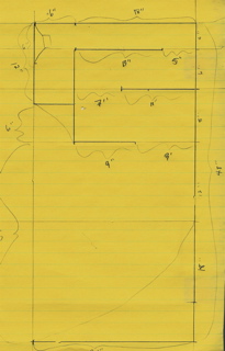

166ES-R cabinet ?
Am I alone in not being able to get excited about the Fostex recommended cabinet for the 166ES-R?
It's primarily the width of the front baffle that turns me off (although I'd also prefer a shallower cabinet).
I am trying to attach a sketch of an idea for a cabinet. Since I'm a newbie to horns, please tell me where I am crazy here. This cabinet would have an internal width of 6", thereby pretty much maintaining the Fostex recommended enclosure throat cross-sectional areas.
Even though I have little idea about what I am doing regarding horn design, something about this sketch does not look "right" to me. The sound path seems to be opening up into the "mouth" too soon. I'd also prefer a shallower cabinet, but I worry/wonder about the horizontal "wave guide" overlap. Is there some minimum "overlap" I should be maintaining?
Any help, advice, etc. will be greatly appreciated.
Sincerely,
Brad

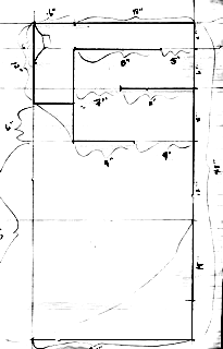

Sincerely,
Brad

Hey Robert,
I'm still pretty new to horns myself, but I don't think "areas" add - just dBs.
The mouth determines the cut-off freq for the sound coming out of that horn. You could put 2, or more side by side and each would still have a cut-off freq dictated by the area of the mouth at the end of that horn.
As long as the sound waves were in phase (from the different horns), the amplitudes would add - but this would not effect the cut-off freqs of each separate horn.

Hi Brad,
I think it depends, if the mouth areas are next to each other for two identical horns then I think the cut-off frequency changes. The cut-off frequency is detemined by the acoustic impedance of the mouth which is generated by summing the pressure contributions from a large collection of simple sources spread over the mouth area. Two mouths beside each other will "see" the neighbor and this will change the acousitic impedance. The size, shape, and any reflective surfaces near the mouth are important when calculating the acoustic impedance and cut-off frequency.
