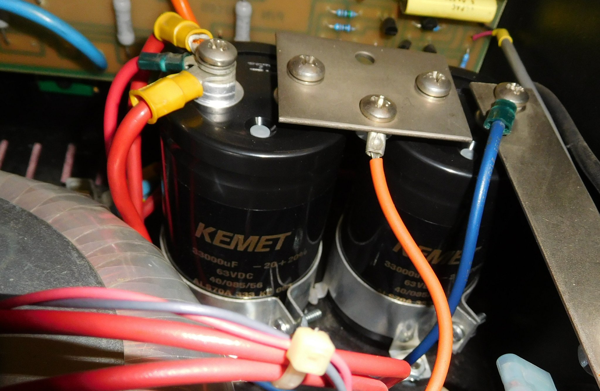

Good point. I have to agree with caution about a big increase in capacitance. If the originals had a +75% tolerance, for example, that would be greater than the 33,000uF of the new caps, but those may have a + 20% tolerance which would be 40,000uF per cap which could be problematic.
I went up only 4,000uF per cap on mine for the same concerns.
Oh, I didn't think about that. I'll have to check Mouser and others again, but I'm quite sure that with the right dimensions, I could only find caps with 22.000 and 33.000 microfarads. Do you think 22.000 would be a safer option, or would going down 8.000 microfarads be too much? I don't want to change the dimensions much because of the metal parts and amount of work.Adding 40,000uF of extra capacitance (especially if you choose the more expensive caps with only 10mOhms of ESR, which is exactly half of the cheaper ones - hence why the 20mOhm ESR version is much cheaper, by the way...) would put a lot of stress on the transformer, mains switch and bridge rectifiers.
The sound will change for sure... you may like it, but you may not... try and see. A lot will depend on the rest of your system and your personal listening preferences.
Large capacitance usually slows the sound... the ESR can jump substantially at higher frequencies, especially as the capacitance is increased.
@GKTAUDIO You mention going up only 4.000, but I'm pretty sure I read you saying you used 33.000 microfarads Kemet caps. Am I wrong?
@dastinger - dang, you are correct. I have worked on too many amps now, and haven't had the Forte open in several years, so was mistaking the cap selection for another amp I recently worked on.
I normally don't bump up capacitance that much, but as I seem to recall, choices were not vast, and the original caps had a high % tolerance, so yes - I am running 33,000uF in my Forte. No problems with power-on surge. I changed rectifiers to new 35A ones. My caps are Kemets. Sorry for the confusion - doing too many things at once these days.
@GKTAUDIO no problem, I totally understand, thank you for clarifying.

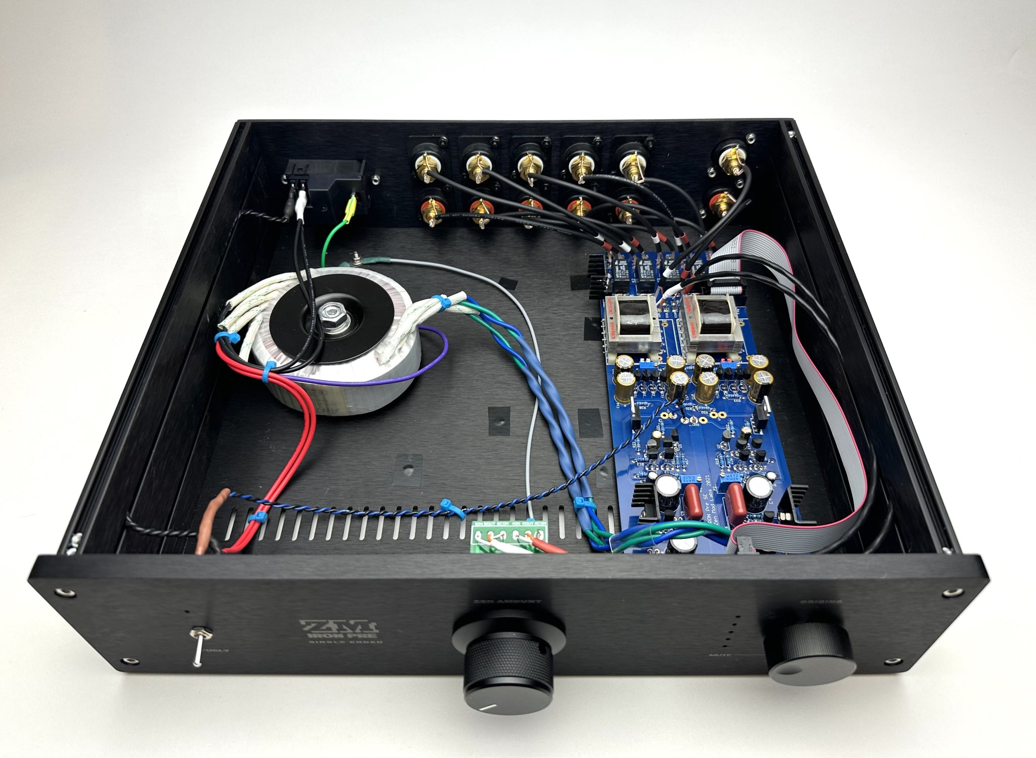

@lxnay thanks for the note. I remember chatting back and forth over email with PaPa about the B1K kit as he was finishing it up, I had been sharing my usage of 6SN7 tube preamps with Pass amps, and now with my Forte amp. Its a nice combo. Sometimes I want to remove all of the tube gear out of the system, and play all SS. This time I'll either buy an old vintage preamp and have a buddy help me mod it, he use to work for Threshold. Or, even thought to try the new Schiit Kara preamp, looks good on paper yet I don't know if it lacks real finesse.
If you guys come up with a magical match preamp (vintage or new) that mates up with with Forte' amps, under $1k, i'm interested to learn more. I just passed on a Forte F44, I actually want something super simple, good volume control, 2 inputs, 2 outputs, no frills. That's it.
Yes sir, I should have mentioned the other ground breaking preamp that just didn't make sense to me when I first heard. What the Hell is that? I wondered if I was just hearing a proud papa moment. Ok, so here goes: I built the Iron pre because I had never really worked with a build that used audio transformers but I have had a great impression from Cenemag products. Connecting the iron pre to my re-engineered Forte' was certainly a rare experience for me. Cleaner sounding than the B1K, but better balanced as well to my ears. Not a difficult build and in your price range as well. Note that I haven't yet completed the build, so that means that i was just using the volume control that I had handy which is a regular Alps RK27? or something. The RCA jacks were barely acceptable, if not slightly loose. And so, in spite of a couple of less than perfect components, this unit projected a deep and open soundstage. Just the right amount of bass. When you sit down and just keep listening, you know that you have something special. Psst, I added an extra output to mine, and dropped one of the inputs. You can pick your own flavor.
@Ixnay, re: "other ground breaking preamp".

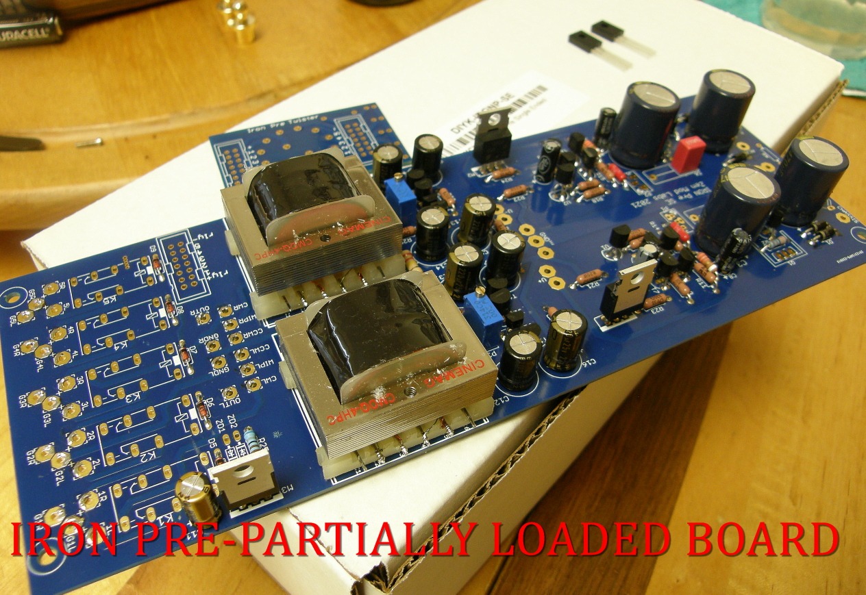

Spot on. I'll check out more this weekend. ASK: if it's not too much to ask, can you share the links on where to order the same case, kit, transformers or however you pieced it together. This very clean simpleton looking unit is what I'm looking for if I can configure with exact inputs/output RCAs needed. Seeing the 3 x-formers inside, even better. Wanna check this out. Thanks!
I am a simple man. I do not have links, but there is an entire thread devoted to the Iron Pre. That is the good news. Not so good news, I don't think that the circuit board is in stock right now. But if you will take the time to visit the thread on this forum you will be inspired to find a way. And who knows? There could be one come up for sale. If it doesn't have two outputs , no big deal, you can add another drilled right into the chassis. Same with volume control. You want a different one than what comes with a unit replace it yourself. If it comes to pass, you will not regret it.

Then the Iron Pre is probably a good bet. I believe part of the design was to have the preamp not impart it's own signature into the sound of the system.. Also, the cinemags in the circuit are pretty sweet.Sometimes I want to remove all of the tube gear out of the system, and play all SS.
There are a few other solid-state designs that are nice. The BA3, the BA2018 are two off of the top of my head. I have built both and they are nice.
Rather than shooting for a different threshold amp, maybe you should try your hand at building something. The new F5M is incredibly simple and very good for a beginner build for someone who is comfortable working with mains. It should be in the stores soon!!
