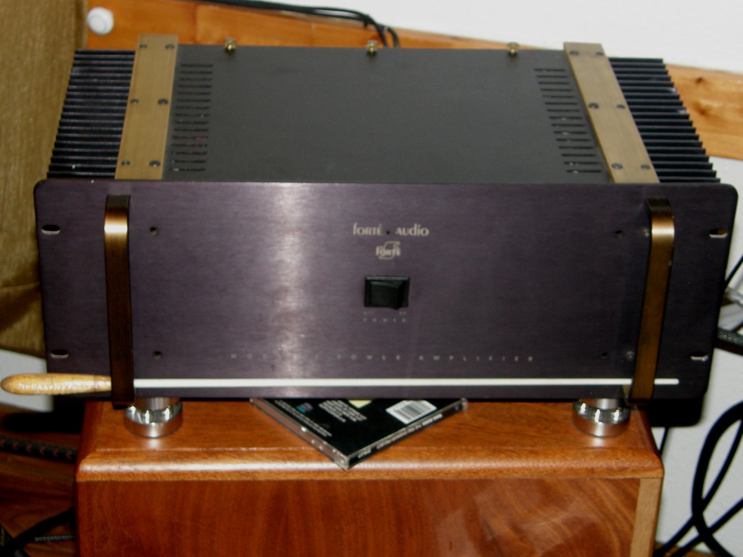

Hey guys,
OP here. I asked a tech to fix the Forté and it has been running well since!
I have a new issue though and it's a lot like what happened to another user here in another thread—the left channel has slight distortion on certain frequencies, like a buzz. A small tap on the left side of the amp often fixes it so I'm guessing it's probably a cold joint so I'll be resoldering everything in the next few days.
While I'm at it, I thought I could check the main caps and possibly replace them since this is an almost 40-year-old unit.
Questions:
  • Besides not touching the pins unless I want to get fried, is there any other stuff I need to watch out for?
  • Do I need to rebias the unit afterwards? Is it okay to not touch the bias pots before replacing them and see how it behaves afterwards or should I lower the bias before installing the new caps?
  • Is there some kind of benefit in going higher in capacitance, assuming higher capacitance caps fit?
Kind of hard to say what you are dealing with until you get in there. I will tell you this. Those integrated circuits on the board were what started me on my journey with this amp. probably not a bad idea to replace them. Using larger capacitors doesn't seem to benefit anything in my experience either, although changing out caps in general is a good idea. Don't know about setting bias to lower point before replacement. Doesn't seem necc to me. You will be setting bias afterward anyway, so unless something was WAY off, I don't see the need. FWIW, my unit was completely redesigned for the rebuild, now sporting 40WPC and some rethinking of the original circuitry. Truth is, I like the original Forte' 3 design as is. If yours is in class AB, I would go so far as to say that it sounds best in this state and less so in class A. Having said that, many out there would disagree with me. I found the class AB to be more open.
Reactions: dastinger
Answers:
You need to discharge the caps with a resistor and leads - 100R is sufficient to pull down the voltage quickly without causing arcing. Make sure your resistor/lead assembly is insulated so you don't touch any exposed metal. Connect the common ground bar to the opposite terminal on each cap for a good 30 seconds, then measure voltage with your DMM. Don't start working until voltage is zero or less than a volt. There aren't any electrolytics on the boards to discharge, as far as I recall.
You should not need to re-bias unless the caps were so bad you were not getting full rail voltages (unlikely or the tech would have found this, most likely). However, do re-check bias, as it could have drifted since servicing, and re-check after using the amp for a few hours after re-capping.
In my experience, it is sometimes not advised to increase capacitance of the main filter caps, because it increases start-up surge, and in some cases can stress downstream components. However, I have increased the capacitance by about 50% in my unit, and have no issues with start-up or operation. I did replace the old rectifier bridges with new 35A pieces. New caps are generally smaller, so going to higher C is generally not a problem, and there is plenty of vertical space in this unit, but don't go larger in diameter - keep it the same or you may have to make a new common ground bar.
Reactions: Ixnay and dastinger
I agree with Ixnay's statement about keeping it as-is, and preferring the AB class of operation to A in this case.
One note about main filter caps - a lot of older caps had a wide tolerance range - say, -10% to +75%. That means a 10,000uF cap could measure 17,500uF in the extreme. My experience with this unit and a few others is that going with +-20% caps at say, 20-50% increased C is not problematic, and can help with "stiffness" of the rails.
I apologize but it has been a few years. I do know that it was decided to use a different IC than the original, but I do not remember the replacement IC in particular. FWIW, in my case the chip had gone bad and produced loud 'smacks' of sound unexpectantly. It would lift me right out of my chair and over to the amp to shut things down. I didn't know for some time what the trouble was until I asked an engineer friend of mine about it all. If you go this route an IC socket is advisable.
I increased that power caps with those from a Nakamichi PA5 IIRC. Not a great idea. They were much larger physically, and I had to 'expand' the chassis and rearrange things make it work. The diode bridge had to be increased as ell to accommodate the greater capacitance. You can see in this photo that the chassis has been widened by the use of thick brass extenders that worked and looked quite good.
